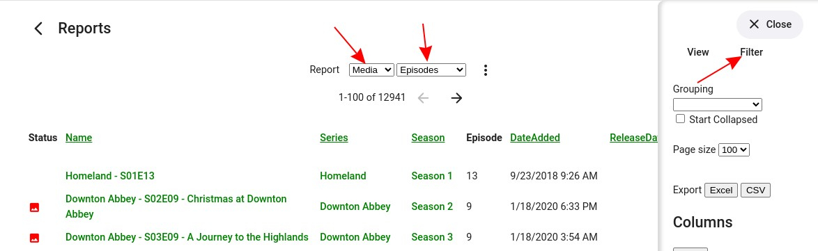

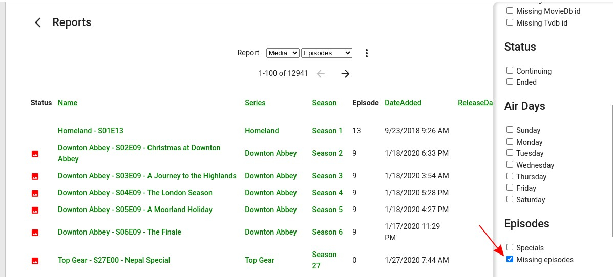

brandon6976 2 Posted February 7, 2024 Posted February 7, 2024 Hello, just yesterday I upgraded to 4.8.0.80, everything overall seems fine. However I often go to reports, go to media/episodes, and then filter and choose missing episodes. This would cut the list down to only the missing TV episodes. Now the checkbox does nothing and I can't see if there are missing episodes.
pwhodges 2039 Posted February 7, 2024 Posted February 7, 2024 Missing episodes are no longer shown in sequence. There is now a new entry at the bottom of the three-dot menu for a series or a season which will generate a list of missing episodes. As I recall, it has been moved for performance reasons - doing the search only when requested saves time elsewhere. Paul
