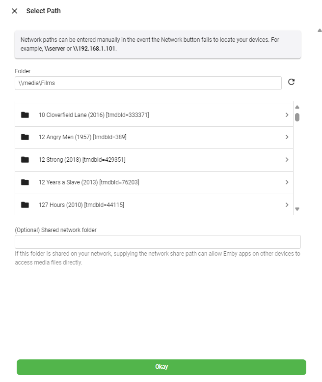

rbjtech 5345 Posted February 8, 2024 Posted February 8, 2024 10 hours ago, Luke said: Hi, what dropdown section do you mean? Here @Luke- If it's not listing the folders in the above (after I click refresh), then my assumption is it simply cannot read them due to permissions ?
Luke 42287 Posted February 8, 2024 Posted February 8, 2024 Yes that is correct. @e27what exactly is missing from this dropdown? Can you show screenshot examples? Thanks.

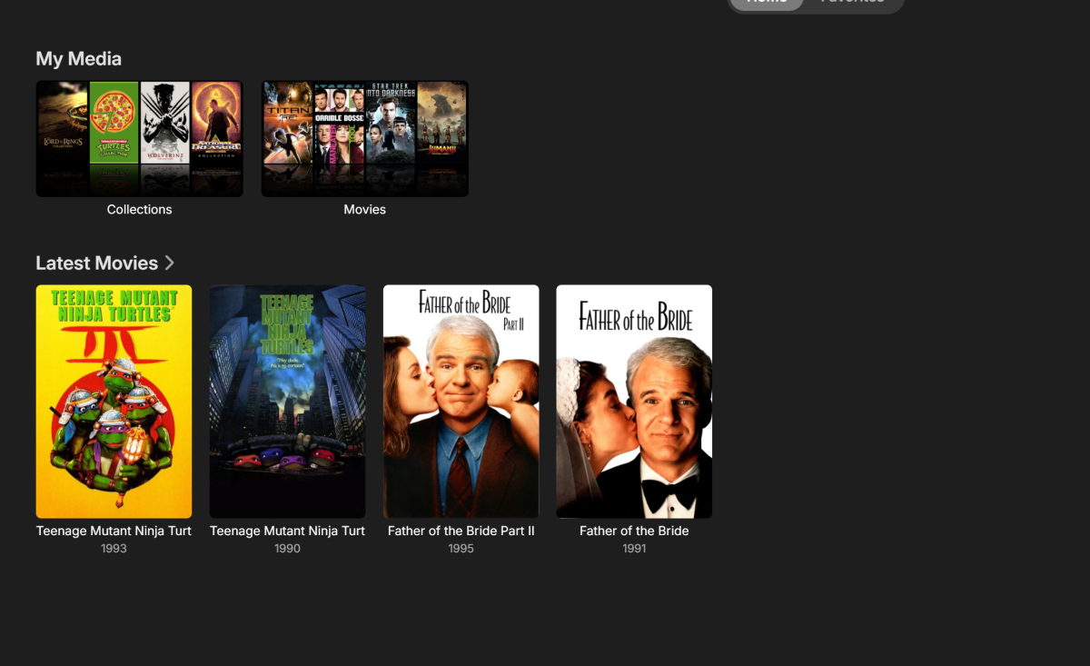

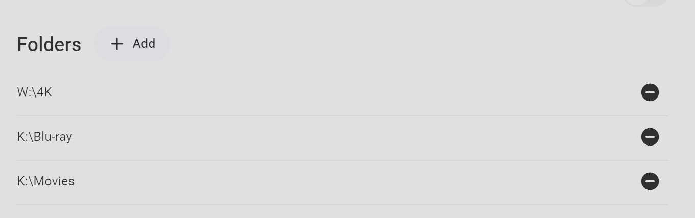

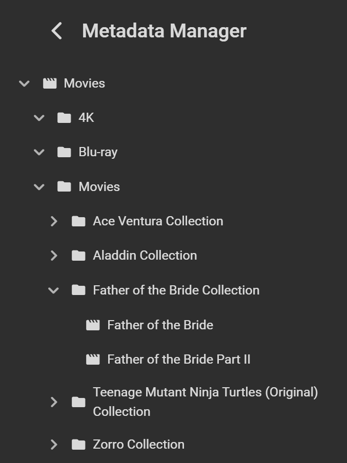

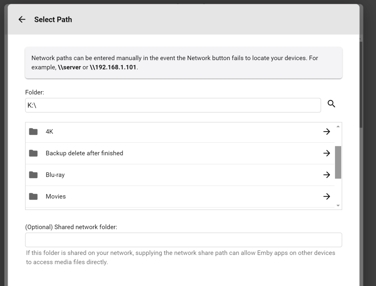

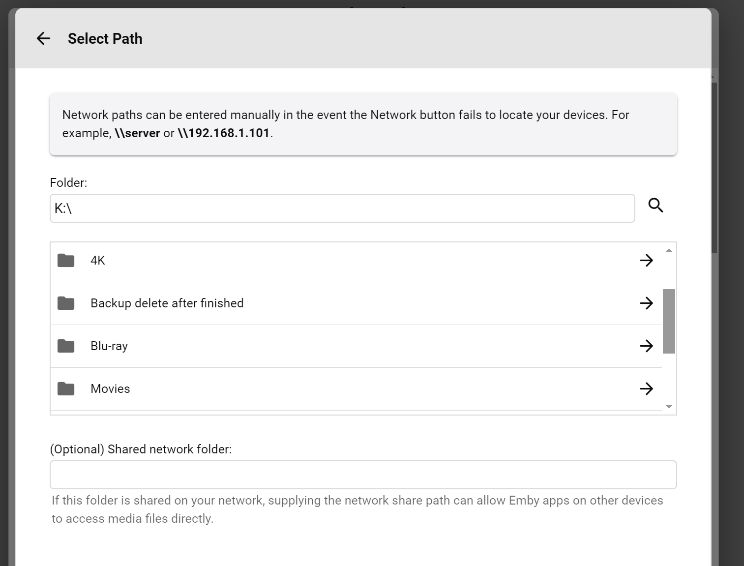

e27 7 Posted February 11, 2024 Author Posted February 11, 2024 In the Metadata Manager my 4K, Bluray, and Movies(DVD) would populate with all my movies folders, each folder would show my movies in MKV format and now the only dropdown is a few old movies in MP4 format. My library is still mapped as it always has been but if I were to add a new library and try to map these folders they are no longer visible, except the Movies folder because it has MP4 files. The other two folders just have MKV files.
Trevor68 70 Posted February 11, 2024 Posted February 11, 2024 (edited) What is that bottom screenshot, is that where you add folders to libraries? If you put a MKV movie in the K:\Movies folder can you see and play it? I wasn't saying map "those" folders, they are clearly broken. Map a new library and add a new folder to it, put some mkv movies in it and see if it works. So add K:\Newfolder to a library, put some movies in it and update your library and enjoy. As before if Emby cannot "see " your existing folders to add them to a library then stop wasting your time looking in Emby for them Create new ones that can be added, profit. If you want me to RDP in and take a look I am happy to do so, just PM me Edited February 11, 2024 by Trevor68
rbjtech 5345 Posted February 11, 2024 Posted February 11, 2024 8 hours ago, e27 said: In the Metadata Manager my 4K, Bluray, and Movies(DVD) would populate with all my movies folders, each folder would show my movies in MKV format and now the only dropdown is a few old movies in MP4 format. My library is still mapped as it always has been but if I were to add a new library and try to map these folders they are no longer visible, except the Movies folder because it has MP4 files. The other two folders just have MKV files. ok - so your only seeing MP4 files in K:\Movies even though it also has MKV files in there as well correct ? In the library settings - if you were to ADD a path of k:\Movies\Movies\Father of the Bride Collection\ do you see the Father of the Bride folders appear (the original + part 2) ? I'm not suggesting this is what you need to do, but I just want emby to SEE the folders and files - then we can work out why. @LukeIs there any limitations of how deep a MKV can be in sub folders ? IF the permissions on MP4 and MKV are the same (the file system can see them, see above) is there any reason why emby can't see them ?

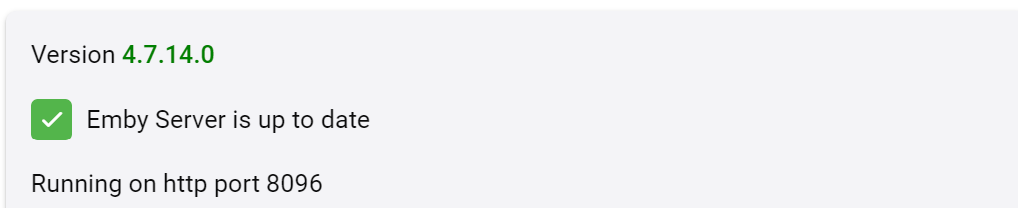

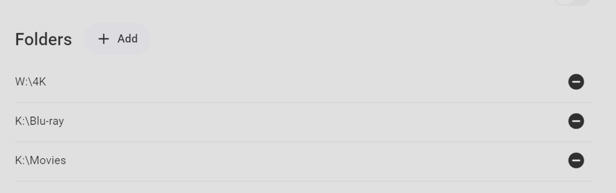

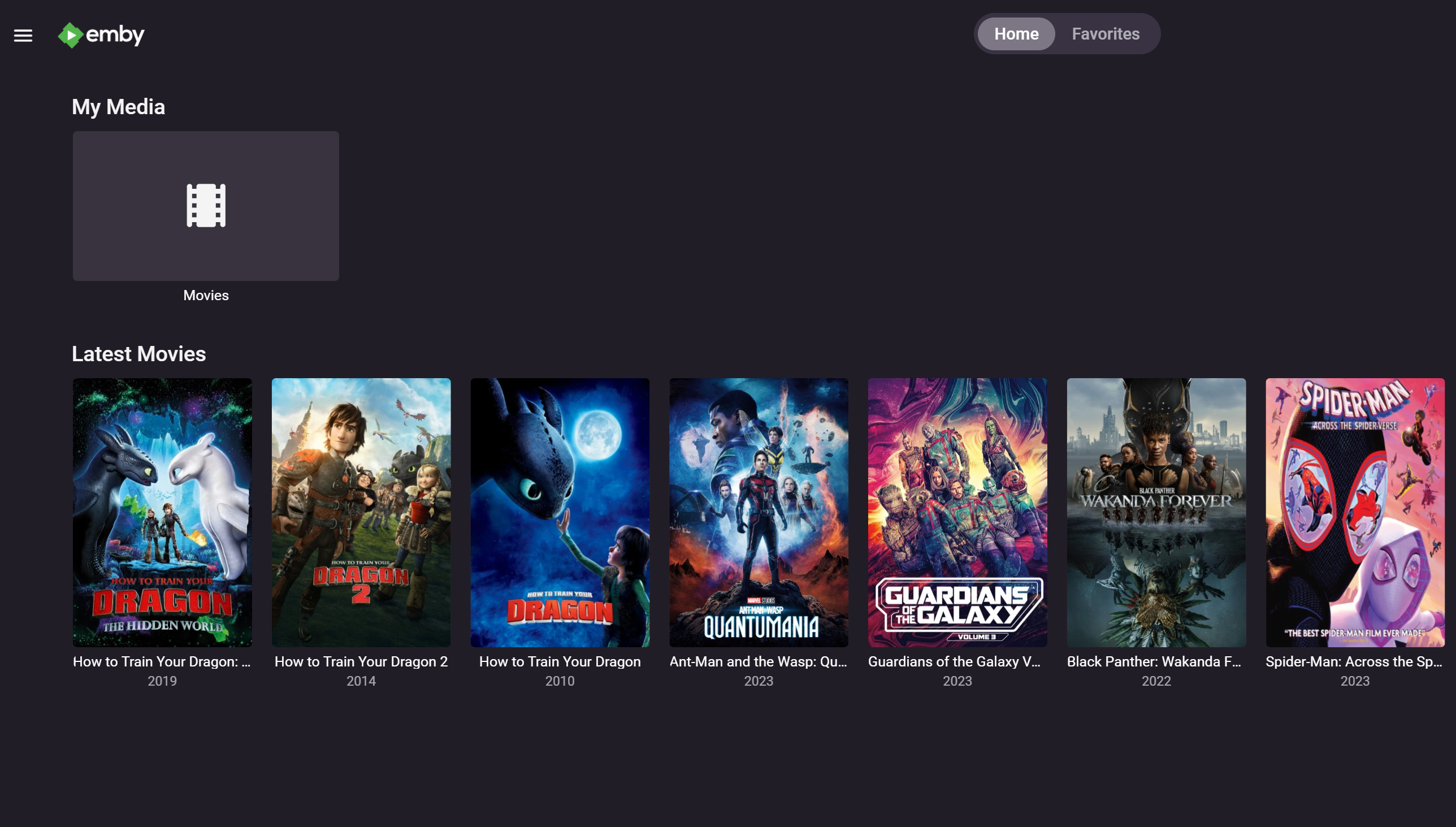

e27 7 Posted June 5, 2024 Author Posted June 5, 2024 Sorry for being gone for a while. Life. Here is what I did. I downloaded an old version before any of the 4.8 versions. I installed version 4.7.14.0 and it found my folders and drives without any issues. I let Emby library scan all the files and was able to play a movie. All of my media was available as it once was. Then I updated to 4.8.8.0 and as soon as I did a library scan poof, all gone except for 4 movies. I took pictures and have attached them and the log file. embyserver.txt
Happy2Play 9814 Posted June 5, 2024 Posted June 5, 2024 Not sure as your log show the items being removed from the database and you have a random/partial permissions issue on Emby Metadata folder.
