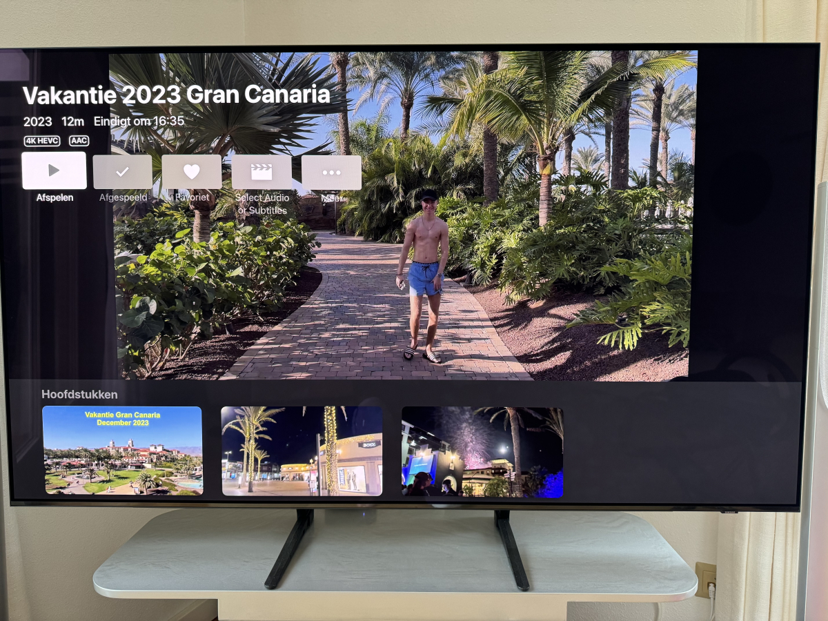

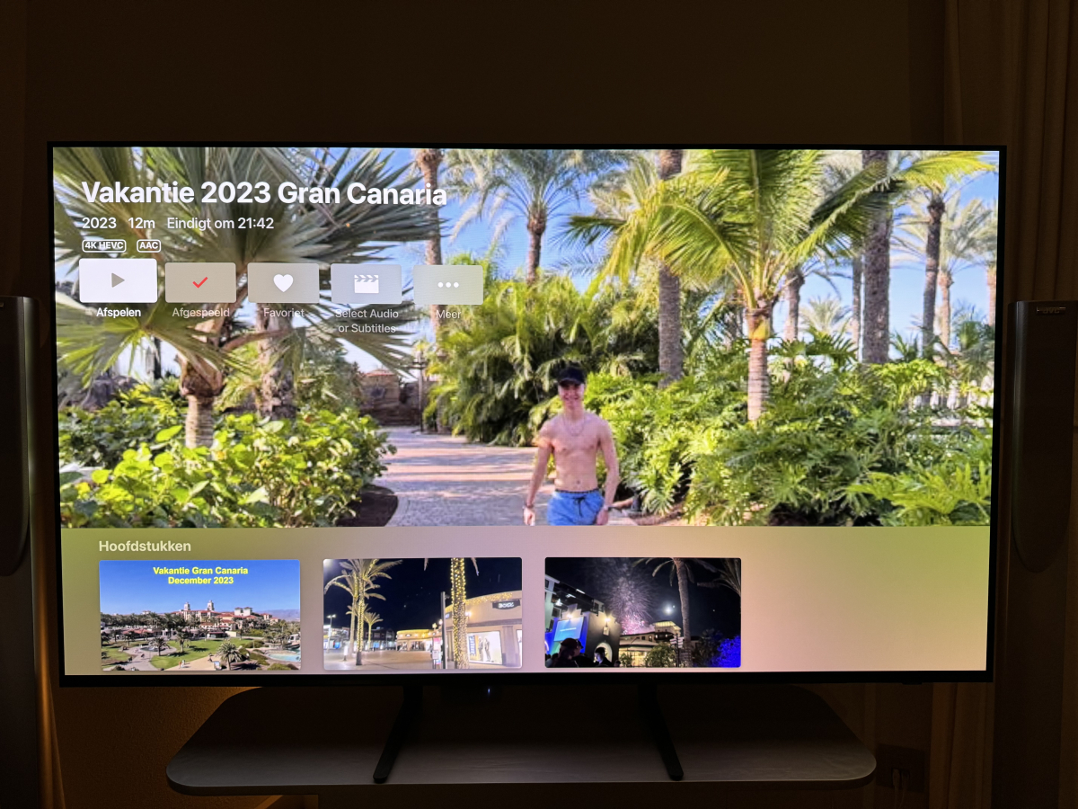

GravityRZ 3 Posted June 18, 2024 Author Posted June 18, 2024 (edited) the thumbnails are generated at full res but somehow it looks like the screen is dull please look at the before and after photo's and also notice the brightness off the chapter thumnails on the bottom the chapter thumbnails are still as bright but the main thumbnail(the big one) changed in brightness also with version 4.7.14 the image was displayed full screen and the chapter thumbnails were displayend on top. now the big one has its own space and does not strech the complete screen i liked the old setup better. please correct this if you can Edited June 18, 2024 by GravityRZ
Luke 43721 Posted June 20, 2024 Posted June 20, 2024 On 6/18/2024 at 10:34 AM, GravityRZ said: the thumbnails are generated at full res but somehow it looks like the screen is dull please look at the before and after photo's and also notice the brightness off the chapter thumnails on the bottom the chapter thumbnails are still as bright but the main thumbnail(the big one) changed in brightness also with version 4.7.14 the image was displayed full screen and the chapter thumbnails were displayend on top. now the big one has its own space and does not strech the complete screen i liked the old setup better. please correct this if you can Hi, they look the same to me. I think it's just the background behind them that is different.
GravityRZ 3 Posted June 20, 2024 Author Posted June 20, 2024 no it is not. in the first picture the background is shown stretched full screen and the background behinmd the chapters is blurred. in the second screen the picture is resized vertically until it reaches the chapters and thus creating black vertical bars left and right. eg the way the picture is displayed has changed. please lok at the changelog. something must have changed
SamES 1150 Posted July 13, 2024 Posted July 13, 2024 (edited) When the only image provided is a poster, it will be displayed using the poster aspect ratio with black bars on the side. On the web app, it is possible to do that in a way that extends to the bottom of the screen and renders beneath the chapter images. On AppleTV, we can only render a poster this way in the top section as only background images can render beneath other rows. This also means the image will appear narrower on screen as it is not as tall. If we use the poster as a background, it will stretch and fill the full screen like your first image, but it will distort images that aren't 16:9. This is why it was changed. We also need to consider live tv programs and other media types where we only have poster images. In essence, a poster will be displayed as a poster, with black bars if necessary. To achieve your result, try setting a backdrop image instead (or as well as) a poster. If there are both, it will set the backdrop as the background and ignore the poster. Just be aware that if the image is not 16:9 it will be stretched (and possibly distorted) to fill the full screen. Edited July 13, 2024 by SamES
