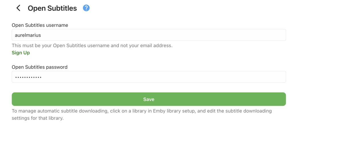

AurelMarius 9 Posted February 6, 2024 Posted February 6, 2024 Same problem here. OpenSubtitles not working.log.txt

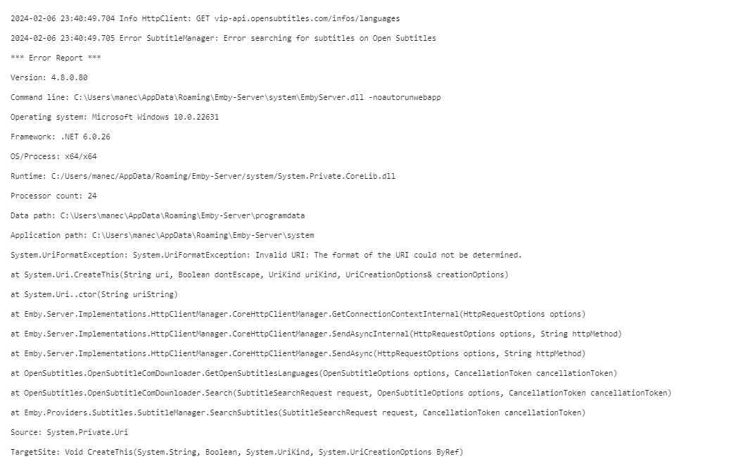

Solution manecosta87 1 Posted February 7, 2024 Solution Posted February 7, 2024 Working for me now on Open Subtitles 1.0.53.0. Thanks for the quick fix! Amazing work! 1

Neminem 1960 Posted December 25, 2024 Posted December 25, 2024 @sundevil67It looks like your are using email and not username. Try with your username, in stead. MediaBrowser.Model.Net.HttpException: MediaBrowser.Model.Net.HttpException: {"message":"Error, invalid username/password - remember to use your username and not your email to authenticate","status":400}
sundevil67 30 Posted December 25, 2024 Posted December 25, 2024 11 hours ago, Neminem said: @sundevil67It looks like your are using email and not username. Try with your username, in stead. MediaBrowser.Model.Net.HttpException: MediaBrowser.Model.Net.HttpException: {"message":"Error, invalid username/password - remember to use your username and not your email to authenticate","status":400} Thank you!
