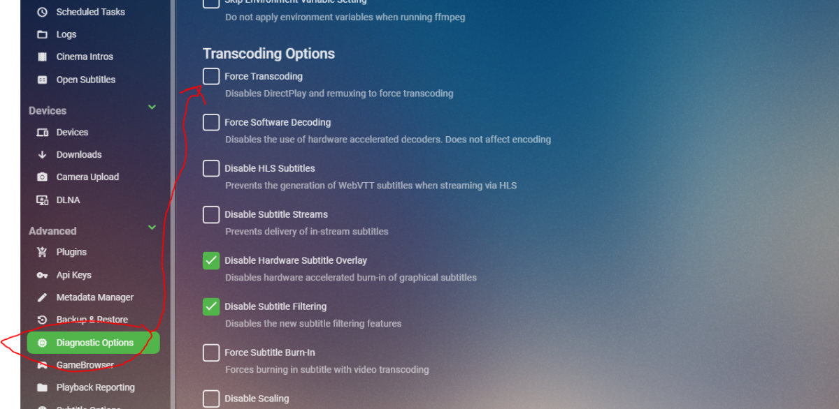

solidsnakex37 55 Posted February 6, 2024 Posted February 6, 2024 26 minutes ago, Happy2Play said: But no there is no way to always transcode unless you set each client to a quality lower than your media bitrate. As of 4.8 this is no longer the case. You can force transcoding in Diagnostic Options.
ITGuy1024 18 Posted February 6, 2024 Author Posted February 6, 2024 (edited) 19 minutes ago, solidsnakex37 said: As of 4.8 this is no longer the case. You can force transcoding in Diagnostic Options. Is this a plugin? - never mind I found it. Thanks will try. Edited February 6, 2024 by ITGuy1024

solidsnakex37 55 Posted February 6, 2024 Posted February 6, 2024 2 minutes ago, ITGuy1024 said: Is this a plugin? I believe it is (been a while), it should be in the plugin catalog
ITGuy1024 18 Posted February 6, 2024 Author Posted February 6, 2024 1 minute ago, solidsnakex37 said: I believe it is (been a while), it should be in the plugin catalog Got it thanks. Will try this.
Happy2Play 9799 Posted February 6, 2024 Posted February 6, 2024 23 minutes ago, solidsnakex37 said: As of 4.8 this is no longer the case. You can force transcoding in Diagnostic Options. True, but as the note says these are temporary testing options. Those options are intended to help investigating problems and should only be set when requested by Emby staff. None of those are intended to fix a problem for regular Emby operation. Settings made here will not be saved. They won't survive a server restart and might be automatically reset after some time.

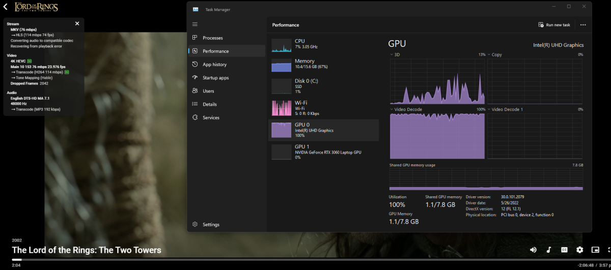

ITGuy1024 18 Posted February 6, 2024 Author Posted February 6, 2024 Maybe related, maybe not. Maybe an issue with my laptop, maybe emby web. Playing in chrome uses the UHD GPU and just crushes it. Is it normal to hit the client GPU so hard with playback?
Happy2Play 9799 Posted February 6, 2024 Posted February 6, 2024 14 minutes ago, ITGuy1024 said: Maybe related, maybe not. Maybe an issue with my laptop, maybe emby web. Playing in chrome uses the UHD GPU and just crushes it. Is it normal to hit the client GPU so hard with playback? The image shows the server is transcoding the media in hardware so yes, I would say that is normal. But from a client standpoint no as the server is doing the transcoding so is the client and server the same machine?
Neminem 1594 Posted February 6, 2024 Posted February 6, 2024 Well from you screenshot you video is transcoding video and audio, on top of that tone mapping. Have you set transcoding to throttle ?
ITGuy1024 18 Posted February 6, 2024 Author Posted February 6, 2024 10 minutes ago, Happy2Play said: The image shows the server is transcoding the media in hardware so yes, I would say that is normal. But from a client standpoint no as the server is doing the transcoding so is the client and server the same machine? Server is a separate physical system.
ITGuy1024 18 Posted February 6, 2024 Author Posted February 6, 2024 9 minutes ago, jaycedk said: Well from you screenshot you video is transcoding video and audio, on top of that tone mapping. Have you set transcoding to throttle ? I have no throttling in place.
