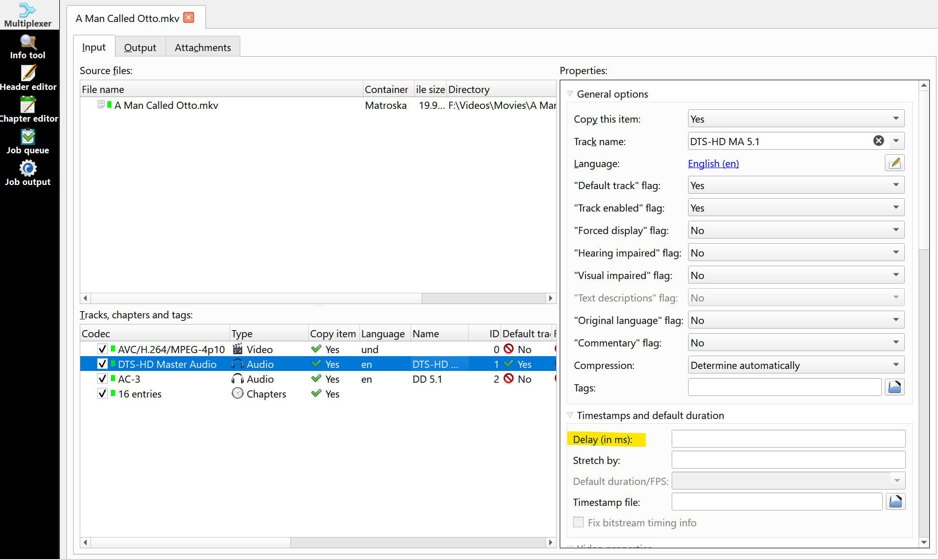

viking19 32 Posted February 6, 2024 Posted February 6, 2024 This is not an answer to your issue, just a question. Are you aware you can quickly remux those files with MKVToolNix or cmd line so the delay is no longer there? Then this wouldn't be a problem in any player.

exus 17 Posted February 6, 2024 Author Posted February 6, 2024 (edited) if I remux and remove the delay, that audio track is just going to be out of sync. (It happens when a video and it's original audio track get remuxed with another audio track taken from a different video source with usually different intros). Am I missing some options in mkvtoolnix? Edited February 6, 2024 by exus
viking19 32 Posted February 6, 2024 Posted February 6, 2024 1 hour ago, exus said: if I remux and remove the delay, that audio track is just going to be out of sync. (It happens when a video and it's original audio track get remuxed with another audio track taken from a different video source with usually different intros). Am I missing some options in mkvtoolnix? It's there, just select the audio track then scroll down the properties window. You will need to put +23668 which is a lot, I have know idea if it will work in one go. 1
exus 17 Posted February 6, 2024 Author Posted February 6, 2024 I know about that option, but if I change that, the audio track just goes out of sync. I fix an issue and create another one
