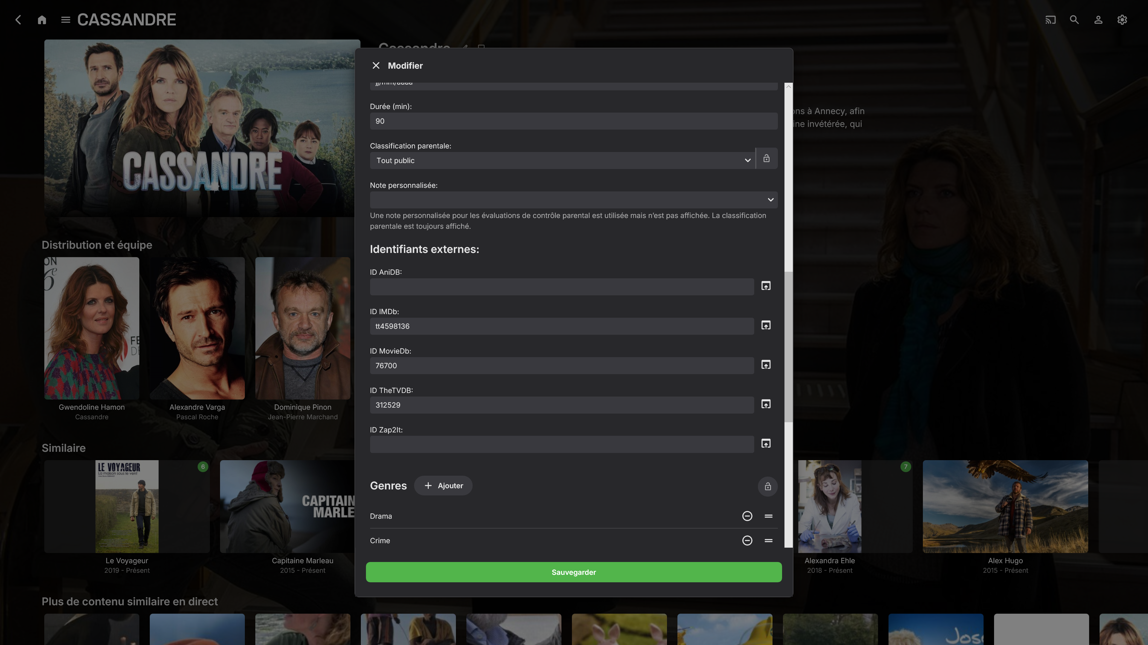

Luke 42287 Posted April 30, 2024 Posted April 30, 2024 On 4/24/2024 at 3:08 AM, pdeliot said: Another illustration there. Option checked, and all itération planned for recording, including S1E4, S2E1 witch are actually already in library: If you have the series in both your recordings library as well as another TV library, then you may want to check and make sure that the external id's in the metadata editor for both series are the same.
pdeliot 10 Posted May 1, 2024 Posted May 1, 2024 Yes.. At least at serie level. And "read / unread" matching is working between both library.. Then it should also match at episode level.
