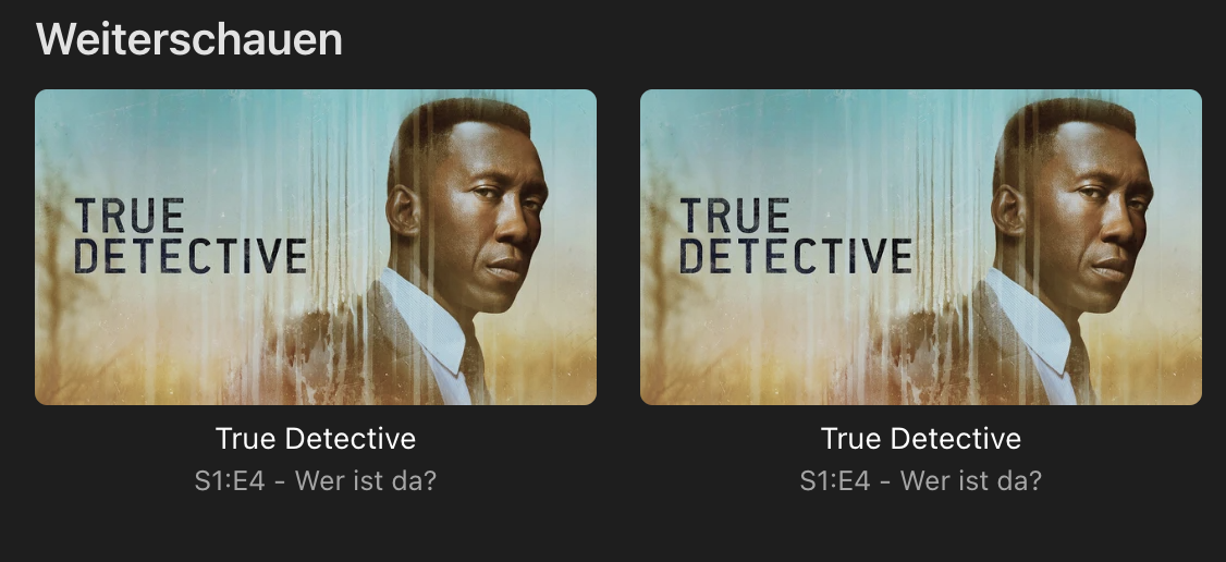

queenbuzzo 11 Posted February 5, 2024 Posted February 5, 2024 (edited) Hi, I have already posted in this thread but my issue actually is different so I thought I post it here as well. After the update to 4.8.0.80 all my media files are listed twice and I can't figure out what is going on. Emby seems to think there are two files/version for the same movies or series but there are not. This is how it looks like for an episode of a series I'm currently watching: Both entries has different IDs and play fine which even puzzles me more: http://192.168.0.254:8096/web/index.html#!/item?id=17724221&serverId=XXX&context=home http://192.168.0.254:8096/web/index.html#!/item?id=22444088&serverId=XXX&context=home For movies it looks like this: I can see that there are two versions listed but it is actually the very same file. Edit: I have checked the Reports plugin and all series, seasons and episodes are listed twice (they have a different rating though). Movies seem normal. What a mess... Any help would be greatly appreciated. I'm even considering downgrading for now, if that is possible (but I'm not sure about all the changes, especially the DB). I'm using the linuxserver.io container. Thanks Edited February 5, 2024 by queenbuzzo

queenbuzzo 11 Posted February 5, 2024 Author Posted February 5, 2024 Interesting, could be related. In the meanwhile I have checked the DB itself and there are two different entries for the same file. I just don't understand what is going on there and why Emby is behaving so weird.

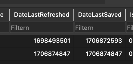

queenbuzzo 11 Posted February 6, 2024 Author Posted February 6, 2024 (edited) I did another more thorough investigation, here are my findings: First of all: I have 8 libraries listed in Emby: 4K Movies, HD Movies, Series, Documentaries, Trash Movies, Recordings (unused), Playlists (from Emby), Collections (from Emby). Only the HD Movies and series libraries are showing the issue. All other libs are fine. Also newly added things are fine. Since Emby sees two different versions of my files, I grabbed the library database and checked it. What I can see is that each of my movie files or episodes have a duplicate entry but they do have the same creation date: This is here seems to be the interesting part. The bottom timestamp is the time my Emby server was update to the newest version so something happened that created these duplicate entries. Besides the IDs there's only one major difference I can spot and that is the ratings stuff: As I mentioned earlier I can remove the library completely and what I can tell now is that new "library" will stay in the background. It's not listed as a library anywhere but I can search for the items in it. I'm wondering if there's anything I can do or if this is something you will take care of? If not, I need to know where the watch states are saved so I can rebuild my server, maybe trying it on a database level... and have a longer back up retention and disable auto updates.... Thanks queenbuzzo Edited February 6, 2024 by queenbuzzo

Luke 42244 Posted February 7, 2024 Posted February 7, 2024 Right I still don't think it was caused by this update, those entries were probably lingering before but just not visible until now. The question is how to remove them. In the database you'd have to walk through all of the constraints and first delete records in other tables in order to get the mediaitems deletes to succeed. There's about 8-10 tables that you'll first have to delete records from. If you can get through that then you can avoid the destructive route of a full fresh start.
queenbuzzo 11 Posted February 7, 2024 Author Posted February 7, 2024 I'm not sure, but to me it all points to the update since all new entries have a DateLastRefreshed on the 2nd of February when the update happened, some even have a creation date on this day. It might all be coincidence but at least hints to the update. I'm now going the database route and while I think I found all constraints, I still get a foreign key issue. I tried to ignore the FK constraints but was working on the DB on my laptop and that shut down during the night while the operation was running and the deletion was not finished. I have no experience with SQLite at all (but have some with other databases) and am wondering how long deletion of roughly 10k items would take. Do you maybe have a rough idea? Oh and another question: Should I delete the old or new duplicate entry? What do you think? Currently I'm opting to delete all entries that have DateLastRefreshed > 02.02.2024 10am which is a good hour before the update started but I could also do it the other way around.

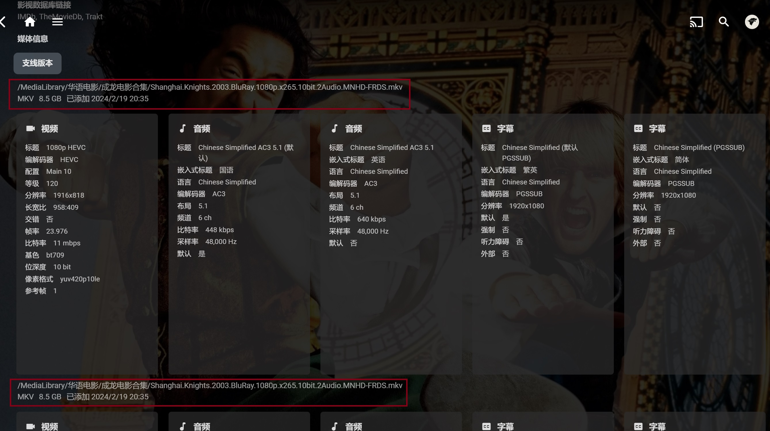

wolong_zb 10 Posted February 27, 2024 Posted February 27, 2024 (edited) I have the same problem, about 5% of movies repeat twice and up to 4 times, all pointing to the same path (soft links point to other paths). After deleting the item, it will continue to appear after refreshing. Unless the path of the file is changed, it will not appear after rescan. If you create a new server and then add the media library again, rescan add, then this image will not appear. The impression is from emby 4.8.x. Ubuntu 22.10/emby 4.8.1.0 Edited February 27, 2024 by wolong_zb

Luke 42244 Posted February 27, 2024 Posted February 27, 2024 2 hours ago, wolong_zb said: I have the same problem, about 5% of movies repeat twice and up to 4 times, all pointing to the same path (soft links point to other paths). After deleting the item, it will continue to appear after refreshing. Unless the path of the file is changed, it will not appear after rescan. If you create a new server and then add the media library again, rescan add, then this image will not appear. The impression is from emby 4.8.x. Ubuntu 22.10/emby 4.8.1.0 Hi, did you try the suggestions I mentioned earlier?

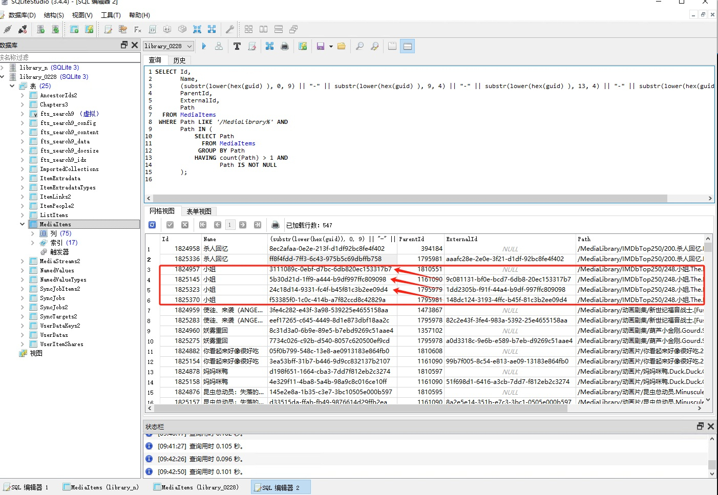

wolong_zb 10 Posted February 28, 2024 Posted February 28, 2024 21 hours ago, Luke said: Hi, did you try the suggestions I mentioned earlier? Because the project data is large, it is not operated by deleting the media library for the time being; I delete all duplicate items by editing the library.db file using the following sql statement; Then re-scan refresh, can normally display a single item; But it reappeared the next day. After checking the log, the log describes that the task started at 04:10 and item was added again. After analyzing the mediaitems table in the database, it is found that among the duplicate items, the field externalId of the item added later points to the previous item, as shown in the figure below. del-same-items.txt embyserver-63844708508.txt
Luke 42244 Posted February 28, 2024 Posted February 28, 2024 8 minutes ago, wolong_zb said: Because the project data is large, it is not operated by deleting the media library for the time being; I delete all duplicate items by editing the library.db file using the following sql statement; Then re-scan refresh, can normally display a single item; But it reappeared the next day. After checking the log, the log describes that the task started at 04:10 and item was added again. After analyzing the mediaitems table in the database, it is found that among the duplicate items, the field externalId of the item added later points to the previous item, as shown in the figure below. del-same-items.txt 1.57 kB · 1 download embyserver-63844708508.txt 681.85 kB · 0 downloads The duplicate is caused by the watch history plugin as I mentioned in the other topic. Please remove that plugin and then you shouldn't see any new duplicates.
wolong_zb 10 Posted February 28, 2024 Posted February 28, 2024 3 hours ago, Luke said: The duplicate is caused by the watch history plugin as I mentioned in the other topic. Please remove that plugin and then you shouldn't see any new duplicates. Thanks for your answer, I have uninstalled the viewing history plugin. 1
