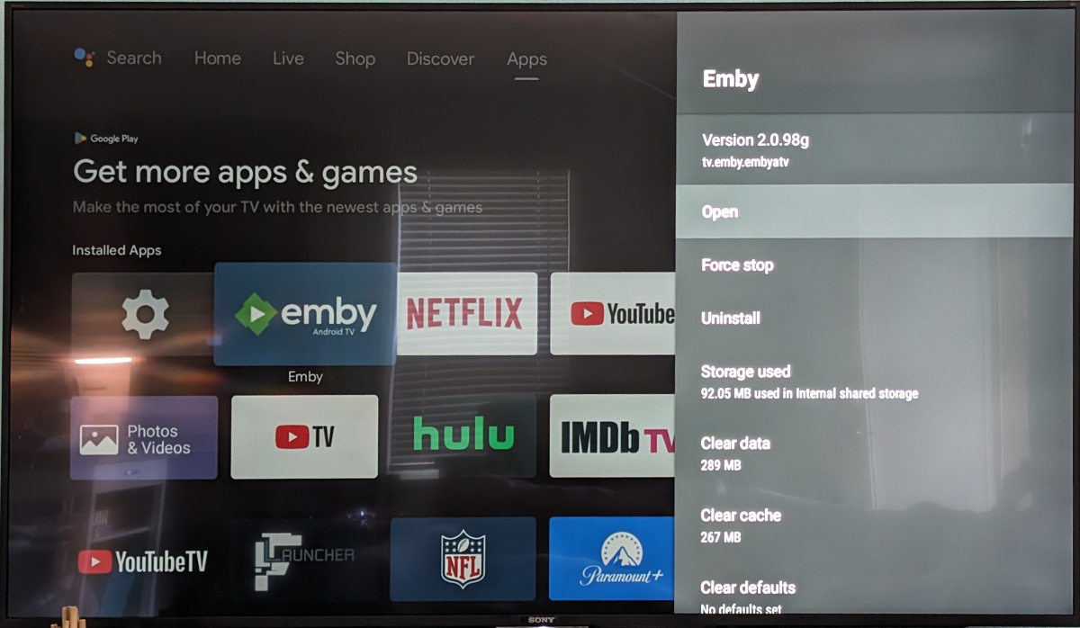

cnstarz 27 Posted February 7, 2024 Author Posted February 7, 2024 On 2/4/2024 at 8:05 PM, Lessaj said: The latest version should be 3.3.65 from February 2 but I'm also opted into the beta for the app so you'd have to check in your play store what it says. I'm stuck on v2.0.98g. Play Store shows no updates available. I've tried uninstalling and reinstalling emby, and rebooting the Shield. How do you opt into the beta?
GrimReaper 4843 Posted February 7, 2024 Posted February 7, 2024 1 minute ago, cnstarz said: I'm stuck on v2.0.98g. Play Store shows no updates available. That is latest stable release, as you're not enrolled in beta there' are no updates. Quote 2.0.98 (27 Oct) Release More buffer adjustments Update Google Play billing library 3 minutes ago, cnstarz said: How do you opt into the beta? You can also sideload beta apk:
cnstarz 27 Posted February 7, 2024 Author Posted February 7, 2024 (edited) Wait a second, the only way for PINs to work on the Shield is if you're enrolled in Beta testing specifically for the Shield app, even though this feature has already been rolled out to the Stable branch of Emby Server? So the stable client app is no longer compatible with the stable server app? Edited February 7, 2024 by cnstarz
GrimReaper 4843 Posted February 7, 2024 Posted February 7, 2024 3 minutes ago, cnstarz said: Wait a second, the only way for PINs to work on the Shield is if you're enrolled in Beta testing specifically for the Shield app No, currently you need to use standard Android app (which is different from AndroidTV client app), as you've already been advised: On 2/5/2024 at 1:38 AM, Luke said: Two things to know: The pin is not the same anymore. It is now called a Profile Pin and has a slightly different function, and this is explained on the user password configuration screen To use it on the Shield, install our standard android app, which is also in the store for it: https://emby.media/emby-for-android.html
cnstarz 27 Posted February 7, 2024 Author Posted February 7, 2024 Just now, GrimReaper said: No, currently you need to use standard Android app (which is different from AndroidTV client app), as you've already been advised: Right, so the stable AndroidTV client app, which is the only Emby app in the Android TV Play Store, is no longer compatible with the stable Emby server branch?
Luke 42184 Posted February 7, 2024 Posted February 7, 2024 1 minute ago, cnstarz said: Right, so the stable AndroidTV client app, which is the only Emby app in the Android TV Play Store, is no longer compatible with the stable Emby server branch? It is compatible, just a little behind on features. We are working on unifying the two apps into one.
