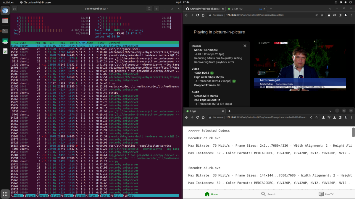

janmemby 7 Posted September 2, 2024 Posted September 2, 2024 (edited) 6 hours ago, softworkz said: You could also try to install Android OS and Emby Server Android. I'm not sure though, whether their Android image has rivers for video hwa. that was a good hint, meanwhile i did some interesting workaround that just proves again that hw transcoding is feasible on rk3588. i installed docker container redroid that basically runs android with gpu acceleration on my ubuntu. than installed emby server on this android and enabled hw transcoding. and voila, it is working, see few screenshots and transcoding log. of course, it is not preferred way to run, but at least to get an inspiration ffmpeg-transcode-faa8bdd9-17ae-47df-a25e-430a0e3dd6b5_1.txt Edited September 2, 2024 by janmemby
softworkz 5133 Posted September 2, 2024 Posted September 2, 2024 Thanks for the log. It confirms that it can work and that there is a driver for video hwa. But the source video is 492x250. A 4k video has 8 times the horizontal and 8 times the vertical resolution. This means that the amount of data to process is 64 times more than in this example. The transcoding speed is around 25 fps (same like the video), so that's already the absolute minimum in order to do live transcoding. You'll have to try with Android installed on the device directly, but I doubt it will be so much better that it can handle 4k transcoding.

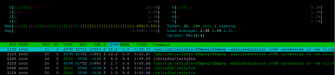

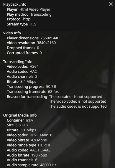

lexm8 1 Posted September 7, 2024 Posted September 7, 2024 On 9/3/2024 at 12:52 AM, softworkz said: A 4k video has 8 times the horizontal and 8 times the vertical resolution. This means that the amount of data to process is 64 times more than in this example. The transcoding speed is around 25 fps (same like the video), so that's already the absolute minimum in order to do live transcoding. Thought I'd just jump in here, currently running Jellyfin on Ubuntu 22.04 in Docker on a Rock5C Lite (RK3582 converted to RK3588S2 by unlocking the disabled cores & GPU) with HWA using the VPU and I'm transcoding Interstellar from 4K HEVC at 68 FPS with subs on. FFMPEG CPU usage looks to be averaging 20-30% would love to see some more work here on the RK3588 as this thing looks like an absolute powerhouse for the price & power usage. I think I've attached the correct FFMPEG logs however if it's not, just point me in the right direction & I'm happy to get whatever. FFmpeg.Transcode-2024-09-07_16-06-48_65b250eabcbe17a66b42759ae8b8a72f_4fbb6401.log.txt 1
