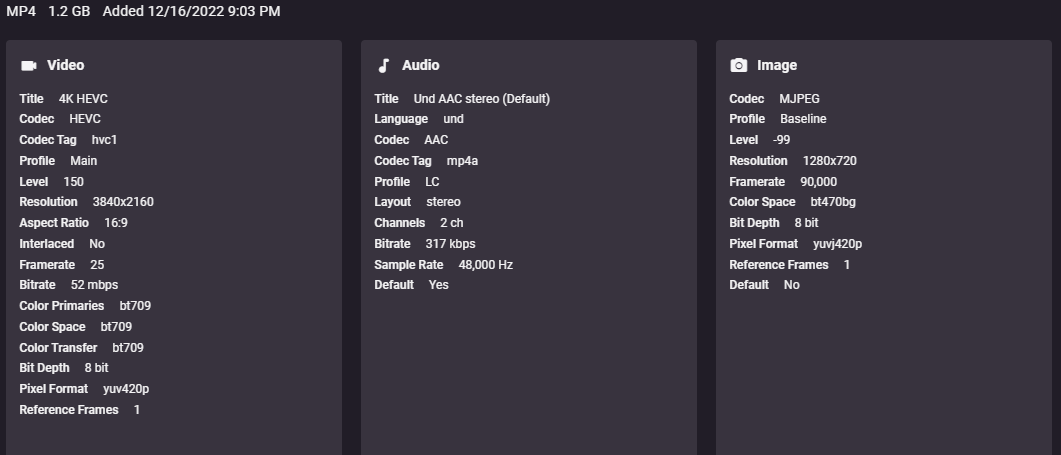

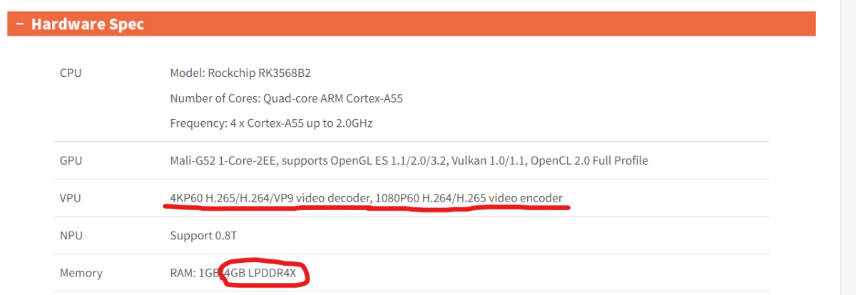

danergo 40 Posted April 15, 2023 Author Posted April 15, 2023 (edited) Hi, @Luke: I installed Emby onto this board, and copied a few footage from my action camera (HEVC, ~50Mbps). In my local network, I can directplay these, but when I want to limit the bitrate (to 4Mbps), Emby tries to transcode, but eventually fails. I'm attaching my logs, please review. If you have any idea what would worth checking, let me know. I wanted to run Emby's ffmpeg manually to print the builtin available decoders and encoders, but I couldn't: /opt/emby-server/bin/ffmpeg: error while loading shared libraries: libdrm.so.2: cannot open shared object file: No such file or directory Either HEVC decoder and/or H264 encoder would be awesome, and this processor is well capable of doing both of these: Here is my media info for quick look: Thank you! ffmpeg-transcode-2ecb39e1-7f8d-4b59-ae7f-7a961a7ff01d_1.txt embyserver (3).txt Edited April 15, 2023 by danergo

softworkz 5133 Posted August 29, 2024 Posted August 29, 2024 You found some repos which pretend to provide ffmpeg with HWA support for this platform, right? Have you managed to get any of those versions to run on your device with HWA (ffmpeg via command line)? If no, then you got an answer already. If yes, then you should already know why it's pointless (even though kind of working). The point is: those devices are technically not really suited for hardware accelerated transcoding. The video acceleration capabilities that they are advertising cannot be compared to what Intel or Nvidia GPUs can do. The actual meaning of those advertised capabilities must be understood like: For video decoding: This is solely about video playback, that means they have a hardware decoding unit which decodes directly to the video output for display - that's all! Even when there are ways to read out the output from video memory, the device would never be able to copy and process the amount of data that a 4k video has. Also, those figures are not realisitc. No way that this SOC can decode and output 4kP60 in any realistic scenario. Video encoding: This is intended for video conferencing (without battery drain) but nothing more HWA Transcoding requires more than just a decoder and an encoder. It also requires video processing that is done in hardware and in a way that the data is kept in video memory during all those steps. The best option for a low-cost Emby Server with HWA transcoding is still Android. Buy a used Samsung or Google phone and you get something that works fairly well (still not comparable to a PC). But those SOCs are a dead end, both from hardware side as well as from software support (reg. hwa).
softworkz 5133 Posted August 29, 2024 Posted August 29, 2024 Another problem with ffmpeg and those devices is that the ffmpeg logic doesn't fit well to those hardwares. Their design is more oriented on mobile devices architectures. One thing you could check is whether there's an Android image for your device which has video drivers with OMX/MediaCodec support for hwa. For earlier RockChip SOCs with MALI GPUs there weren't any available, but maybe they have now..
