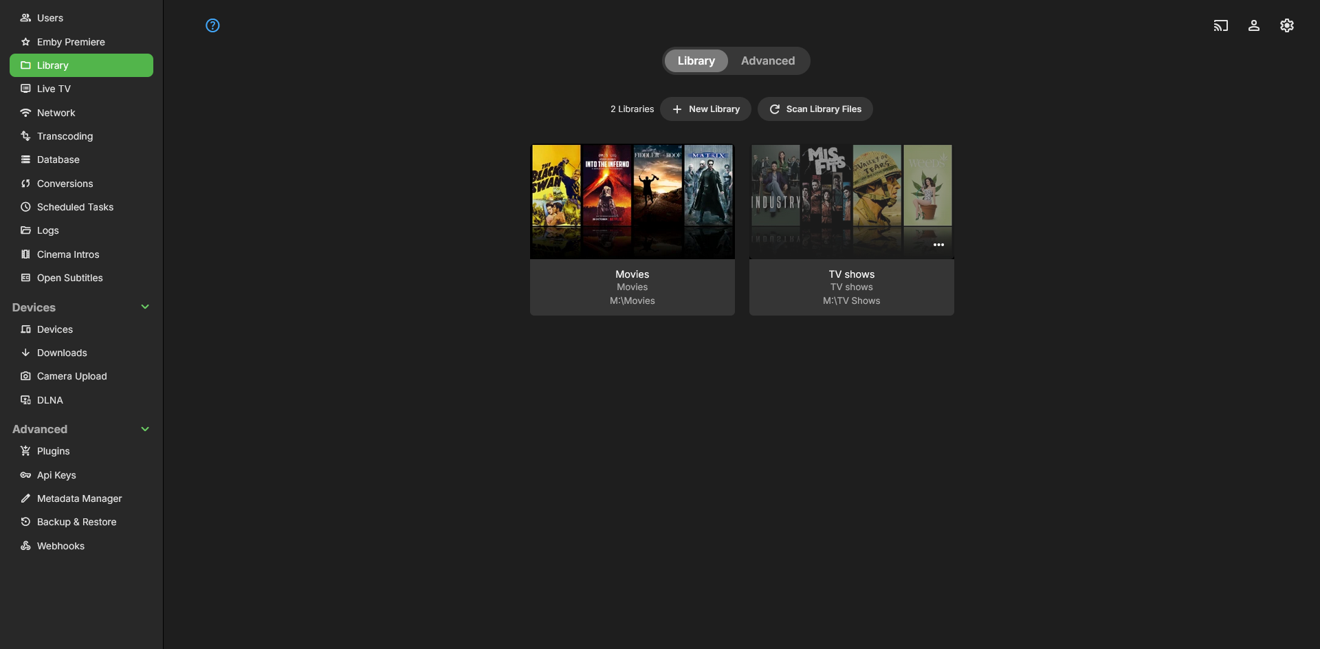

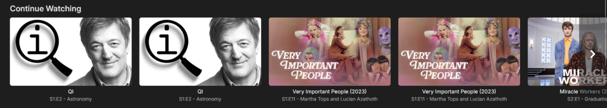

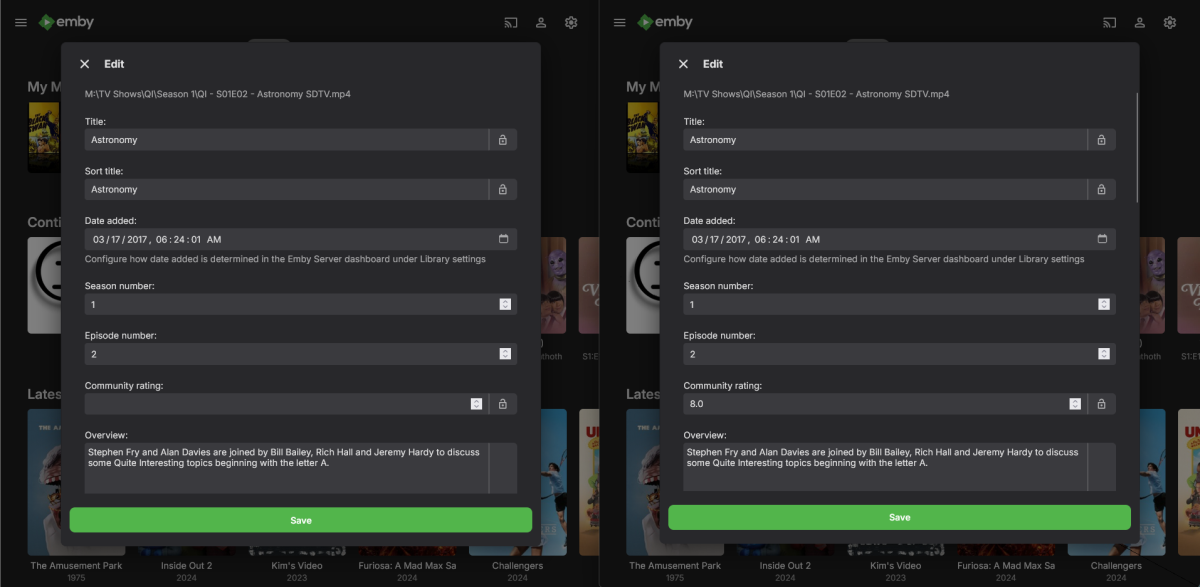

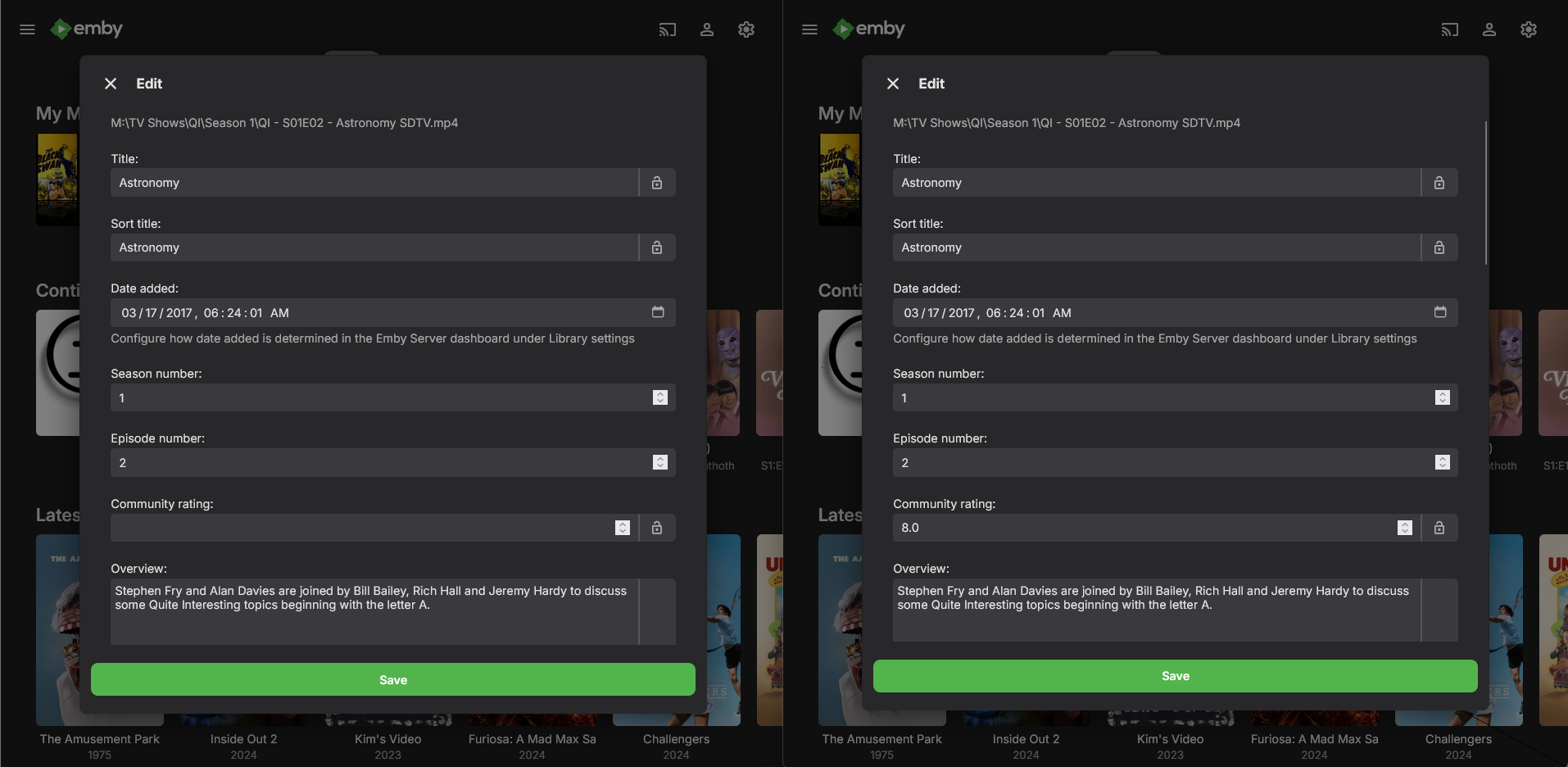

jkexbx 1 Posted June 20, 2024 Posted June 20, 2024 This is now happening to me. A large amount of TV shows are randomly duplicated. I only have the 2 libraries, no plugins that are known to cause this, and the file paths are identical. I did notice that the metadata is different between the versions.

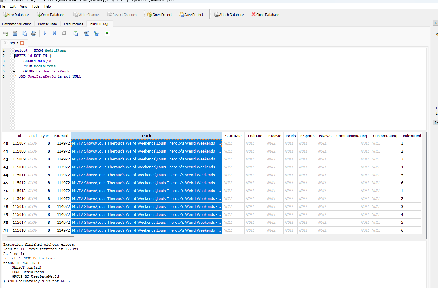

jkexbx 1 Posted June 24, 2024 Posted June 24, 2024 (edited) On 9/19/2023 at 8:37 PM, blap said: update : I delete two plugins ( Movie Theme Videos and Movie Theme Songs ) cause it's seem to me that the problem had begun at this moment ) i've try to : Stop emby backup my library.db Open the db, with DB Browser for SQLite Select the MediaItems Table find and delete all the duplicate entry restart emby Seem to work But, there is at least 1400 duplicate entry, i can't do it manuelly Any help to have a sql request to delete all duplicate entry ? See the instructions above, and the SQL statement I created to fix this. I can't believe how many other people ran into the same problem, and nobody had a fix for it. select * FROM MediaItems WHERE id NOT IN ( SELECT min(id) FROM MediaItems GROUP BY UserDataKeyId ) AND UserDataKeyId is not NULL 19,277 duplicate rows. PRAGMA foreign_keys = 0; DELETE FROM MediaItems WHERE id NOT IN ( SELECT min(id) FROM MediaItems GROUP BY UserDataKeyId ) AND UserDataKeyId is not NULL; PRAGMA foreign_keys = 1; Please note that there's a foreign key reference I didn't bother to join. A better fix would also clean up this orphan data. Everything looks right, and no apparent issues. Edited June 24, 2024 by jkexbx 1

jkexbx 1 Posted June 27, 2024 Posted June 27, 2024 I'm not so sure about that. I'm running 4.8.8.0 and am seeing duplicate database entries still being added. Since Monday, there have been 111 duplicate records. Some only 1 episode, some part of a season. Both movies and TV. These are also not new items I don't remember exactly when I setup this Library, but I would say it's less than 8 months old. Any interest in running the query on your database? It's strange that it's continuing to do it.

Happy2Play 9814 Posted June 27, 2024 Posted June 27, 2024 I can say the query is not necessarily finding duplicate records as all the results it finds in my database are not duplicates. Only looked at a handful of the 2775 records but none of them were duplicated.
