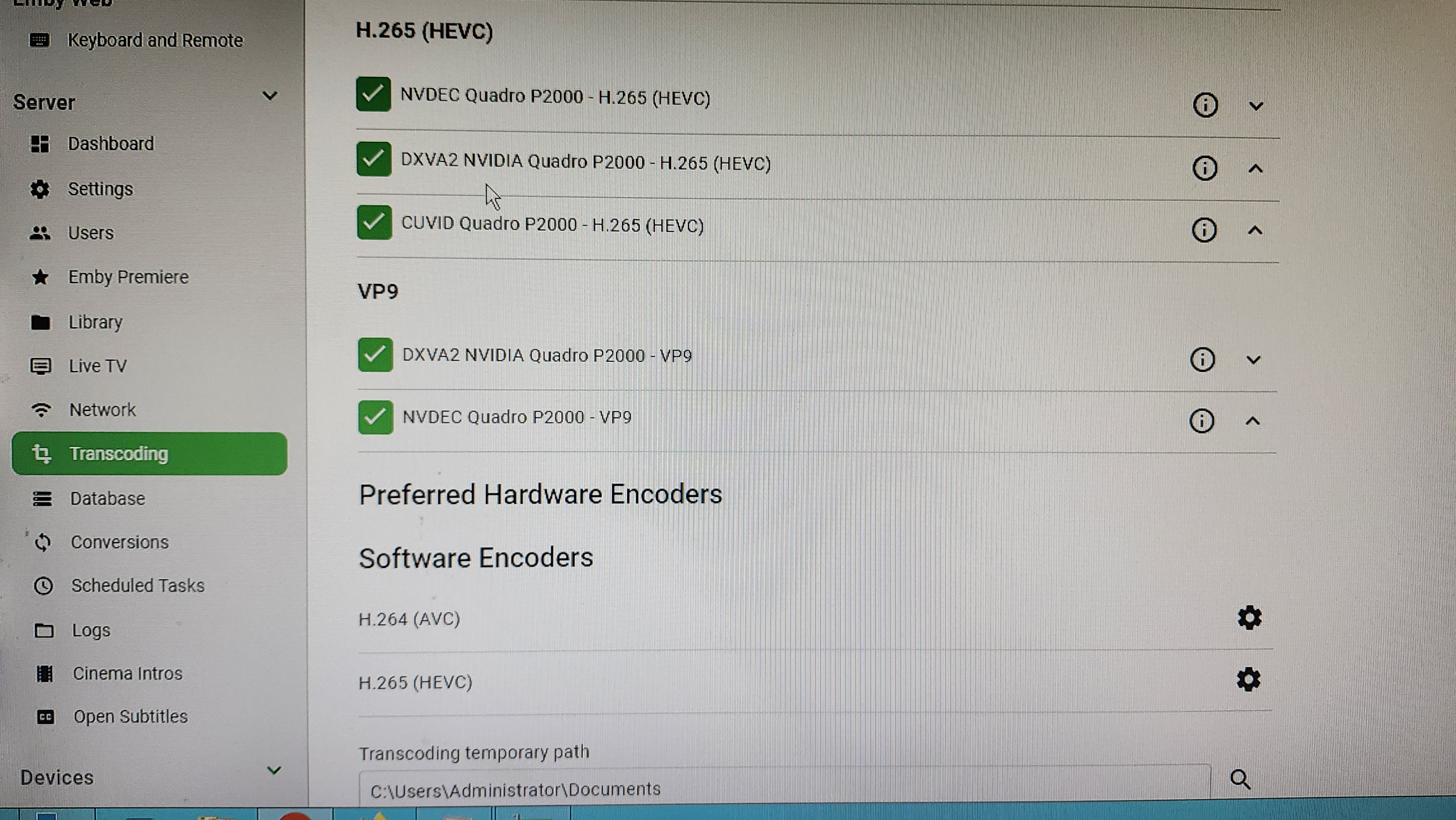

Sonus 3 Posted February 4, 2024 Posted February 4, 2024 After the update to Emby server 4.8.0.80 the advanced settings no longer display preferred hardware encoding for P2000. Hardware Decoding does display. The server is now using FFmpeg consistently. Im using windows server 12 and installed the latest driver update.

softworkz 5487 Posted February 5, 2024 Posted February 5, 2024 @Sonus- can you please post the hw detection log? Also, which driver version do you have installed for the Nvidia GPU?
Sonus 3 Posted February 5, 2024 Author Posted February 5, 2024 Using the one below Version: R440 U4 (441.66) WHQL Release Date: 2019.12.10 Operating System: Windows Server 2008 R2 64, Windows Server 2012, Windows Server 2012 R2 64 Language: English (US) File Size: 388.19 MB hardware_detection-63842708032.txt

softworkz 5487 Posted February 7, 2024 Posted February 7, 2024 The hw detection log says it: The driver is too old. We had to switch to a new minimum API version in order to use new features (e.g. AV1 decoding). Anway, it's a 12 year old OS, so... Things you can try One thing you can try is to install a driver from the 300 version range like this one: https://www.nvidia.com/download/driverResults.aspx/154173/en-us/ Yet I'm not sure whether it supports NVENC 11.0 (despite the message in the log) Then you can also try whether one of the newer drivers might work, which officially support Server 2012 R2 only. Maybe one can still work on Server 2012. I wouldn't try the latest but rather a little older ones - maybe one from the 300 range and one from the 400 range, which would be: https://www.nvidia.com/download/driverResults.aspx/177168/en-us https://www.nvidia.com/download/driverResults.aspx/177161/en-us If none of this will work, then your only chance is to update to Win Server 2012 R2 or later.
