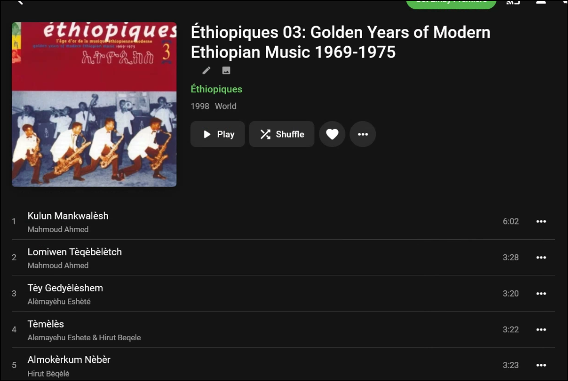

nospotify 187 Posted February 6, 2024 Author Posted February 6, 2024 @Luke I ran portable install and it correctly imports these files. Screenshots below. For AlbumArtist screen it has retrieved a MusicBrainz id, correctly shows name with diacritical, and has set its own E without diacritical mark as Sort title (I'm OK with that, if that's what Emby needs). For individual Albums, it correctly shows name with diacritical, has also removed diacritical from first letter for Sort title, and correctly not retrieved any external IDs. So what does this tell us about how Emby misbehaves when importing new files that were part of the database in the past (or have file/folder creation dates before a previous import, or some other factor internal to Emby)?
nospotify 187 Posted February 7, 2024 Author Posted February 7, 2024 @LukeNeed me to do any other debugging? Is this related to new "Library... Advanced..." setting that allows users to choose "Date added behavior for new content"? Or is it related to where/how metadata is saved, i.e. could removal of these artist/album directories maybe have NOT removed all AlbumArtist traces in other metadata save locations? Weirdly, in Emby's Metadata Manager, AlbumArtist is CORRECTLY listed as Éthiopiques (with diacritical) but not in standard album or artist view screens. Is any of this helpful for isolating the problem?

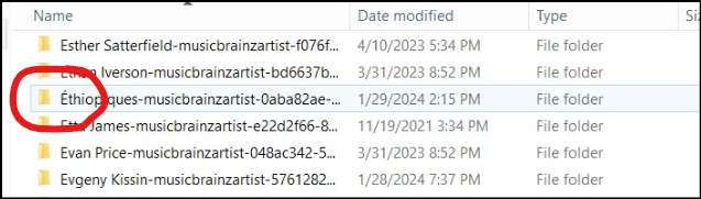

Happy2Play 9814 Posted February 7, 2024 Posted February 7, 2024 (edited) It is still specific to your database containing this artist wrong spelling or media somewhere with the wrong spelling. If it does not purge when removing all data by this artist then unfortunately you will have to manually remove if form that database. Does the wrong spelling the artist appear in your /metadata/musicartist folder? Edited February 7, 2024 by Happy2Play
nospotify 187 Posted February 7, 2024 Author Posted February 7, 2024 (edited) It is correct in the metadata folder and in all the .nfo files. That's what's so mystifying. Emby doesn't seem to be using the data it knows it has. Edited February 7, 2024 by wordlover
Happy2Play 9814 Posted February 7, 2024 Posted February 7, 2024 It does but something happened to your database when stuff was imported and will most likely require your manual intervention. Does changing the spelling in the UI correct your issue?
