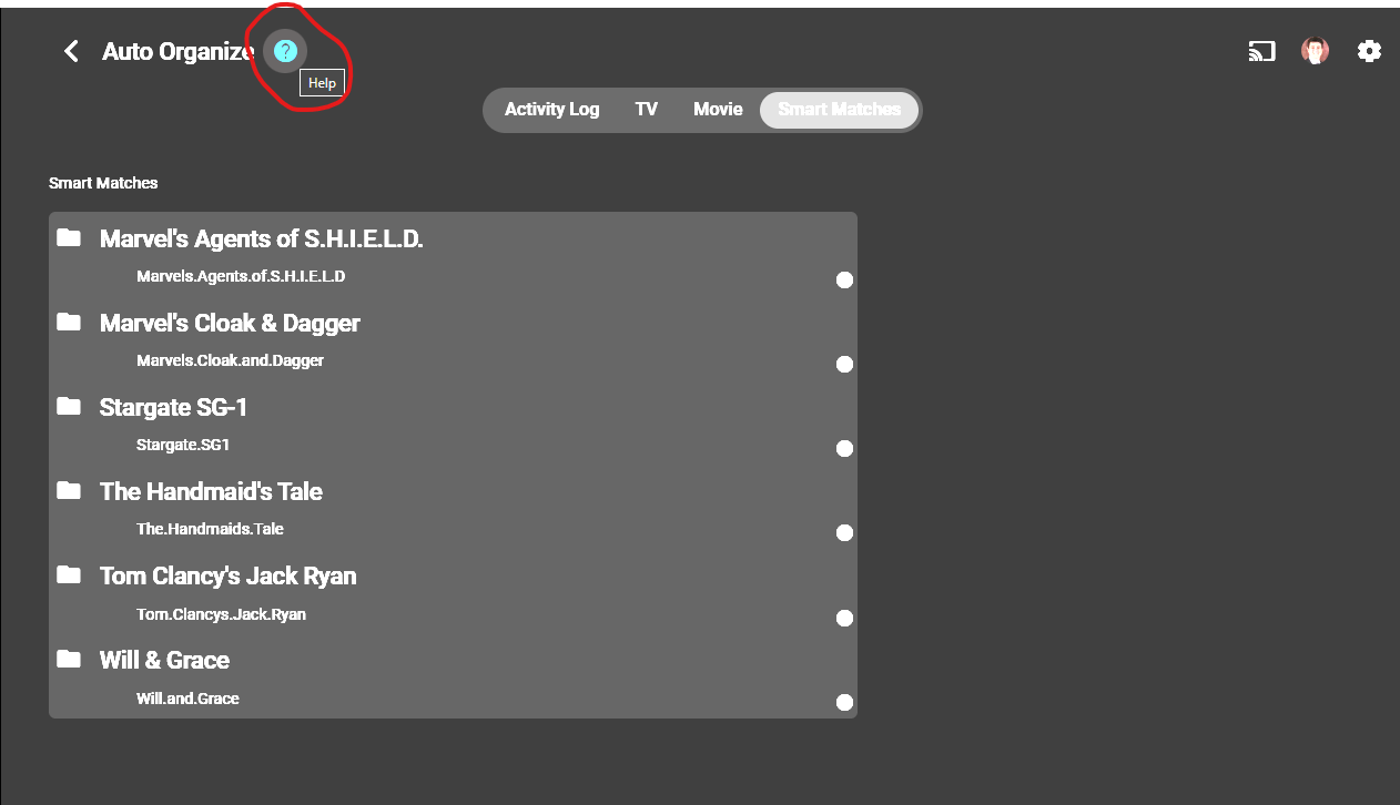

BrettDioson 4 Posted February 4, 2024 Posted February 4, 2024 I have upgraded to 1.7.0.0 of Auto Organize but I can't seem to find a way to add or modify the smart matches area. I can only delete existing smart matches. Is there a way to add Smart Matches anymore to put the files in the correct show?

BrettDioson 4 Posted February 4, 2024 Author Posted February 4, 2024 I go into Auto Organize and can see the log: If I click on the Ellipses on one of the log entries it doesn't give me any useful information really: Going to the Smart Matches tab gives me no options to add any new entries: Clicking the circle on one of the entries just delete it immediately. You don't even get a "Are you sure?" question, and you only know the circle deletes the entry if you hover over it and wait.
Luke 42151 Posted February 5, 2024 Posted February 5, 2024 Quote If I click on the Ellipses on one of the log entries it doesn't give me any useful information really: What are you expecting to see beyond what is there? It succeeded. If it had failed then there would be commands listed in that menu.
Luke 42151 Posted February 5, 2024 Posted February 5, 2024 Quote Going to the Smart Matches tab gives me no options to add any new entries: Did it ever have this? I don't think so. The entire smart match feature was community contributed. As far as I can remember, it's not something you add manually but rather when you organize an episode manually I think there's an option to save a smart match.
Luke 42151 Posted February 5, 2024 Posted February 5, 2024 Quote Clicking the circle on one of the entries just delete it immediately. You don't even get a "Are you sure?" question, and you only know the circle deletes the entry if you hover over it and wait. Again I think it was always like this. Also community contributed. The title of this topic suggested that you encountered some kind of new problem with the update but I think everything is the way it's always been.
BrettDioson 4 Posted February 5, 2024 Author Posted February 5, 2024 8 hours ago, Luke said: Did it ever have this? I don't think so. The entire smart match feature was community contributed. As far as I can remember, it's not something you add manually but rather when you organize an episode manually I think there's an option to save a smart match. I'll try just naming the file something random that it can't match and see what pops up to add a smart match. I know I added the ones that are currently showing I just don't remember how I did it. I tried going to the help icon at the top but the link it send you to goes to some updated knowledge base link but I can't find documentation on Auto Organize:
Luke 42151 Posted February 5, 2024 Posted February 5, 2024 Right I think that was a placeholder and a document has never been created for it. Thanks.
