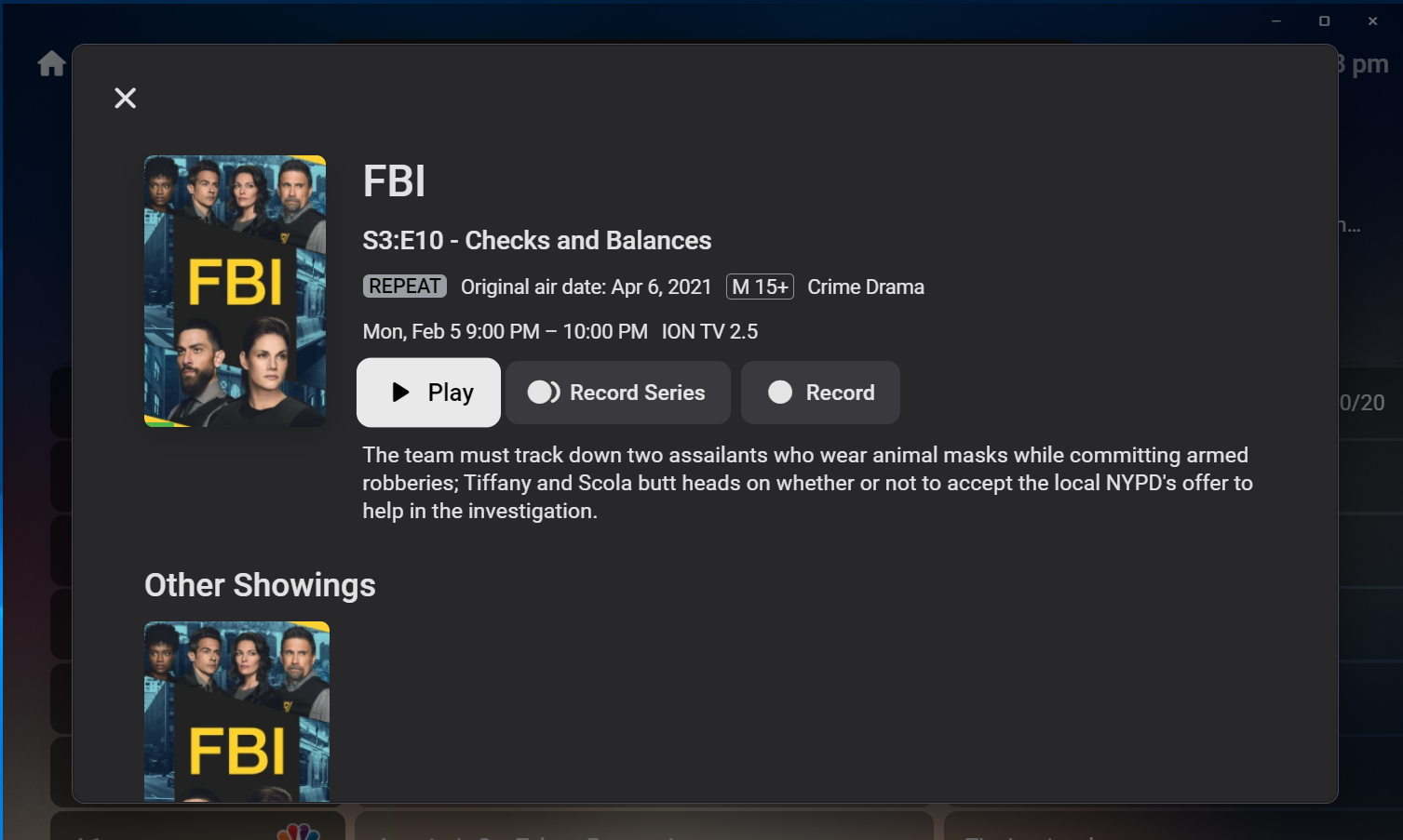

revengineer 142 Posted February 4, 2024 Posted February 4, 2024 Following occurs after update to 4.8.0.80 server running on Windows with emby theater client 3.0.20 also on Windows. From home page, when I select Live TV, then "Guide", then pick any show from the guide, I get a view that does not include the Play button. It seems, that buttons are outside the view at top of screen, but I cannot scroll there. See picture below for example.

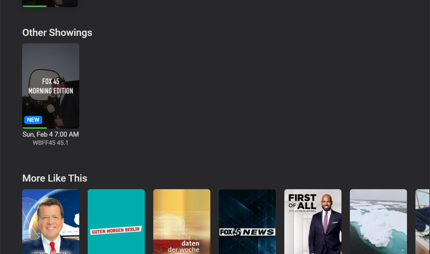

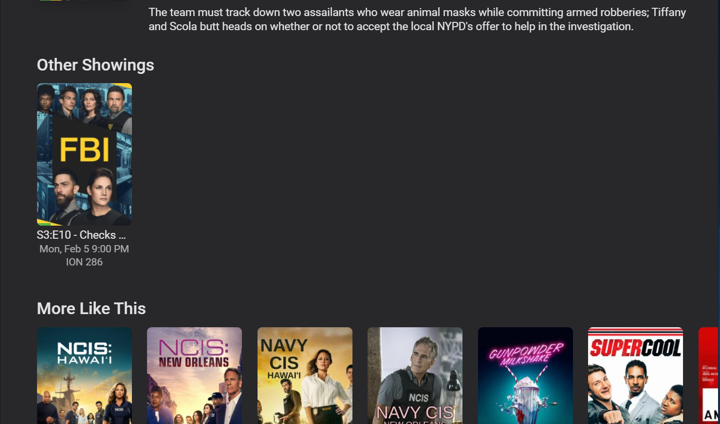

revengineer 142 Posted February 6, 2024 Author Posted February 6, 2024 I restarted both server and client but it did not fix the issue. But I found the problem in the process. I have my emby theater in a window in the top right quarter of my 4k monitor when the issue occurs. If I drag the bottom left corner to make the window somewhat bigger, the screen re-renders and the play/record buttons show and I can scroll the window. This is a new issue with v4.8.0.80 and is perhaps related to the now overlay window style. So to reproduce, just shrink the emby theater window. Smaller window and slightly larger window comparison:
