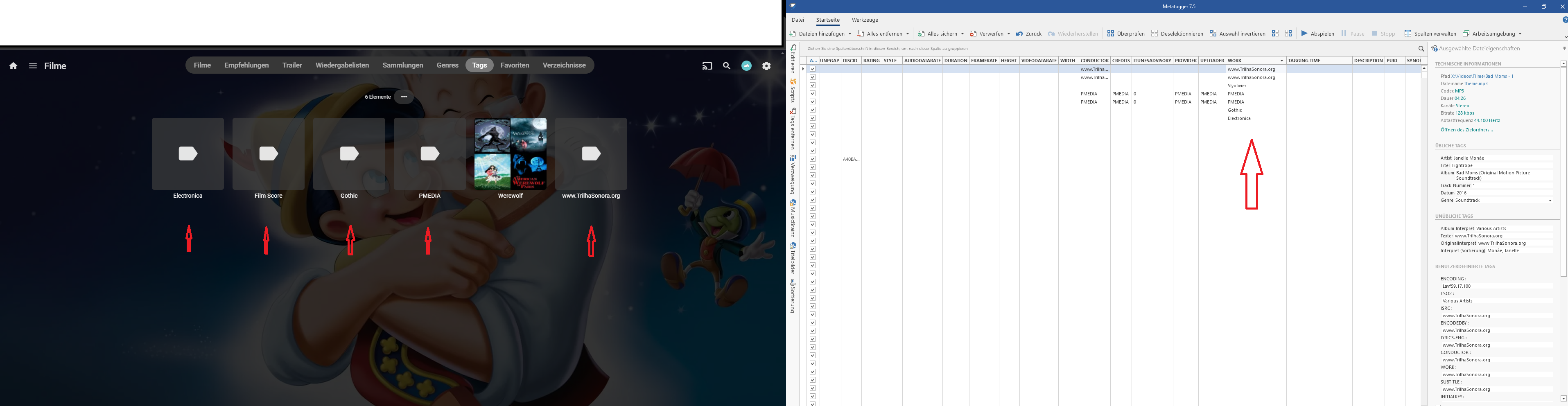

HouseOfCards 95 Posted February 11, 2024 Posted February 11, 2024 11 hours ago, Luke said: Hi, did you not see that the metadata editor allows editing of tags? In my case, I deleted the tags in the "edit metadata" option and deleted them easily enough. I was just pointing out that in my backups (/metadata/tags), the tags are still in there even though I deleted them and Emby no longer shows them... In @Painkiller8818case, I think the issue is that the tags have been removed from the files, and now they can't be removed from the Emby interface anymore. I assume "rescan library files" has been tried in their case? Edit library, three dots, rescan? That should tell Emby to look for changed files... And a metadata refresh? Thanks... 1
Painkiller88 250 Posted February 12, 2024 Author Posted February 12, 2024 14 hours ago, HouseOfCards said: In my case, I deleted the tags in the "edit metadata" option and deleted them easily enough. I was just pointing out that in my backups (/metadata/tags), the tags are still in there even though I deleted them and Emby no longer shows them... In @Painkiller8818case, I think the issue is that the tags have been removed from the files, and now they can't be removed from the Emby interface anymore. I assume "rescan library files" has been tried in their case? Edit library, three dots, rescan? That should tell Emby to look for changed files... And a metadata refresh? Thanks... Hi, yes exactly, i scanned the library a few times but as those elements normally not show up in any library i can't update those files. Theme.mp3 files normally should be ignored from analyze as media file in the normal way as they are just background sounds. There is no option for me to update or edit them with metadata editor, as i have to select a library in which i wanna edit items, and i can't do this for theme songs. Thanks
Solution oesi03 2 Posted February 22, 2024 Solution Posted February 22, 2024 (edited) On 2/12/2024 at 8:38 AM, Painkiller8818 said: Hi, yes exactly, i scanned the library a few times but as those elements normally not show up in any library i can't update those files. Theme.mp3 files normally should be ignored from analyze as media file in the normal way as they are just background sounds. There is no option for me to update or edit them with metadata editor, as i have to select a library in which i wanna edit items, and i can't do this for theme songs. Thanks Hatte dasselbe Problem wie du. Lösung: 1. Verschieben "aller" theme.mp3 (sofern man nicht weiß welche der Auslöser sind) an einen neuen Speicherort. Beim Verschieben darauf achten dass, die Verzeichnisstruktur erhalten bleibt. Sonst wird eine spätere Zuordnung schwer. 2. Emby-Server neu starten und Bibliothek scannen. So in Etwa in "geplante Aufgaben" -> "Library" -> "Scan media library" manuell ausführen. Warten bis der Scan durchgelaufen ist. Dann sollten die leeren Tags verschwunden sein. 3. Entfernen aller Metadaten Informationen der theme.mp3 ("titel; artist; album; date" werden zwar nicht benötigt. Können aber theoretisch erhalten bleiben.) Dazu kann man zum Beispiel verwenden "Metatogger"; "Mp3tag"; "Metadata++" <- alle kostenlos. Bei mir waren die betreffenden strings enthalten in den Metadaten-tags "WORK" und "Stimmungen". Wobei, der Metadaten-tag "Stimmungen" von keinem einzigen Metadaten Programm erkannt und angezeigt wurde. Lediglich mit der Windows Funktion "Eigenschaften" -> "Details" -> "Eigenschaften und persönliche Informationen entfernen" konnte ich auch die ganz einfach loswerden. 4. Zurückschieben aller theme.mp3 sofern die Echtzeitüberwachung eingestellt ist sollte Emby automatisch alle neu einlesen. Ansonsten "Scan media library" manuell ausführen. Eine manuelle Bearbeitung der Datenbank wollte ich auch vermeiden. Bevor etwas schief geht und ich alles neu einlesen muss. Da die Bearbeitung der theme.mp3 eh notwendig ist. Sollte das der beste Ansatz und auch von jedem ohne große Kenntnisse durchführbar sein. Toller Nebeneffekt: ich konnte auch gleich alle defekten theme.mp3 identifizieren die immer wieder zu Abspielproblem führten. _______________________________________________________________________________________________________________________________________________________________________ Had the same problem as you. Solution: 1. Move "all" theme.mp3 (unless you know which one is the trigger) to a new location. When moving, make sure that the directory structure is preserved. Otherwise, later assignment will be difficult. 2. Restart Emby server and scan library. Something like "Scheduled Tasks" -> "Library" -> "Scan media library" Manually! Wait until the scan has finished. Then the empty tags should be gone. 3. Remove all metadata information from the theme.mp3 ("title; artist; album; date" is not required. But can theoretically be retained.) For this you can use, for example, "Metatogger"; "Mp3tag"; "Metadata++" <- all free. For me, the strings in question were contained in the metadata tags “WORK” and “Stimmungen”. The metadata tag “Stimmungen” was not recognized and displayed by any metadata program. I was only able to get rid of them easily using the Windows function “Properties” -> “Details” -> “Remove properties and personal information”. 4. Pushing back all theme.mp3. If real-time monitoring is set, Emby should automatically re-read them all. Otherwise, run “Scan media library” manually. I also wanted to avoid manually editing the database. Before something goes wrong and I have to rebuilt the entire database. Since editing the theme.mp3 is necessary anyway. This should be the best approach and can be carried out by anyone without much knowledge. Great side effect: I was also able to immediately identify all the defective theme.mp3s that repeatedly led to playback problems. Edited February 22, 2024 by oesi03 1

Painkiller88 250 Posted February 22, 2024 Author Posted February 22, 2024 8 hours ago, oesi03 said: Hatte dasselbe Problem wie du. Lösung: 1. Verschieben "aller" theme.mp3 (sofern man nicht weiß welche der Auslöser sind) an einen neuen Speicherort. Beim Verschieben darauf achten dass, die Verzeichnisstruktur erhalten bleibt. Sonst wird eine spätere Zuordnung schwer. 2. Emby-Server neu starten und Bibliothek scannen. So in Etwa in "geplante Aufgaben" -> "Library" -> "Scan media library" manuell ausführen. Warten bis der Scan durchgelaufen ist. Dann sollten die leeren Tags verschwunden sein. 3. Entfernen aller Metadaten Informationen der theme.mp3 ("titel; artist; album; date" werden zwar nicht benötigt. Können aber theoretisch erhalten bleiben.) Dazu kann man zum Beispiel verwenden "Metatogger"; "Mp3tag"; "Metadata++" <- alle kostenlos. Bei mir waren die betreffenden strings enthalten in den Metadaten-tags "WORK" und "Stimmungen". Wobei, der Metadaten-tag "Stimmungen" von keinem einzigen Metadaten Programm erkannt und angezeigt wurde. Lediglich mit der Windows Funktion "Eigenschaften" -> "Details" -> "Eigenschaften und persönliche Informationen entfernen" konnte ich auch die ganz einfach loswerden. 4. Zurückschieben aller theme.mp3 sofern die Echtzeitüberwachung eingestellt ist sollte Emby automatisch alle neu einlesen. Ansonsten "Scan media library" manuell ausführen. Eine manuelle Bearbeitung der Datenbank wollte ich auch vermeiden. Bevor etwas schief geht und ich alles neu einlesen muss. Da die Bearbeitung der theme.mp3 eh notwendig ist. Sollte das der beste Ansatz und auch von jedem ohne große Kenntnisse durchführbar sein. Toller Nebeneffekt: ich konnte auch gleich alle defekten theme.mp3 identifizieren die immer wieder zu Abspielproblem führten. _______________________________________________________________________________________________________________________________________________________________________ Had the same problem as you. Solution: 1. Move "all" theme.mp3 (unless you know which one is the trigger) to a new location. When moving, make sure that the directory structure is preserved. Otherwise, later assignment will be difficult. 2. Restart Emby server and scan library. Something like "Scheduled Tasks" -> "Library" -> "Scan media library" Manually! Wait until the scan has finished. Then the empty tags should be gone. 3. Remove all metadata information from the theme.mp3 ("title; artist; album; date" is not required. But can theoretically be retained.) For this you can use, for example, "Metatogger"; "Mp3tag"; "Metadata++" <- all free. For me, the strings in question were contained in the metadata tags “WORK” and “Stimmungen”. The metadata tag “Stimmungen” was not recognized and displayed by any metadata program. I was only able to get rid of them easily using the Windows function “Properties” -> “Details” -> “Remove properties and personal information”. 4. Pushing back all theme.mp3. If real-time monitoring is set, Emby should automatically re-read them all. Otherwise, run “Scan media library” manually. I also wanted to avoid manually editing the database. Before something goes wrong and I have to rebuilt the entire database. Since editing the theme.mp3 is necessary anyway. This should be the best approach and can be carried out by anyone without much knowledge. Great side effect: I was also able to immediately identify all the defective theme.mp3s that repeatedly led to playback problems. Danke dafür, das werd ich versuchen.
Painkiller88 250 Posted February 22, 2024 Author Posted February 22, 2024 7 hours ago, Happy2Play said: True but themes should be excluded from reading tags altogether as you will have this issue with every new theme that is gotten. Yes exactly and this is something the emby devs need to do.
Painkiller88 250 Posted February 22, 2024 Author Posted February 22, 2024 @oesi03 Thanks with the scheduled Task to scan the library it worked. Strange a normal click on the library and scan library seems not to do the same and make a clean re analyse of the files because i already removed all tags from the files. Lucky me i wrote a script to backup all theme songs and to restore them so i did it really quick to copy them away, delete them and after the scan i restored them using my script. Now the tags are clean but this should be fixed by emby devs because of new items and all my theme files are downloaded automatically using the theme song plugin Thanks for the idea about really deleting all of them and scan instead of just scan the library again
oesi03 2 Posted February 22, 2024 Posted February 22, 2024 Solange die Objekte existieren also die theme.mp3 löscht Emby die Metadaten nicht aus der Datenbank. Sondern aktualisiert sie lediglich. Aber es überschreibt keine vorhandenen Daten mit "nicht vorhandenen Daten" Also müssen erstmal die Objekte weg damit Emby die überflüssigen Metadaten aus der Datenbank mit einem Library Scan löscht. Wenn man sie dann wieder hinzufügt sind es für Emby halt wieder neue Dateien. Da ich es nicht ausprobiert habe korrumpierte theme.mp3 wieder hinzuzufügen weiß ich nicht ob der Fehler weiterhin auftritt oder wie von @Luke vermutet durch eine frühere Version kommt und erst jetzt angezeigt wird. As long as the objects exist - i.e. the theme.mp3 - Emby will not delete the metadata from the database. Instead, it merely updates them. But it doesn't overwrite existing data with "non-existent data" So first the objects have to go so that Emby deletes the unnecessary metadata from the database with a library scan. If you then add theme.mp3 again, they are new files for Emby. Since I haven't tried adding back corrupted theme.mp3, I don't know if the error still occurs or, as @Luke suspected, it comes from an earlier version and is only now showing up. 1
