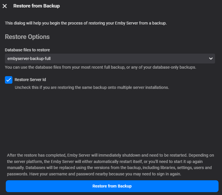

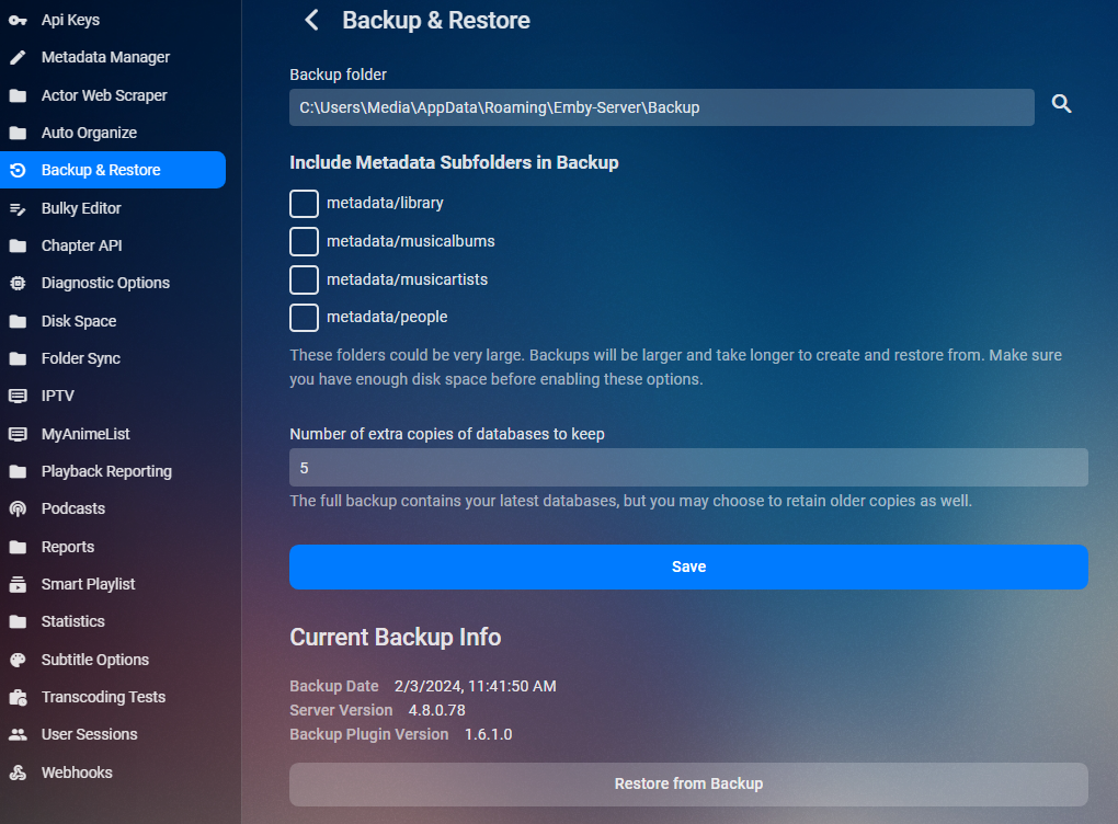

revengineer 142 Posted February 3, 2024 Posted February 3, 2024 Trying out the new version 4.8.0.80. So far so good. There are a few quirks, which I expected, so I am running on a beta server while keeping the stable server running v4.7 as a backup. I noticed that the Backup & Restore function has changed and it does not recognize my v4.7 backups. Can this be manually fixed so that I can import the configuration from my stable production emby into the beta server? Thanks for advice in advance.

Solution Luke 42289 Posted February 3, 2024 Solution Posted February 3, 2024 The revamped backup plugin is a complete backup process now, no longer a slice and dice of specific things which was problematic before. The 4.7 backups are not compatible. However if you look at the first post of the thread that was linked to, I captured the safe portions of the old backup plugin into a new legacy plugin that you can use with your 4.7 backups. 1

Neminem 1630 Posted February 3, 2024 Posted February 3, 2024 (edited) Well just tried that up against the beta docker build 4.8.0.78 and that only shows data to restore. It see users from old server and admin user on new server. So it seems that I only have an option to import to admin user of new server. And not all old server users. The dropbox is empty be sides from my admin user. Edited February 3, 2024 by jaycedk
Happy2Play 9814 Posted February 3, 2024 Posted February 3, 2024 (edited) Per the plugin name I will guess there is a compatibility issue. As it is a full database restore not a selective user restore with userdata mapping. Edited February 3, 2024 by Happy2Play
ebr 16354 Posted February 3, 2024 Posted February 3, 2024 15 minutes ago, jaycedk said: So it seems that I only have an option to import to admin user of new server. And not all old server users. Hi. With the legacy restore plugin you can only restore the user data not the users. So just recreate the users on the new server and then you can import their data.
