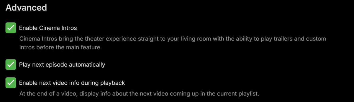

cochize1 55 Posted May 20, 2024 Author Posted May 20, 2024 @SrVirtual @Happy2Play @CarlosLima Coming back to an old thread... I can't seem to find a way to turn these 3 settings OFF by default in usersettingsbuilder.js file (can't even locate the option for the 'Play next episode automatically). Could use a little help from you guys, thanks.
Happy2Play 9811 Posted May 20, 2024 Posted May 20, 2024 7 hours ago, cochize1 said: @SrVirtual @Happy2Play @CarlosLima Coming back to an old thread... I can't seem to find a way to turn these 3 settings OFF by default in usersettingsbuilder.js file (can't even locate the option for the 'Play next episode automatically). Could use a little help from you guys, thanks. The second two are off by default. 1) disable cinemamode Quote UserSettings.prototype.enableCinemaMode = function (val) { return null != val ? this.set("enableCinemaMode", val.toString(), !1) : !(val = this.get("enableCinemaMode", !0)) || "false" !== val } 2) not sure where this is but disabled by default. But appear directly tied to User Config config.xml as the option is not cleared when cache is cleared. Requires restart if edited to reload user. Quote <EnableNextEpisodeAutoPlay>false</EnableNextEpisodeAutoPlay> 3) default disabled code Quote UserSettings.prototype.enableNextVideoInfoOverlay = function (val) { return null != val ? this.set("enableNextVideoInfoOverlay", val.toString()) : "false" !== (val = this.get("enableNextVideoInfoOverlay")) } So 2 would be a persistent config while 1 and 3 are cache configs per my understanding.
