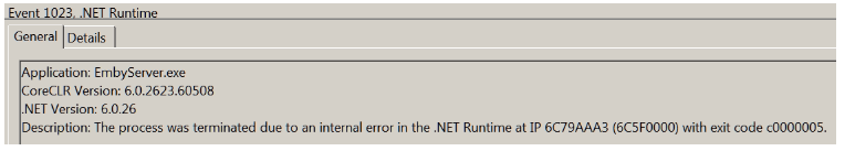

Freman 4 Posted February 3, 2024 Posted February 3, 2024 I've manually reinstalled Emby Server 4.8 & repaired .Net - same crash. When trying to open Emby on a device I only get part of the home page (the Home/Favourites top line and then just a spinning wait animation in the center) before the crash happens on the server. From the server console if I select 'Configure Emby' from the tray icon I will get the whole of the config web page then it crashes, and no links from the webUI will work. EmbyServer.txt 1

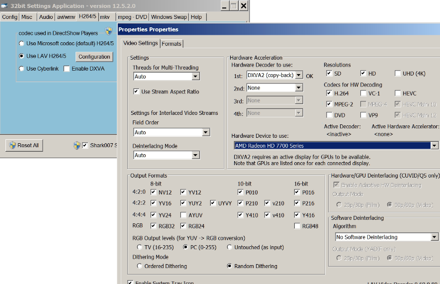

Freman 4 Posted February 4, 2024 Author Posted February 4, 2024 It's rarely transcoding, when it does I recongnise it due to the slightly longer time it takes to start the video and sometimes it stutters requiring me to pause the video for a few seconds (I usually give it up to a minute) to let it get going. Then it will either work to the end of the video (or it will stutter again - when I look at the Management WebUI the transcode will be running at less than the frame rate required - in that case I let Emby do a full side-by-side convert and watch the video another day). I have the use HW options set in the codec management program I use - Shark007. I do not know if HW is actually used or not.
softworkz 5135 Posted February 4, 2024 Posted February 4, 2024 Shark007 that was a codec pack, but I don't think it does HW coding. Can you show a screenshot (in case you reverted to the previous server) of the transcoding options page where you see shark007? I've never seen this
Freman 4 Posted February 4, 2024 Author Posted February 4, 2024 I've always assumed that the setting I've set via Shark007 for the decoders are used when Emby starts to transcode (the LAV Video & LAV Audio tray icons only appear when transcoding is happening)

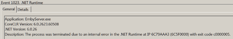

Happy2Play 9814 Posted February 4, 2024 Posted February 4, 2024 Best guess it will be something in netcore 6 as the lack of support .NET support for Windows 7 and 8.1 will end in January 2023 · Issue #7556 · dotnet/core · GitHub I can say that .net 6.0.10 works back on 4.8.0.21, but .net 6.0.26 crashes. So I would say probably EOL for Windows 7/8 and Emby moves forward with .NET.
softworkz 5135 Posted February 4, 2024 Posted February 4, 2024 8 minutes ago, Freman said: I've always assumed that the setting I've set via Shark007 for the decoders are used when Emby starts to transcode (the LAV Video & LAV Audio tray icons only appear when transcoding is happening) Those setings are unrelated to Emby Server. I assume the client is on the same machine? What I was asking about is hwa a on Emby Server.

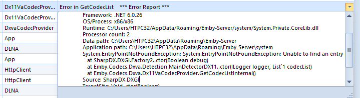

softworkz 5135 Posted February 4, 2024 Posted February 4, 2024 6 minutes ago, Happy2Play said: Yes Okay, then it was just coincidental that hw detection wasn't finished yet Same for this error: Which can probably be fixed by installing the DirectX 11.1 update for Windows 7 (https://support.microsoft.com/en-us/topic/platform-update-for-windows-7-sp1-and-windows-server-2008-r2-sp1-d97da9ca-c15c-b21f-ebb0-838f7be8d9f6). The good news though, is that I don't see any reason why it couldn't work with the older net6 runtime. Those revisions have just fixes but no incompatible changes. So chances are not bad that you can get it working by replacing the .net runtime files.

Happy2Play 9814 Posted February 4, 2024 Posted February 4, 2024 8 minutes ago, softworkz said: Let's test @Happy2Play's theory! Here's a version of 4.8.80 with the net 6.0.9 runtime files: system.zip (replace the contents of your system folder with this) Hmm Still crashes. Application: EmbyServer.exe CoreCLR Version: 6.0.922.41905 .NET Version: 6.0.9 Description: The process was terminated due to an internal error in the .NET Runtime at IP 60FA4778 (60DE0000) with exit code c0000005. I know the old beta 4.8.0.21still works if I restore it.

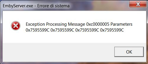

MaxDev433 5 Posted February 4, 2024 Posted February 4, 2024 Hello everyone, I confirm the same problem and error in log and event viewer with version 4.8 and Windows 7 x86 updated. A clean installation doesn't solve the problem, but by installing the latest 4.7.x everything works but I don't have time to block the updates and the first time I restart Emby it updates and stops. Regards. 2
