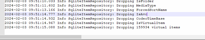

Nostromo86 17 Posted February 3, 2024 Posted February 3, 2024 Helllo I launched the update 30 minutes ago and my server does not start. you will find the logs in pj. Should we wait? How can I see if the server is doing something? Help Thx log.txt 1
jameskitt616 9 Posted February 3, 2024 Posted February 3, 2024 I've got the same issue on ubuntu. It just sit's there and shows "Emby Server is loading. Please try again shortly."
pdeliot 10 Posted February 3, 2024 Posted February 3, 2024 Having a look to the log show that database update looks running... It looks to be in a phase dropping a lot of object.. maybe it can take long time. If I were you I would wait. Maybe you could check in the task manager if CPU or disc load is high.. If they are, it would means that "something is in progress".
Nostromo86 17 Posted February 3, 2024 Author Posted February 3, 2024 12 minutes ago, pdeliot said: Having a look to the log show that database update looks running... It looks to be in a phase dropping a lot of object.. maybe it can take long time. If I were you I would wait. Maybe you could check in the task manager if CPU or disc load is high.. If they are, it would means that "something is in progress". Hi Thank you for your response but nothing has changed see attchment

Solution ebr 16354 Posted February 3, 2024 Solution Posted February 3, 2024 Hi. I think you guys just need to be a little bit patient on the first start up. The new version will do some conversions to your database and, depending on how big and the exact contents and options, this could take a few minutes.

Nostromo86 17 Posted February 3, 2024 Author Posted February 3, 2024 2 hours ago, ebr said: Hi. I think you guys just need to be a little bit patient on the first start up. The new version will do some conversions to your database and, depending on how big and the exact contents and options, this could take a few minutes. Thanks for your response. But I waited 2 hours and I didn't see anything changing. Do you perhaps have a tip for seeing the treatments in progress live, please?
