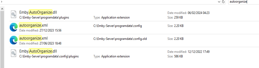

Luke 42288 Posted February 8, 2024 Posted February 8, 2024 6 minutes ago, AaronClarke said: Sorry Luke... was just fetching it... took a while to upload embyserver.txt 17.3 MB · 0 downloads Strange. Try shutting down the server and deleting your autoorganize database from C:\Emby-Server\programdata Then start back up and see if those sqlite errors happen again.
AaronClarke 3 Posted February 8, 2024 Posted February 8, 2024 I can't find a database called AutoOrganize... Is called something else?
Luke 42288 Posted February 8, 2024 Posted February 8, 2024 Sorry, the folder is C:\Emby-Server\programdata\data
AaronClarke 3 Posted February 8, 2024 Posted February 8, 2024 I found fileorganization.db and removed that... Restarted the server and now they are being organised. Thanks. Do you know why that was happening?
Luke 42288 Posted February 8, 2024 Posted February 8, 2024 14 minutes ago, AaronClarke said: I found fileorganization.db and removed that... Restarted the server and now they are being organised. Thanks. Do you know why that was happening? The plugin has changed it's database layout over the years and at some point the upgrade must not have been done correct. That and/or if you ever went back and forth from newer to older versions of the plugin, that can cause things like this.

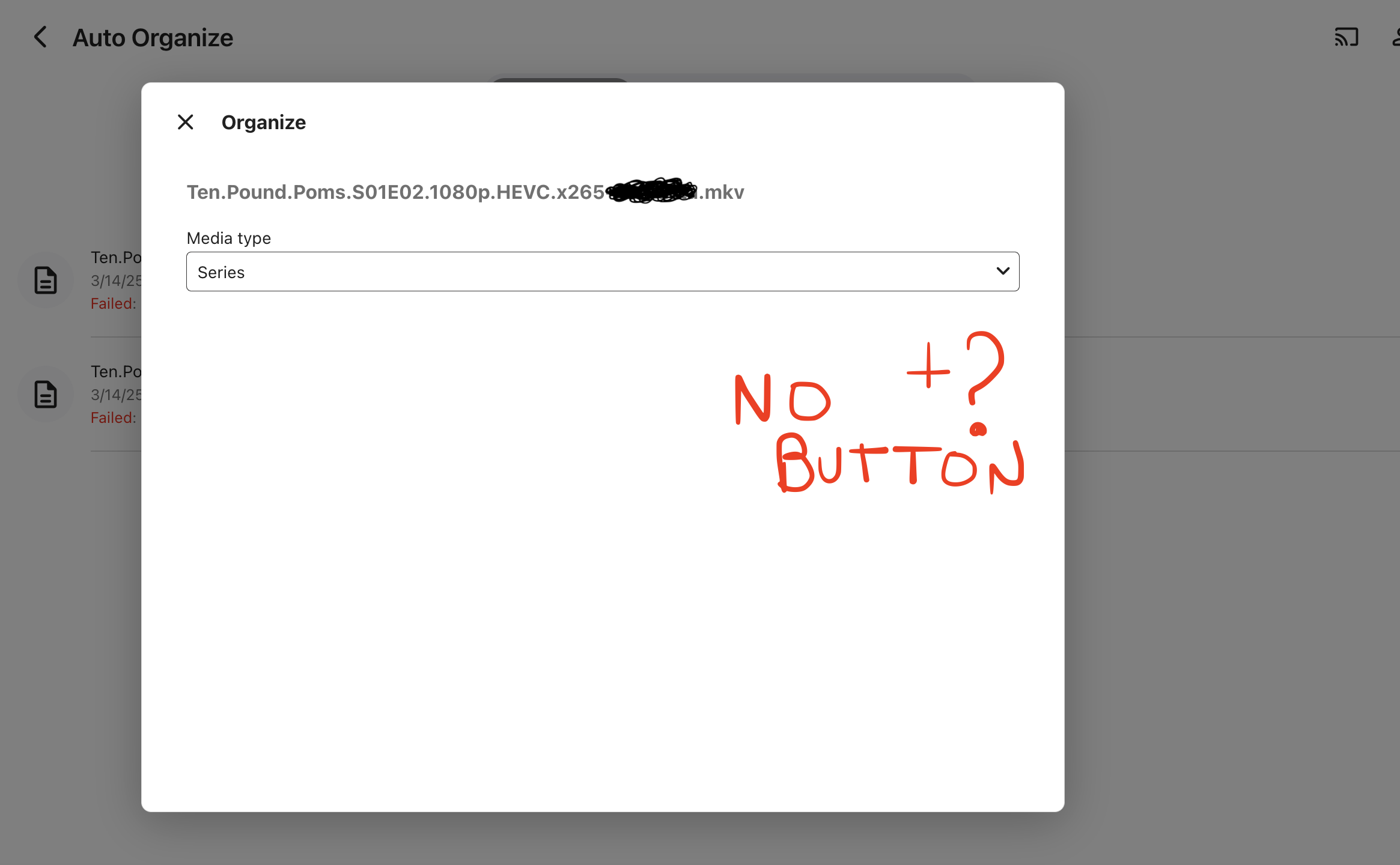

blakeusblade 4 Posted March 14, 2025 Posted March 14, 2025 I'm experiecing this issue too... Not only does it not identiy the show but the interface no longer has the + / Plus button to add a new show. Preventing adding a new show to the collections... Running Emby 4.8.11.0 with auto orgnaise (latest)
Luke 42288 Posted March 15, 2025 Posted March 15, 2025 17 hours ago, blakeusblade said: I'm experiecing this issue too... Not only does it not identiy the show but the interface no longer has the + / Plus button to add a new show. Preventing adding a new show to the collections... Running Emby 4.8.11.0 with auto orgnaise (latest) Hi @blakeusbladehave you setup any libraries using the tv shows content type?
