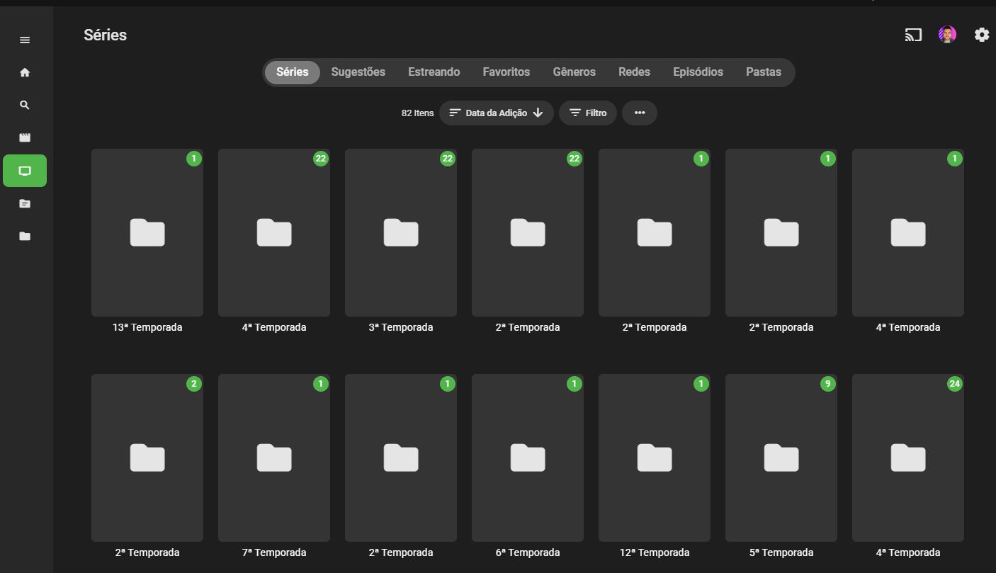

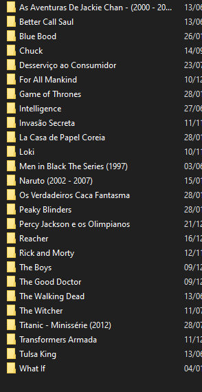

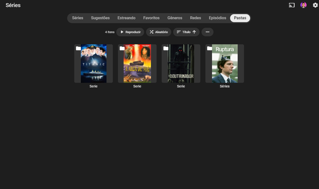

Daniel R. Mebs 6 Posted February 3, 2024 Posted February 3, 2024 I'm using Google Translate so forgive me for my English. Tonight when I went to open Emby to watch my TV Shows I found my library in this state and when I went to the folder structure I came across only 4 folders and my files are named on my computer like this (program name) > (season ) > (Episodes) But for some reason this happened in the last emby update. I would like to know if it is a bug due to the update. And whether it will be corrected. This is a very frustrating experience, I have been using emby for 6 years (since 2018) and have never had a problem that gave me this headache. And now that I got a job, I was thinking about paying for the Emby Premiere to have other roles, but that discouraged me a little. Again I apologize for my English. And I hope someone can help me understand what happened
Daniel R. Mebs 6 Posted February 3, 2024 Author Posted February 3, 2024 Edit: I don't think it's important but I think I should add the information. Because these episodes consume a lot of storage, I have them distributed across several hard drives, and networked hard drives as well. But I've always used it this way and in these 6 years I've never had any problems doing it this way. I tried to add the new image for greater understanding but I got error 200 when trying to upload the photos. I'll try to post it as a reply to the topic
Daniel R. Mebs 6 Posted February 3, 2024 Author Posted February 3, 2024 Years of meticulously organizing With personalized images for my library to look like this. Sorry for my frustration. I don't want to blame anyone, I just want you to help me understand how to solve this. I doubt I'm the only person going through this.
Luke 42184 Posted February 3, 2024 Posted February 3, 2024 Hi, question, Is it normal in Portuguese to have: 1ª temporada Instead of just 1 temporada This is the reason for the problem, at least for those examples.
trekflix 5 Posted February 3, 2024 Posted February 3, 2024 All seasons in Portuguese I use 1ª, 2ª... I've always used it and it's never had a problem like that.
Luke 42184 Posted February 3, 2024 Posted February 3, 2024 Is it just ª or are there any other characters like that?
trekflix 5 Posted February 3, 2024 Posted February 3, 2024 when it's a season (season in Portuguese) it's grammatically feminine. So 'A' is used (first = 1ª). If it were masculine (for example the word episode) it would be 'O' (first = 1º)
Luke 42184 Posted February 3, 2024 Posted February 3, 2024 OK thanks. This issue is due to the season folders not being recognized due to that character. We'll have this resolved in the 4.8.1 maintenance release. If there are other examples along these lines please let us know. Thanks.
Daniel R. Mebs 6 Posted February 3, 2024 Author Posted February 3, 2024 28 minutes ago, Luke said: Hi, question, Is it normal in Portuguese to have: 1ª temporada Instead of just 1 temporada This is the reason for the problem, at least for those examples. So all the seasons in my libraries have always been renamed in Portuguese with the ª which would be with the 1 st 2 nd in English and I never had any problems with that
Luke 42184 Posted February 3, 2024 Posted February 3, 2024 The reason why it was working before is that the server was just looking for the first number it could find and ignoring everything else. However this also leads to inaccurate detections in some cases, so now things are a little more strict in 4.8 and it's only looking for certain conventions. And this character: ª is not in the list of what it's looking for. So we'll get this resolved in 4.8.1. Thanks.
Daniel R. Mebs 6 Posted February 3, 2024 Author Posted February 3, 2024 9 minutes ago, Luke said: Okey obrigado. Esse problema se deve ao fato de as pastas da temporada não serem reconhecidas devido a esse personagem. Teremos isso resolvido na versão de manutenção 4.8.1. Se houver outros exemplos nesse sentido, por favor, nos avise. Obrigado. I went to sleep for a while but woke up. I responded as I read. But I'm here to thank you for your answers. I hope you get this fix soon, thanks for your attention. 1
Daniel R. Mebs 6 Posted February 3, 2024 Author Posted February 3, 2024 5 minutes ago, Luke said: The reason why it was working before is that the server was just looking for the first number it could find and ignoring everything else. However this also leads to inaccurate detections in some cases, so now things are a little more strict in 4.8 and it's only looking for certain conventions. And this character: ª is not in the list of what it's looking for. So we'll get this resolved in 4.8.1. Thanks. ok thanks for the clarification. I hope everything returns to normal soon. I did the test, took a newly added folder and renamed the folder to "season1" and it fixed it. But just thinking about having to modify more than 267 folders gives me a headache LOL 1
Daniel R. Mebs 6 Posted February 3, 2024 Author Posted February 3, 2024 34 minutes ago, Luke said: OK thanks. This issue is due to the season folders not being recognized due to that character. We'll have this resolved in the 4.8.1 maintenance release. If there are other examples along these lines please let us know. Thanks. To rename the episodes themselves we use S01E02 instead. T01E02. S = Season T= Temporada | E = Episode in portuguese = "Episódio" so no problem. We use the character "ª" in the sense that if "1 temporada" were added, it would sound like "One Season" in English. Adding the "ª" In addition to being grammatically correct in my language, in English it would be like "First Season" "Second Season (2ª)" and so on 1

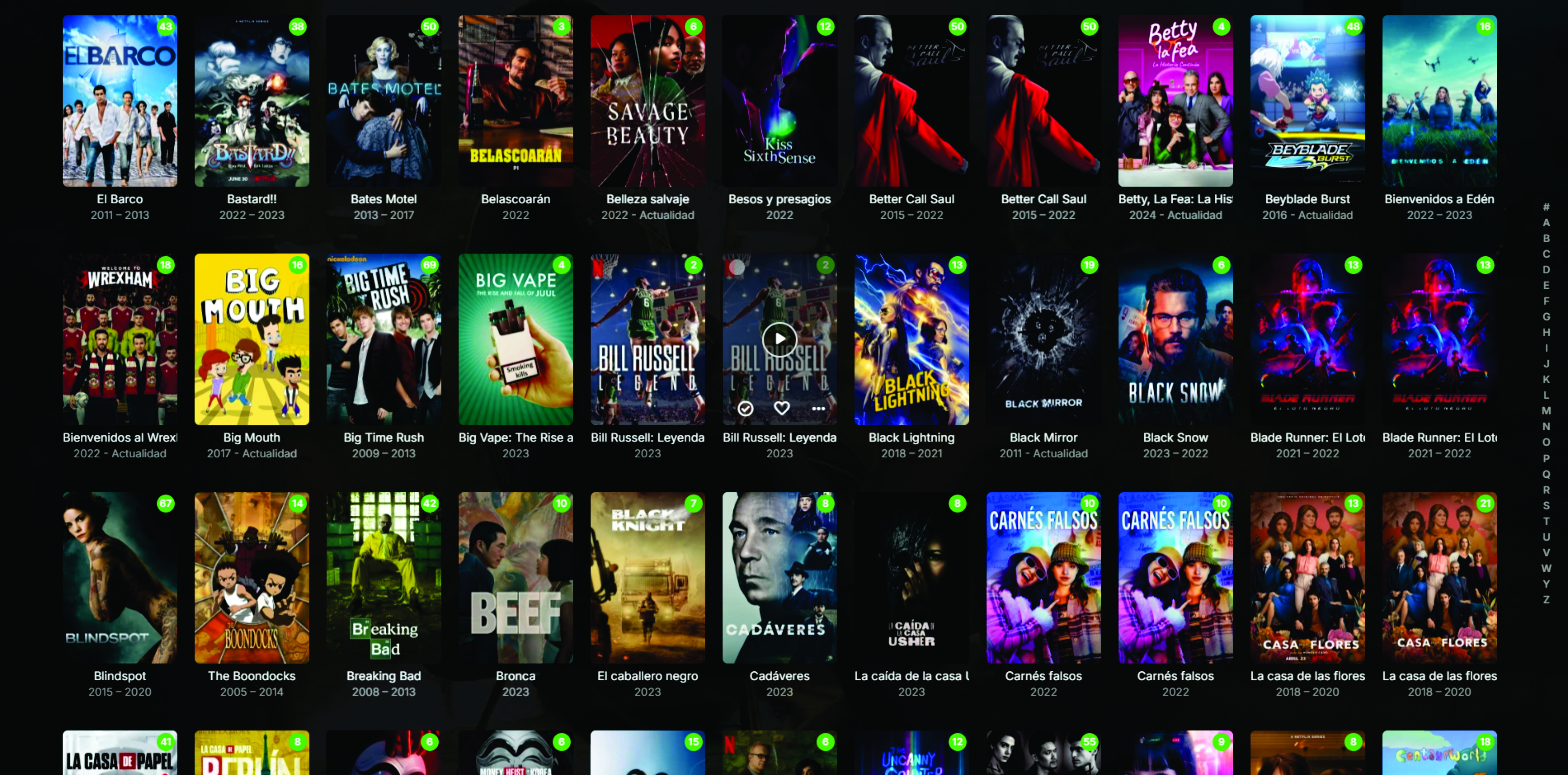

zhura 0 Posted July 30, 2024 Posted July 30, 2024 hola buenas tardes a mi me esta duplicando mi contenido.tengo varios discos duros, y aveces no se si ya tengo una serie y la vuelvo a descargar , siempre se juntaba una con otra asi que no tenia problema despues de que actualice al 4.8.0.80 se me hicieron duplicados de las carpetas y cada una es de un disco diferente . agradeceria si pudieran solucionarlo muchas gracias

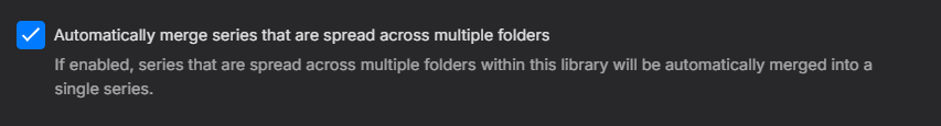

Happy2Play 9798 Posted July 30, 2024 Posted July 30, 2024 9 minutes ago, zhura said: This is the image of the above What server version are you? Are the paths for each duplicate the same? right click-edit metadata How are you libraries organized? And library setup? But if you have duplicates within your library per multiple folders in that library you probably want to enable the merge option or delete your duplicates. But would say this is normal if you actually duplicated your media.
zhura 0 Posted August 1, 2024 Posted August 1, 2024 esa opcion donde aparece=? pues normal tengo organizado ejemplo: carpeta series: dark: carpeta temporada 1: S01E01 ,S01E02 Y ASI siempre los e acomodado asi en ese orden los nombres coinciden entre las versiones que tengo, no habia tenido problemas con eso hasta esta actualizacion. tengo la version nueva que esta en la pagina.
zhura 0 Posted August 1, 2024 Posted August 1, 2024 oh ya vi donde es. pero es que lo tengo en una carpeta que dice contenido mixto y ahi no me aparece esa opcion pero siempre lo e tenido asi y no habia tenido problemas
Luke 42184 Posted August 6, 2024 Posted August 6, 2024 On 8/1/2024 at 7:24 PM, zhura said: esa opcion donde aparece=? pues normal tengo organizado ejemplo: carpeta series: dark: carpeta temporada 1: S01E01 ,S01E02 Y ASI siempre los e acomodado asi en ese orden los nombres coinciden entre las versiones que tengo, no habia tenido problemas con eso hasta esta actualizacion. tengo la version nueva que esta en la pagina. Hi, they are in the settings for your TV library in Emby library setup. Have you checked there?
