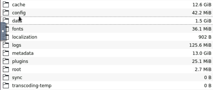

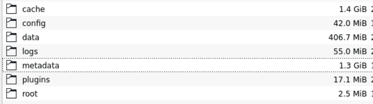

vaise 340 Posted February 10, 2024 Author Posted February 10, 2024 Just back to this - so I have my shiney new prod server, which is all working and all images and metadata is there that I can see. What I am astounded by is the appdata space this will be saving. The weekly emby appdata backup with be 10 times quicker and hence 10 times less emby outage. A 10 times lower size. This is the beta server - that has been the same since the beta's first started many many years ago : And this is the new prod server - only lightly used so far - but all is there and working over the exact same libraries: Over the years I guess there has been loads of crap added and never removed ? And notice the difference in folders - some are not there in the new prod server. Note - transcode and conversions are mapper to the array outside of the appdata. The cache and metadata seems to be the major size differences. Is this as more stuff been moved to the database over the years ? Could I expect the cache to keep growing like that (I have the new cache images turned off) If this is normal - they there is a benefit in all doing a new prod server install and porting across to it.

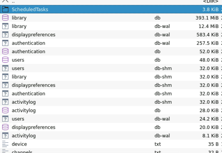

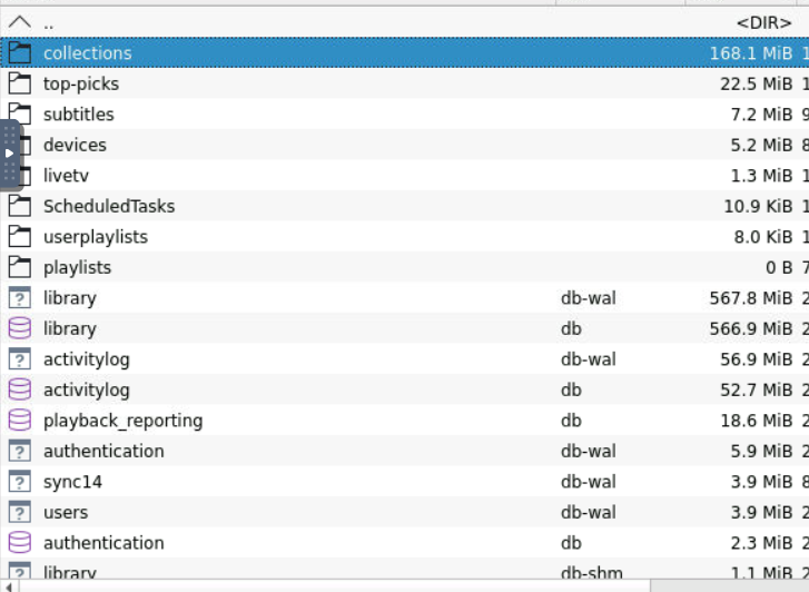

vaise 340 Posted February 10, 2024 Author Posted February 10, 2024 I have had a poke around and all images when it click around on the prod new system are there. Not sure which comes down on use - unless its so fast I cant see it. My images are stored with the media on both systems. Re data folder : Beta server - sorted by files size : Prod server sorted by size :
