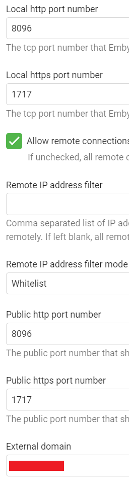

I'm migrating from a Synology Emby instance to a Windows Emby instance. The migration went great so far, all settings appear to have been restored successfully. However, I'm unable to update the remote port or protocol.
The remote protocol should be https and the port should be 1717 as I have in the config.
I've also reviewed my system.xml and found the settings to be correct there as well.
My concern is less about what the UI is reflecting but more about the connection not coming through.
At this point I'm just testing locally and my Windows Firewall is disabled.
I'll leave some screenshots below, thanks all!!

Is your SSL certificate path and/or password valid? Do you have "Secure connection mode" Required or Preferred or Handled by RP?

Thanks so much for your response! You nailed it, ended up being the password for the PFX, I feel like an idiot. 😒(need more coffee)
After removing the type-o in the password and rebooting Emby all is live and well.
