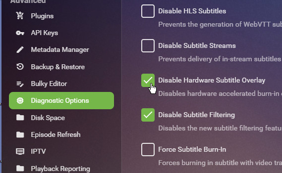

pwhodges 2023 Posted January 30, 2024 Posted January 30, 2024 16 hours ago, RanmaCanada said: I think it might be that ffmpeg does prefer Intel, as I don't believe NVENC can hard sub at all while quicksync can I'm so not sure about this. I can switch on the diagnostics option to burn in subs using hardware, and it works (I just once had it fail - perhaps that's why it's still not enabled in the mainstream). My system is not using quicksync, just NVENC. Paul
solidsnakex37 55 Posted January 30, 2024 Author Posted January 30, 2024 3 minutes ago, pwhodges said: I can switch on the diagnostics option to burn in subs using hardware What setting in Diagnostic Options are you referring to?
pwhodges 2023 Posted January 30, 2024 Posted January 30, 2024 It's expressed the other way round: "Disable Hardware Subtitle Overlay" - default setting is on, setting to off doesn't survive restart. I've also used "Force Subtitle Burn-In" to see subs which weren't otherwise shown (in the past - but not for a long time). Paul
solidsnakex37 55 Posted January 30, 2024 Author Posted January 30, 2024 9 minutes ago, pwhodges said: It's expressed the other way round: "Disable Hardware Subtitle Overlay" - default setting is on, setting to off doesn't survive restart. I've also used "Force Subtitle Burn-In" to see subs which weren't otherwise shown (in the past - but not for a long time). Paul Thanks Paul! I see that's a 4.8 setting, I will play around with these settings in my test server and see. That force sub burn in might also be a good option to test too, I appreciate your input on this.
pwhodges 2023 Posted January 30, 2024 Posted January 30, 2024 4.8 has many improvements in subtitle handling (as, in its turn, did 4.7), even without the diagnostic options. I hope that the hardware burn-in can be moved to the mainstream in the next beta round. Paul
