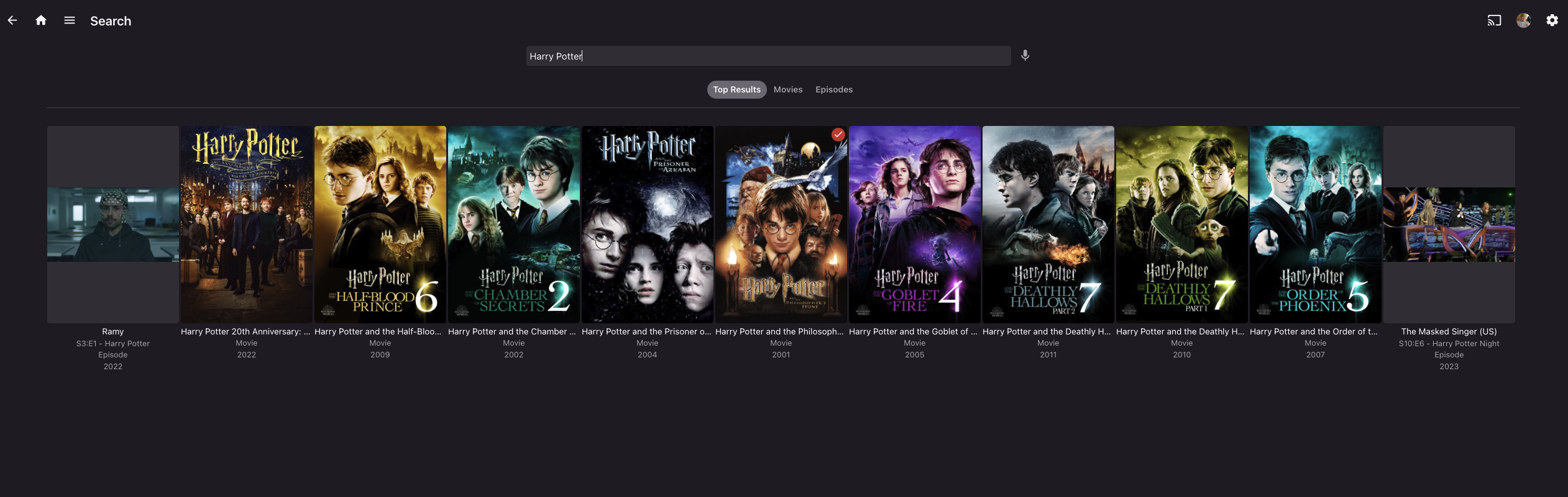

OSBuckeyes4Life 12 Posted January 25, 2024 Posted January 25, 2024 I see a ton of content on the internet but no one has had a fix for it. I have Emby installed on a Dell R720 (48Core, 125GiB Ram running Linux 6.5.11-7 and using Proxmox. My container that I buildt is from here: https://github.com/tteck/Proxmox/blob/main/install/emby-install.sh Here appears to be the issue. AutoBox sets clearly has been disabled, I see the note. I even tried to install an older version just to run it but it does not add the extra option into the Library options so it doesn't do anything. In the logs I am seeing the following error: 2024-01-25 10:54:05.909 Info LibraryMonitor: Skipping realtime monitor for /var/lib/emby/data\collections because the path is currently not available root@emby:/var/lib/emby/data# ls -l total 533516 drwxr-xr-x 2 emby emby 4096 Dec 18 15:56 ScheduledTasks -rw-r--r-- 1 emby emby 200704 Jan 25 10:54 activitylog.db -rw-r--r-- 1 emby emby 32768 Jan 25 10:54 activitylog.db-shm -rw-r--r-- 1 emby emby 0 Jan 25 10:54 activitylog.db-wal -rw-r--r-- 1 emby emby 409600 Jan 25 10:54 authentication.db -rw-r--r-- 1 emby emby 32768 Jan 25 11:03 authentication.db-shm -rw-r--r-- 1 emby emby 98912 Jan 25 11:03 authentication.db-wal -rw-r--r-- 1 emby emby 32 Jan 24 10:56 channels.txt -rw-r--r-- 1 emby emby 131 Jan 15 01:31 connect.txt -rw-r--r-- 1 emby emby 35 Dec 18 15:29 device.txt -rw-r--r-- 1 emby emby 155648 Jan 25 10:39 displaypreferences.db -rw-r--r-- 1 emby emby 32768 Jan 25 10:54 displaypreferences.db-shm -rw-r--r-- 1 emby emby 0 Jan 25 10:54 displaypreferences.db-wal -rw-r--r-- 1 emby emby 8 Dec 18 15:29 lastversion.txt -rw-r--r-- 1 emby emby 540868608 Jan 25 11:03 library.db -rw-r--r-- 1 emby emby 32768 Jan 25 11:04 library.db-shm -rw-r--r-- 1 emby emby 4132392 Jan 25 11:04 library.db-wal -rw-r--r-- 1 emby emby 176128 Jan 25 11:04 playback_reporting.db drwxr-xr-x 11 emby emby 4096 Jan 14 15:06 playlists -rw-r--r-- 1 emby emby 28672 Jan 25 10:50 users.db -rw-r--r-- 1 emby emby 32768 Jan 25 11:03 users.db-shm -rw-r--r-- 1 emby emby 16512 Jan 25 11:03 users.db-wal -rw-r--r-- 1 emby emby 23 Dec 18 15:29 wan.dat Ok makes sense that folder does not exist. But even when I create that folder, it still gives me that error. Now, my movies/tvshows whatnot are saved on a Synology. Yes, Linux has access and has been granted the RWX access to the Synology hence my libraries being scanned and this log is looking on the filesystem anyways. When I recycle the server, you always see the same as above. 2024-01-25 11:18:03.144 Info LibraryMonitor: Skipping realtime monitor for /var/lib/emby/data\collections because the path is currently not available Any assistance would be greatly appreciated. embyserver (1).txt embyserver.txt

OSBuckeyes4Life 12 Posted January 26, 2024 Author Posted January 26, 2024 Sorry for spending hours trying to help assist in making this a smoother process for Linux users. This has clearly been an issue for multiple years and the best Emby devs can’t seem to figure it out . I’m a longtime user of Emby and have pushed many users to it, sarcasm or not I’m trying to be a good community member and figure out what the problem is. I can create collections yes. Manually they create BUT, it doesn’t actually add a collections folder. The logs are not showing what it’s actually doing? Out of curiosity, why isn’t collections a file path that can be prefilled by the user? Everything else is.

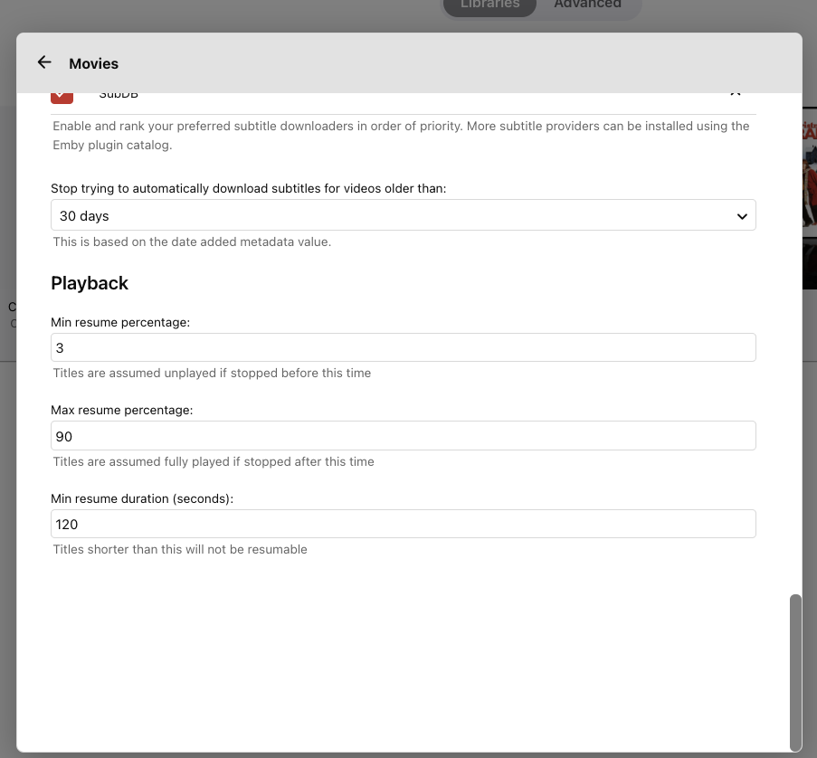

Luke 42244 Posted January 26, 2024 Posted January 26, 2024 Quote isnt collections suppose to be automatic? Yes, but this comes more from focusing on the movies rather than the collections. The collection info comes attach to the movie metadata that comes from MovieDb. From your screenshots it appears you have everything enabled, but was it enabled before you imported the library?
OSBuckeyes4Life 12 Posted January 26, 2024 Author Posted January 26, 2024 Yes, I validated that. From online I also did a refresh of metadata based on your past posts. That did not show me the folder neither. going back to a comment earlier, I did respite from a Windows backup, BUT that folder still exists. (See screenshots above.) I also copied that folder to the location and still nada. I don’t mind being a test bunny, maybe I could copy all Harry Potter movies to a folder and add the library? See if it creates a collection automatically?

OSBuckeyes4Life 12 Posted January 26, 2024 Author Posted January 26, 2024 (edited) No I understand what you are saying. Im trying to make the refresh not take 5-50 hours and puts days in between this great conversation. I want to know what the heck is going on!!! ok so I created a folder called test. In test I have 5 harry potter movies. I added New Library, Movies, Added test folder location, English preferred metadata, country United States, Preferred Image English, Metadata Readers "NFO" checked, Movie Metadata Downloaders: TheMovieDb checked and The Open Movie Database checked, Minimum Collection Size 2, After Import Never, Metadata Savers NFO checked, Movie Image Fetchers TheMovieDb, The Open Movie Database, FanArt Checked, Video Preview Thumbnails as task when media is added, Subtitles English blah blah. Ok added I immediatly see the error: 2024-01-25 21:49:11.184 Error BaseItem: Error validating children for data\collections 474 /var/lib/emby/data\collections *** Error Report *** Version: 4.7.14.0 Command line: /opt/emby-server/system/EmbyServer.dll -programdata /var/lib/emby -ffdetect /opt/emby-server/bin/ffdetect -ffmpeg /opt/emby-server/bin/ffmpeg -ffprobe /opt/emby-server/bin/ffprobe -restartexitcode 3 -updatepackage emby-server-deb_{version}_amd64.deb Operating system: Linux version 6.5.11-7-pve (build@proxmox) (gcc (Debian 12.2.0-14) 12.2.0, GNU ld (GNU Binutils for Debian) 2.40) #1 SMP PREEMPT_DYNAMIC PMX 6.5.11-7 Framework: .NET 6.0.20 OS/Process: x64/x64 Runtime: opt/emby-server/system/System.Private.CoreLib.dll Processor count: 46 Data path: /var/lib/emby Application path: /opt/emby-server/system System.IO.DirectoryNotFoundException: System.IO.DirectoryNotFoundException: Could not find a part of the path '/var/lib/emby/data\collections'. at System.IO.Enumeration.FileSystemEnumerator`1.CreateDirectoryHandle(String path, Boolean ignoreNotFound) at System.IO.Enumeration.FileSystemEnumerator`1.Init() at System.IO.Enumeration.FileSystemEnumerable`1..ctor(String directory, FindTransform transform, EnumerationOptions options, Boolean isNormalized) at System.IO.Enumeration.FileSystemEnumerableFactory.FileSystemInfos(String directory, String expression, EnumerationOptions options, Boolean isNormalized) at System.IO.DirectoryInfo.InternalEnumerateInfos(String path, String searchPattern, SearchTarget searchTarget, EnumerationOptions options) at Emby.Server.Implementations.IO.ManagedFileSystem.GetFileSystemEntries(String path, Boolean recursive) at MediaBrowser.Controller.Providers.DirectoryService.GetFileSystemEntries(String path, Boolean clearCache) at MediaBrowser.Controller.Entities.Folder.GetNonCachedChildren(IDirectoryService directoryService, LibraryOptions libraryOptions) at MediaBrowser.Controller.Entities.Folder.ValidateChildrenInternal(IProgress`1 progress, CancellationToken cancellationToken, Boolean recursive, Boolean refreshChildMetadata, MetadataRefreshOptions refreshOptions, IDirectoryService directoryService) at MediaBrowser.Controller.Entities.Folder.ValidateSubFolders(BaseItem[] children, IDirectoryService directoryService, IProgress`1 progress, CancellationToken cancellationToken) Source: System.Private.CoreLib TargetSite: IntPtr CreateDirectoryHandle(System.String, Boolean) embyserver.txt Edited January 26, 2024 by OSBuckeyes4Life
