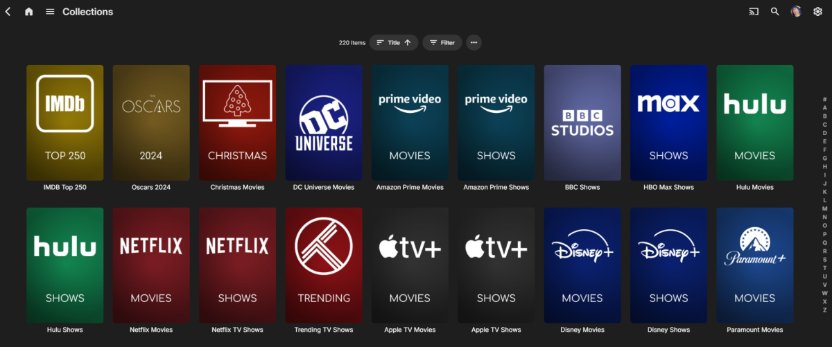

rbjtech 5341 Posted November 15, 2024 Posted November 15, 2024 (edited) On 10/11/2024 at 23:07, Amything said: Can use local path or url. https://plexcollectionposters.com/ seems to be a good source. Know any others? I found the original Kometa (previously PMM) images on github - It's a bit cheeky to use them, I'd like to get the OK from the author but they are open source .. Currently I've just cloned the repo and thus have all the images local that I reference. (1000's of them !) btw - for Windows users in the config file it's :- poster = D:\Kometa\seasonal\christmas.jpg Note - no quotes, so no spaces will likely be allowed in the file path, nor file name unless python is space friendly.. ? Edited November 15, 2024 by rbjtech 2

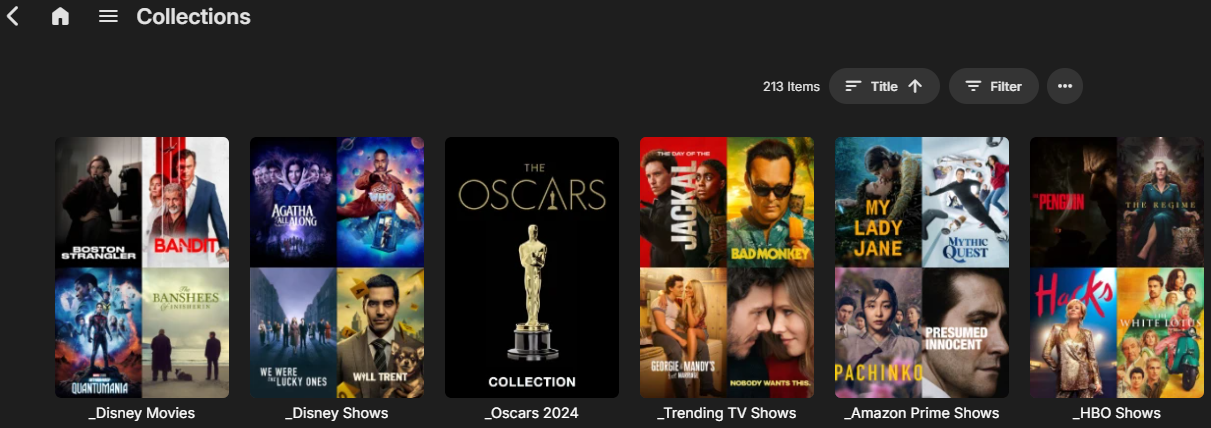

rbjtech 5341 Posted November 15, 2024 Posted November 15, 2024 (edited) It's starting to come together - the uniform images make it all look SOOOO much nicer (and easier to find stuff) .. Edited November 15, 2024 by rbjtech
hthgihwaymonk 34 Posted November 15, 2024 Posted November 15, 2024 3 hours ago, rbjtech said: It's starting to come together - the uniform images make it all look SOOOO much nicer (and easier to find stuff) .. uniform images with collections is the only way to go, glad you got is going 1
