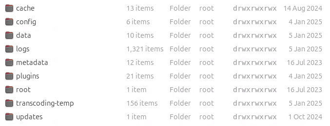

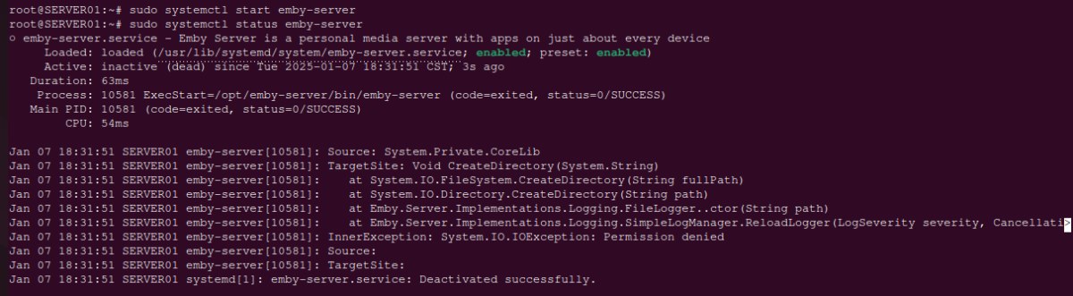

I am having this same issue on Ubuntu 24.04 LTS.  UFW is disabled.  What logs/data can I provide to assist in troubleshooting? Thank you.image.thumb.png.db53483fdd18539935698df6066f0829.png

Hi @TheKrizzzis this a brand new install of emby server?
Thanks for your response.  No, I did the original install and it looked good.  I ran the basic setup wizard and then started copying my backup data from my original Windows Emby build into the corresponding Linux directories.  This blew it up.  I ran:
sudo apt-get purge emby-server
 Then rebooted.
I ran the install again, but the service seems to stop immediately.  And if I look for the
/var/lib/emby
 directory, where I copied my backup files,, it does not exist on the system.  Also mentioned in this thread.

2 hours ago, TheKrizzz said:
/var/lib/emby
If the path is gone then so are the config and data files for the Emby server. And if the server can't create new config files and data then it can't start. Hence the errors you see from systemd.

I'm a Linux n00b and not really sure how I can fix that.  I ran the installer as root using this command.
dpkg -i emby-server-deb_4.8.10.0_amd64.deb
Any advice is appreciated.
Q-Droid
Installing Emby creates the emby user, group and the /var/lib/emby directory so if it's gone that's likely something you did after the fact.
If you're sure that /var/lib/emby is not there then I would uninstall the Emby package then delete the emby user. This would force the installer to recreate the user and the home path /var/lib/emby the next time you install the software.

This hit the nail on the head!  I didn't realize that the purge command left the emby user and that was exactly what was holding up the reinstall.  After I removed it, the install worked beautifully.  Thank you!
