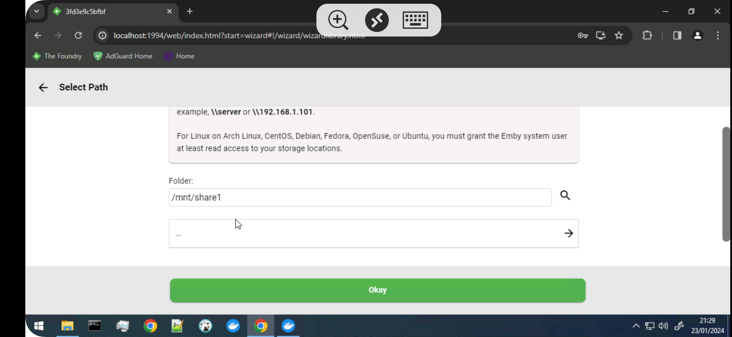

plawl94 9 Posted January 23, 2024 Author Posted January 23, 2024 (edited) @LukeWhen I run docker-compile and access the server I can see the mounts listed when adding a library (mnt/share1 for example) but upon selecting the mount the folder is empty Edited January 23, 2024 by plawl94
Luke 42184 Posted January 23, 2024 Posted January 23, 2024 4 minutes ago, plawl94 said: @LukeWhen I run docker-compile and access the server I can see the mounts listed when adding a library (mnt/share1 for example) but upon selecting the mount the folder is empty Selecting it how/where?
plawl94 9 Posted January 23, 2024 Author Posted January 23, 2024 4 minutes ago, Luke said: Selecting it how/where? When trying to add a new library, the result is the same if I try to set up media libraries through the initial setup process or if I skip through and try to add them from the server management menu. I've attached a screenshot of what I see when selecting the mnt/share1:
Luke 42184 Posted January 23, 2024 Posted January 23, 2024 This would suggest the server does not have access to the contents of the folder. If you can resolve that, then you should see it populated.
plawl94 9 Posted January 24, 2024 Author Posted January 24, 2024 8 hours ago, Luke said: This would suggest the server does not have access to the contents of the folder. If you can resolve that, then you should see it populated. Hey Luke, Anything in particular you think it may be? Thanks, Pete
