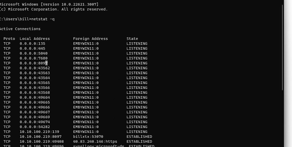

shackbill 22 Posted January 22, 2024 Posted January 22, 2024 I setup SSL in early December and arbitrarily set port 8920 as the https port. I have a DDNS name mapped to my external address and everything seemed to work for a while. I have my mode set to Preferred but not required since i wanted to test this for a while. A couple weeks ago i noticed i could no longer connect SSL. The cert is still good i am just not getting a connection. scratching my head i checked everything i could think of firewall, rules, etc. Today i did a netstat on the emby server and i dont see anything listening on that port. Also, in the log an error shows ' Error Loading Cert from...' but yet it is there located on the c Drive. WOuld a bad or unloadable pfx file prevent the service from at least running? I dont see any disk permission issues. Also, dashboard show 'Running on port 8097' for http but nothing for https. Any idea why this service is not running would be helpful thanks. Log.txt

Solution Q-Droid 1002 Posted January 22, 2024 Solution Posted January 22, 2024 I don't know which .bat you're using but you should avoid using certain symbol characters in the passphrase because they can be evaluated by the interpreter running the script. Plain characters (upper/lower/numbers) should be more than enough for the cert files.
shackbill 22 Posted January 22, 2024 Author Posted January 22, 2024 yup i just figured that out. doesnt like special characters. Ran another with just a weak password and its fine now thanks. Now i gotta figure out how to make my fqdn work right?? i have DDNS with asus for my domain.com but i am trying to forward to emby.domain.com so i get bad cert now?
