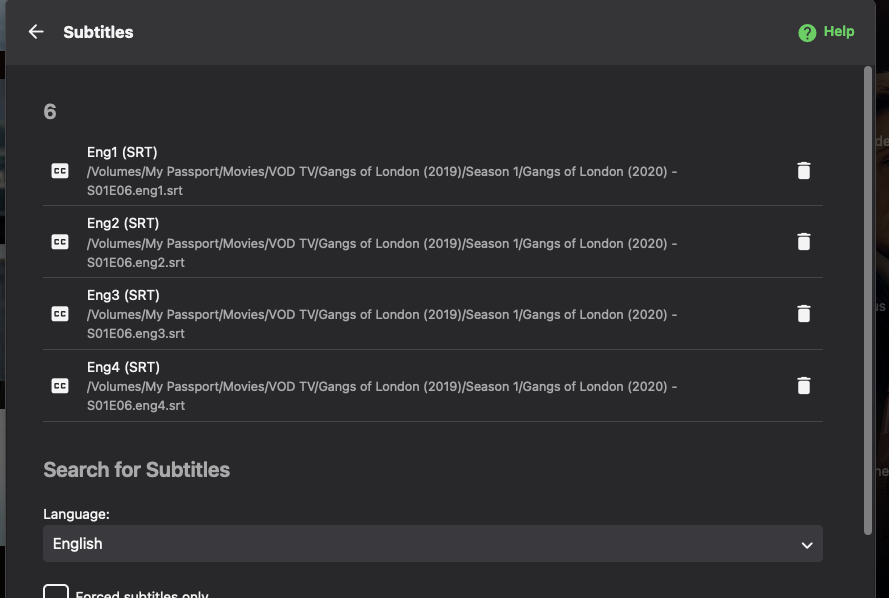

sundevil67 30 Posted January 23, 2024 Posted January 23, 2024 I created an account on opensubtitles.com, and even downloaded the Addi7ed.com plugin & created an account there (though I have no idea how to use it), but nothing seems to work & I still can't download subtitles. I'm wondering if it might be in part that the filenames are numbers for .strm files (see "6" in the attached; the subtitles that are there were added manually). I changed the metadata to include the title of the show/episode, but that didn't help. Any other ideas? This is really a dealbreaker for me - can't watch anything in Emby without manually downloading & adding .srt files which is just an awful pain.
Luke 42184 Posted January 23, 2024 Posted January 23, 2024 2 hours ago, sundevil67 said: I created an account on opensubtitles.com, and even downloaded the Addi7ed.com plugin & created an account there (though I have no idea how to use it), but nothing seems to work & I still can't download subtitles. I'm wondering if it might be in part that the filenames are numbers for .strm files (see "6" in the attached; the subtitles that are there were added manually). I changed the metadata to include the title of the show/episode, but that didn't help. Any other ideas? This is really a dealbreaker for me - can't watch anything in Emby without manually downloading & adding .srt files which is just an awful pain. @sundevil67did you see the questions and answers from earlier in this topic?
sundevil67 30 Posted January 23, 2024 Posted January 23, 2024 All I saw were recommendations about updating the plugin, and creating an account on opensubtitles.com. Was there another fix?
Luke 42184 Posted January 23, 2024 Posted January 23, 2024 4 minutes ago, sundevil67 said: All I saw were recommendations about updating the plugin, and creating an account on opensubtitles.com. Was there another fix? Did you see this part? Quote configure plugin with new credentials (username, not email).
