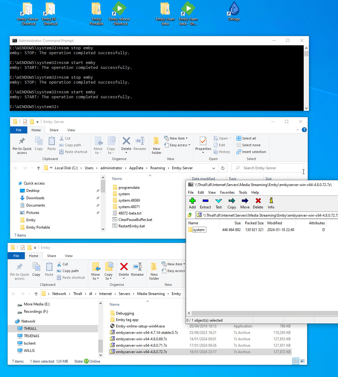

pwhodges 2023 Posted January 19, 2024 Posted January 19, 2024 Portable isn't actually different from what the installer installs - it just leaves you free to put it where you want. I just download from Github, and copy the system directory from the download to replace the old one; as all the rest of Emby is already in place, there's no need to run the installer again. I have shortcuts to the Emby directory and the download directory on the desktop, so I can go straight there without thinking (the portable installs you can see are for testing): Paul
