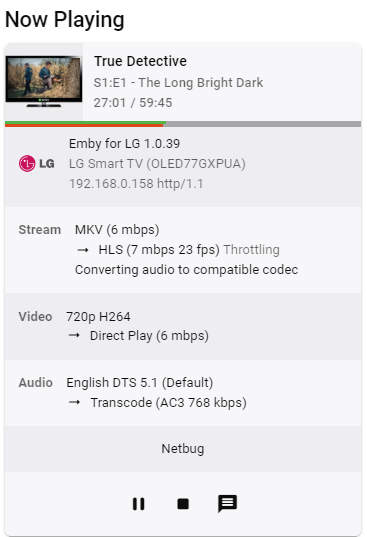

Netbug 26 Posted January 17, 2024 Posted January 17, 2024 (edited) App: Emby for LG 1.0.39 Server: 4.7.14.0 running on unRAID Hardware Information Motherboard: ASUSTeK COMPUTER INC. X99-A II , Version Rev 1.xx Processor: Intel Core i7-6850K CPU @ 3.60GHz RAM: 32GB SATA Extender: Supermicro AOC-SASLP-MV8 SATA Extender Hot-swap Bays: SuperMicro CSE-M35T-1B (x 3) Power Supply: CORSAIR Enthusiast Series TX750M USB (unRAID): Lexar JD Firefly 8GB Hard Drives: Parity WDC_WD80EFAX-68KNBN0_VDHBX7VD - 8 TB (sdb) Disk 1 WDC_WD20EADS-00R6B0_WD-WCAVY5374796 - 2 TB (sdf) Disk 2 WDC_WD30EZRX-19D8PB0_WD-WMC4N0J7D8TT - 3 TB (sdd) Disk 3 WDC_WD20EARS-00MVWB0_WD-WCAZA9034298 - 2 TB (sde) Disk 4 WDC_WD80EFAX-68KNBN0_VDH2MGVD - 8 TB (sdh) Disk 5 ST4000DM005-2DP166_WGY0E53A - 4 TB (sdj) Disk 6 ST3000DM001-1CH166_W1F23145 - 3 TB (sdm) Disk 7 WDC_WD30EZRX-00SPEB0_WD-WCC4E0NP7NLR - 3 TB (sdl) Disk 8 ST8000DM004-2CX188_ZR128XVM - 8 TB (sdk) Disk 9 ST4000DM005-2DP166_WDH2S61F - 4 TB (sdg) Disk 10 ST4000DM004-2CV104_ZFN0BNMN - 4 TB (sdi) Disk 11 ST8000DM004-2CX188_ZCT3VH40 - 8 TB (sdc) Cache INTEL_SSDPEKNW512G8_PHNH929303YD512A - 512 GB (nvme0n1) Flash JD_FireFly - 8 GB (sda) For some reason, content I'm watching has started to buffer at random. I'm trying to figure out how I can determine if it's a hard drive issue, processor, or network problem and I'm not quite sure to start. I'll be watching a show, and all of a sudden it will just freeze for up to 2 minutes. It will then start playing for a bit, then freeze. One thing I'm noticing, is on the Emby dashboard, there's a pair of indicator lines, one red, and one green. I believe these are the playback position (green) and where it's buffered to (red). It seems that when the green catches the red, the problem occurs (screenshot attached). Where can I start to look for the bottleneck? Thanks. embyserver.txt ffmpeg-remux-e4213cb5-8486-4181-bbb4-4eeb6c8f6ffa_1.txt Edited January 17, 2024 by Netbug
Luke 42184 Posted January 17, 2024 Posted January 17, 2024 Hi, does it happen with content that direct plays?
Netbug 26 Posted January 17, 2024 Author Posted January 17, 2024 I'm honestly not sure. I'm not great at this. Is there a way I can force something to direct play to test it? I did just change over and play through an Google Chromecast Ultra using a Samsung S22 and the Android Emby app and the problem did NOT occur, so I'm wondering if it's something to do with the Emby LG app. What other information can I gather to help you guys?

Luke 42184 Posted January 17, 2024 Posted January 17, 2024 16 hours ago, Netbug said: I'm honestly not sure. I'm not great at this. Is there a way I can force something to direct play to test it? By temporarily restricting user access to transcoding.
