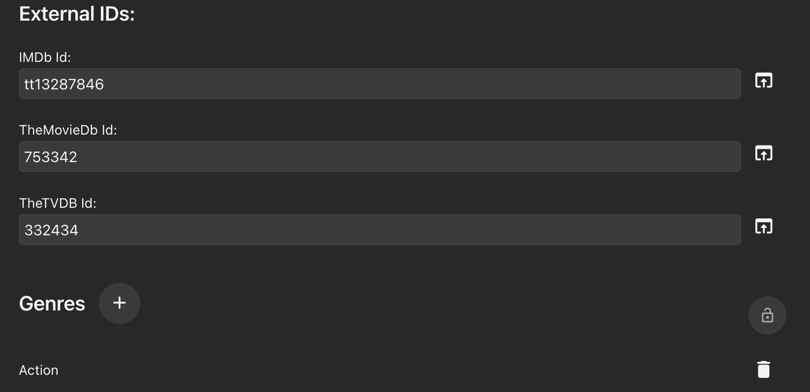

McMovies 7 Posted January 14, 2024 Author Posted January 14, 2024 (edited) yes. sometime it works sometime it doesn't. very unpredictable. used TVDB for some time, but reverted back to TMDB again. (i always get my images in Fanart, so no issues in images). @Luke@GrimReaper, not sure i create a new thread to report TVDB bugs, but for a quick report im putting it here- i discovered something the way metadata is grabbed from TVDB, they have lots of unwanted garbage section under "Other site" and are liked to lots of unwanted data like twitter, linkedin, facebook instagram, reddit and what not. most of them has two lines, one under <uniqueid> tag followed by <Social_media_site_name>, tag. also to writes some random redundant tag which i dont think emby reads it. Few instances i discovered few links are redirecting to illegal streaming as well. like multiple links pointing to pirated movie links in youtube in the name of trailer. . Latest example- https://thetvdb.com/movies/kitbag , this has pirate streams linked as well under reddit tags. Is it possible to grab only the metadata we actually use in emby or actually usable and keep our nfo clean? Secondly, TVDB metadata doesn't respect our country setting for <mpaa> tags, mentioned in library settings. for me God knows why its grabbing movie rating from Singapore region, and displaying SG-18,M18, etc instead of "R". Edited January 14, 2024 by McMovies --
Luke 42184 Posted January 14, 2024 Posted January 14, 2024 Quote Secondly, TVDB metadata doesn't respect our country setting for <mpaa> tags, mentioned in library settings. for me God knows why its grabbing movie rating from Singapore region, and displaying SG-18,M18, etc instead of "R". Hi there, can you please provide a specific example? Did you check the rating on the MovieDb website?
McMovies 7 Posted January 15, 2024 Author Posted January 15, 2024 12 hours ago, Luke said: Hi there, can you please provide a specific example? Did you check the rating on the MovieDb website? there were few examples, when i made TVDB primary and added few new content. (not able to recall all as i manually edited the rating afterwords). if i can remember this - https://thetvdb.com/movies/la-sociedad-de-la-nieve its shown me Singapore rating18, and not "R". ------- back to TMDB, its still refusing to connect. some SSL issue man be... Application path: /opt/emby-server/system System.Net.Http.HttpRequestException: System.Net.Http.HttpRequestException: The SSL connection could not be established, see inner exception. ---> System.IO.IOException: Unable to read data from the transport connection: Connection reset by peer.
