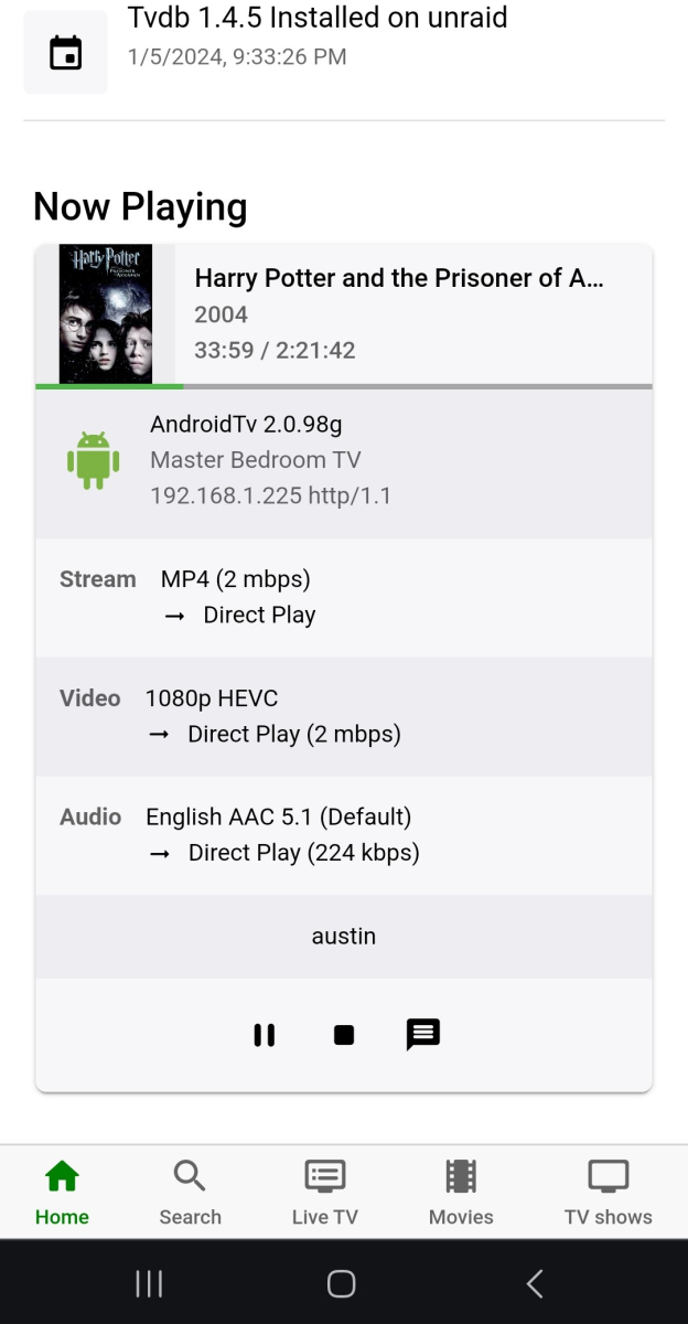

DrPorkChop 0 Posted January 12, 2024 Author Posted January 12, 2024 Ok, so when I play through the web it seemed to be transcoding (audio said direct play but video was transcoding, i think). But on my androidtv, the emby dashboard just says directplay everywhere. How do I get the android tv version to not direct play

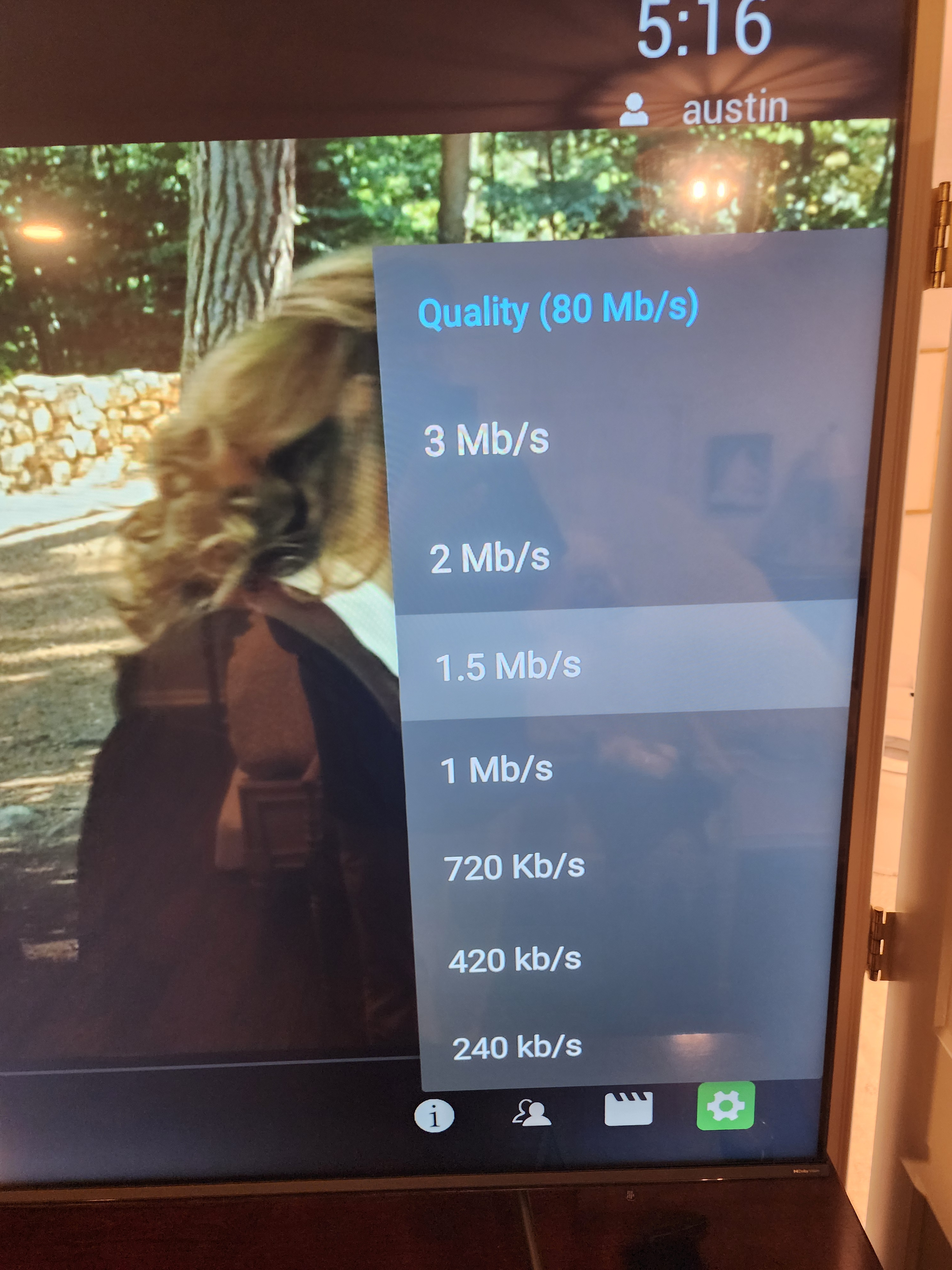

DrPorkChop 0 Posted January 12, 2024 Author Posted January 12, 2024 (edited) Ok I see the menu now. Had to hit down a few times but got there. I changed it from 80mbps to 2mbps. Same stutter. Screenshots below. Edited January 12, 2024 by DrPorkChop Dox myself

seanbuff 1356 Posted January 12, 2024 Posted January 12, 2024 18 minutes ago, DrPorkChop said: I changed it from 80mbps to 2mbps. Same stutter. That's because in that example of Harry Potter, the total bitrate is only 2mbps anyway, if you want to force transcode you will need to go even lower than 2. Also, did you try this? 20 hours ago, seanbuff said: - You can select "Playback Correction..." and see if that resolves your issue 14 minutes ago, DrPorkChop said: Is the version I have the latest? 2.0.98g 98g is the latest stable release yes
DrPorkChop 0 Posted January 13, 2024 Author Posted January 13, 2024 (edited) Ok making some headway here... It seemed to get better with playback correction but not a lot, still uncomfortable to watch. So I dropped down to 1mbps to see what would happen and the quality went down but transcoding started and stutter stopped! Then I worked my way up 1, 1.5, 2, 3; all were transcoding until I got to 3 and the stutter jank came back. So is there a way to make emby know to do this on its own? Edited January 13, 2024 by DrPorkChop
