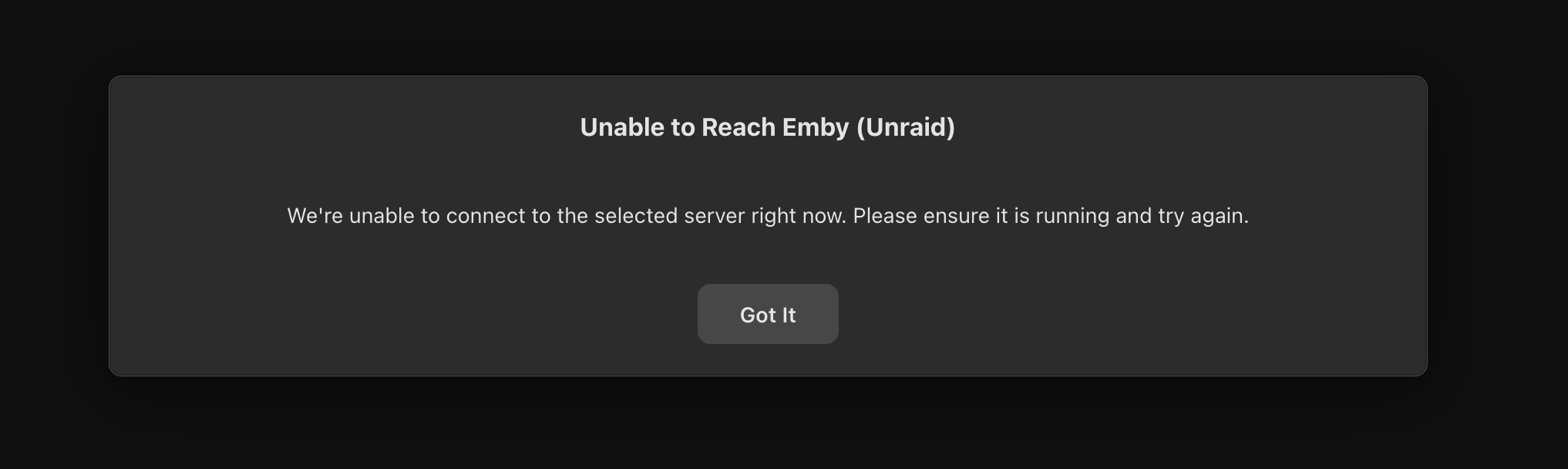

1971camaroguy 32 Posted January 11, 2024 Author Posted January 11, 2024 (edited) I have the double nat thing figured out, the provider fixed that. Now I have to figure out how to get emby connect to work, it's running in a docker on unraid and when I sign in remotely it's able to see the server, but when you click on it it says server unavailable right now. I have upnp enabled on both the router and emby...but it's not port forwarding automatically. I tried to manually forward the ports, no luck Weird thing, I have plex running in a docker too and as soon as the provider fixed what they did, plex connected remotely like a champ, no issues, even the upnp worked and picked up the plex ports......but I hate plex lol I'm at a loss right now, I feel like I checked everything, read the tutorials but I know I am missing something here Edited January 11, 2024 by 1971camaroguy

Q-Droid 1002 Posted January 11, 2024 Posted January 11, 2024 Make sure all of the info on the Emby dashboard and Network settings is correct for local (LAN) and public (WAN) entries. Don't rely on upnp. It's better to disable that on both Emby and your router and manually forward the ports you need.

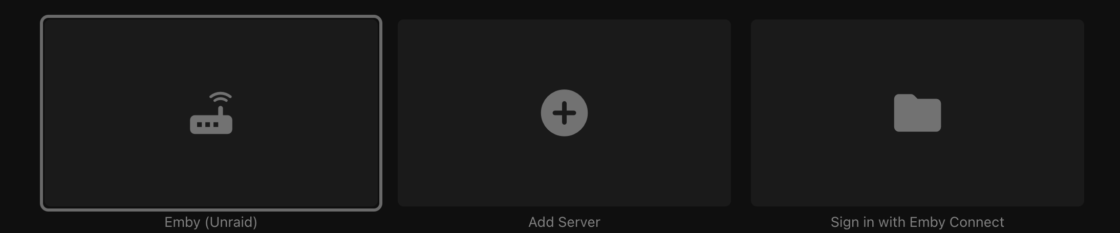

1971camaroguy 32 Posted January 11, 2024 Author Posted January 11, 2024 I'm at a loss I know my settings are correct. My external router IP matches the "what's my IP scan" No double Nat. (Again plex works now) Docker image is set as host to port 8096 . So in my emby configuration dashboard my local LAN address is the "same as my server:8096" My remote access IP is what is shown in "whats my IP" :8096 I disabled upnp in emby and my router I manually set up a port forward to my server address with 8096, TCP connection (port is open) Tried emby connect at work, it sees the server, and shows both the local and public IP with :8096 ...but when you try to acces it, it says we are unable to connect to the selected server right now, please ensure it is running and try again. In theory, this "should" be working. Unless I am missing a step on Unraid and there is a firewall setting I am unaware of.
1971camaroguy 32 Posted January 11, 2024 Author Posted January 11, 2024 Just checked it, I can get to it from a browser offsite with no issues...signed right in

Q-Droid 1002 Posted January 12, 2024 Posted January 12, 2024 You are able to connect remotely so the network setup and access are fine now. The current problem seems specific to Emby Connect but I don't use that feature. I do believe that you have to use the same protocol as your server: https if you have that enabled and http if you don't. Some browsers might automatically try to upgrade the connection for security but that won't work if your server is http. 1
