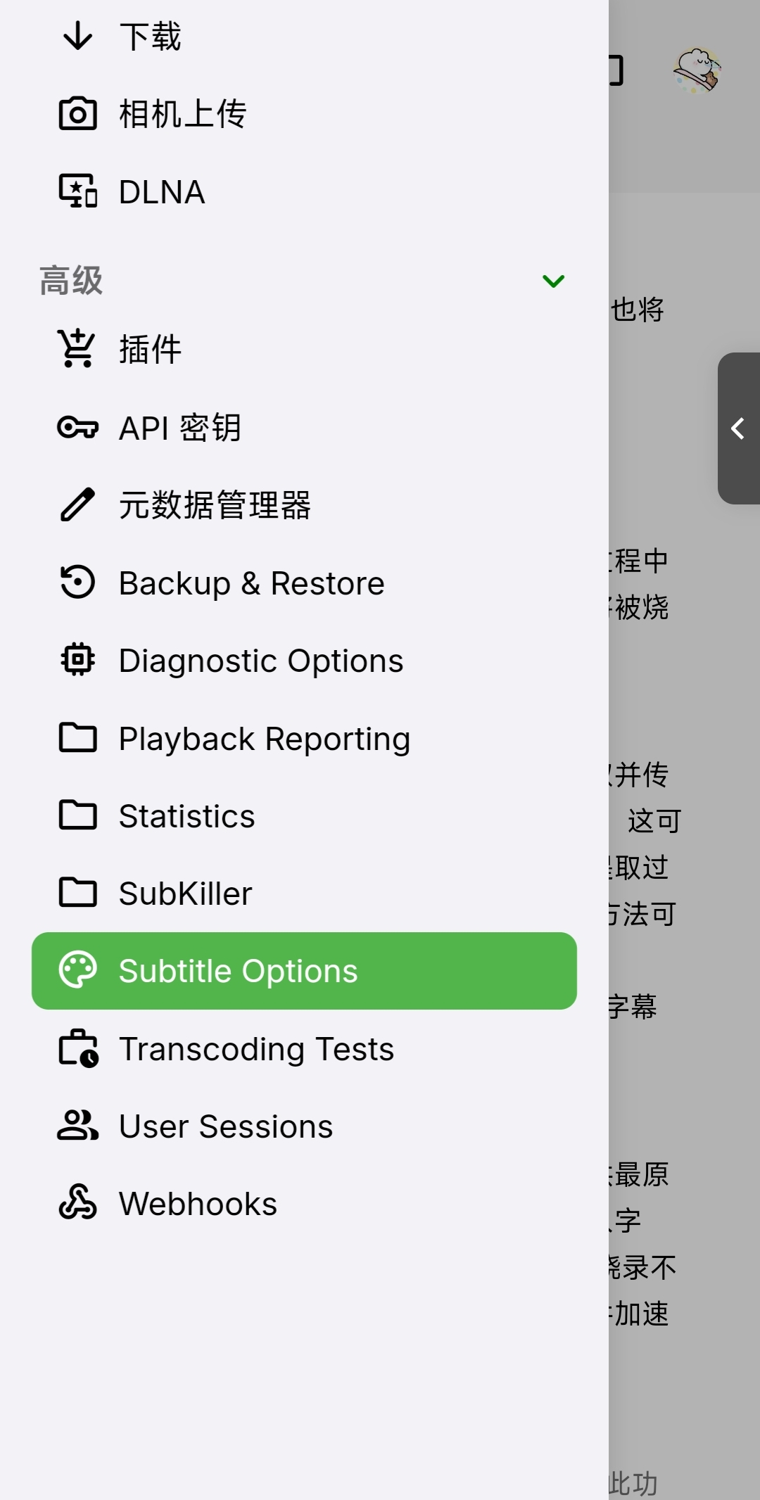

Hyy2001X 1 Posted May 18, 2024 Author Posted May 18, 2024 (edited) 2 hours ago, crabgg said: 4.9.0.19这是个测试版?不知道对ass字幕支持如何了,目前发现好像对ass的字幕支持是plex》jellyfin》emby,不对,emby不能算都不能正常播放。回头我也升级看看对pgs的支持。 在我另一个帖子里有,居然有人贴出了烧录字幕的功能,看界面是emby,但是我翻了底朝天也没翻到那个设置,jellyfin到是有。 4.9.x是测试版,不建议用正式版。你说的这个要额外装一个Diagnostics Plugin插件才有,在插件库里面,默认没有的。不过改了也没什么效果。 Edited May 18, 2024 by Hyy2001X

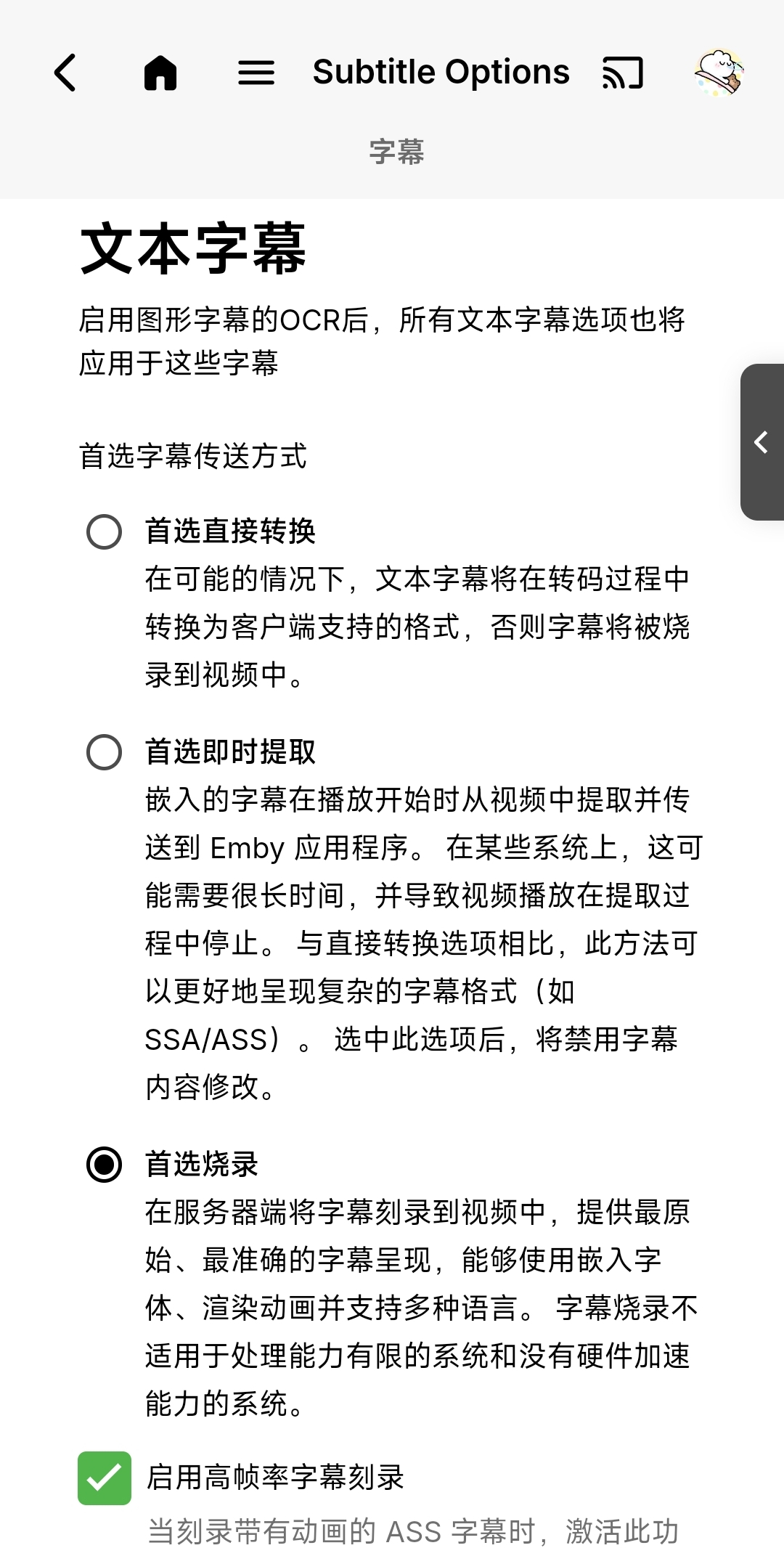

chouyee 5 Posted May 19, 2024 Posted May 19, 2024 5 hours ago, crabgg said: 4.9.0.19这是个测试版?不知道对ass字幕支持如何了,目前发现好像对ass的字幕支持是plex》jellyfin》emby,不对,emby不能算都不能正常播放。回头我也升级看看对pgs的支持。 在我另一个帖子里有,居然有人贴出了烧录字幕的功能,看界面是emby,但是我翻了底朝天也没翻到那个设置,jellyfin到是有。 有烧录字幕选项的。

crabgg 2 Posted May 19, 2024 Posted May 19, 2024 8 hours ago, chouyee said: 有烧录字幕选项的。 请教一下,这个烧录字幕在哪里?我的字幕选项里没这个选项,只有转码设置里有个允许实时提取字幕,但那个肯定是没啥用的。难道在测试版里有烧录字幕选项?
Hyy2001X 1 Posted May 19, 2024 Author Posted May 19, 2024 2 minutes ago, crabgg said: 请教一下,这个烧录字幕在哪里?我的字幕选项里没这个选项,只有转码设置里有个允许实时提取字幕,但那个肯定是没啥用的。难道在测试版里有烧录字幕选项? 装好插件,在这里设置
crabgg 2 Posted May 19, 2024 Posted May 19, 2024 2 minutes ago, Hyy2001X said: 装好插件,在这里设置 非常感谢,晚上试试新的4.8.7版本,刚看到版本更新说明修复了pgs问题。不知道能到什么程度。 1

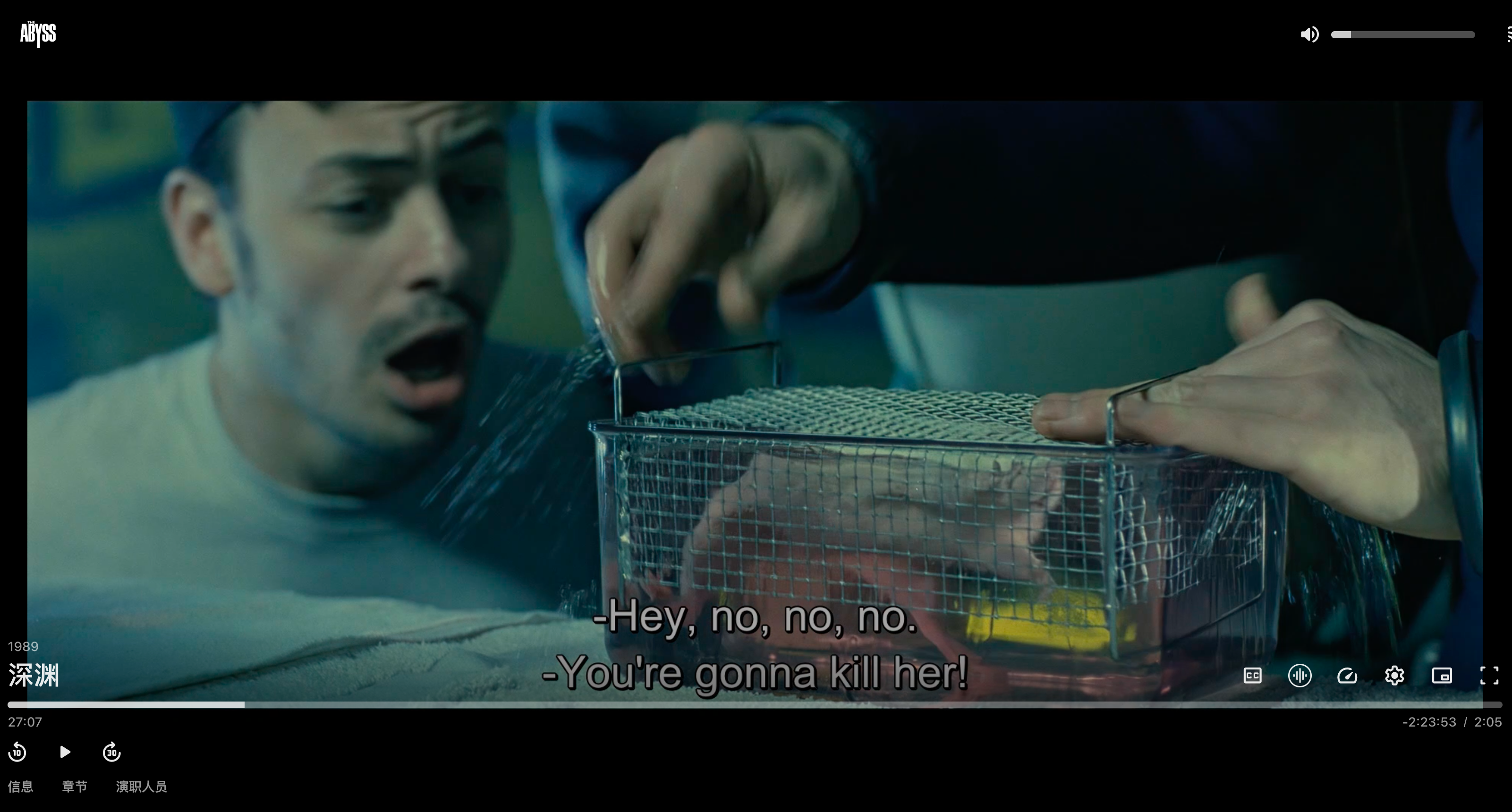

crabgg 2 Posted May 22, 2024 Posted May 22, 2024 On 5/19/2024 at 10:08 AM, Luke said: Hi, the changes mentioned here are also included in the 4.8.7 stable release. Oh God, my friend. When I upgraded to 4.8.7, the support for PGS subtitles did change. . It is no longer misaligned and floating far away like 4.8.0~4.8.5. but! but! It has returned to the situation in version 4.7. The subtitle jitter will not be fixed, and the display time is incorrect. After this scene, the subtitle is still displayed. . This is a return to the old way. This is really a sad story. I wonder when EMBY will be able to have subtitles like JELLYFIN and PLEX.

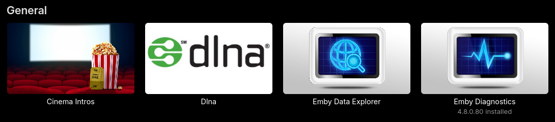

crabgg 2 Posted May 22, 2024 Posted May 22, 2024 On 5/19/2024 at 8:28 AM, chouyee said: 有烧录字幕选项的。 上面那位朋友说要额外装个Diagnostics插件,但是我在emby插件库没看到啊。麻烦可以截个图看看吗?到底在哪安装。实在是没找到。
Lessaj 484 Posted May 22, 2024 Posted May 22, 2024 43 minutes ago, crabgg said: The friend above said that you need to install an additional Diagnostics plug-in, but I didn't see it in the emby plug-in library. Could you please take a screenshot to see? Where to install it. Really couldn't find it.
crabgg 2 Posted May 23, 2024 Posted May 23, 2024 1 hour ago, newcheer1993 said: 你已经截图截出来了,最后一个。 好的,谢谢。
