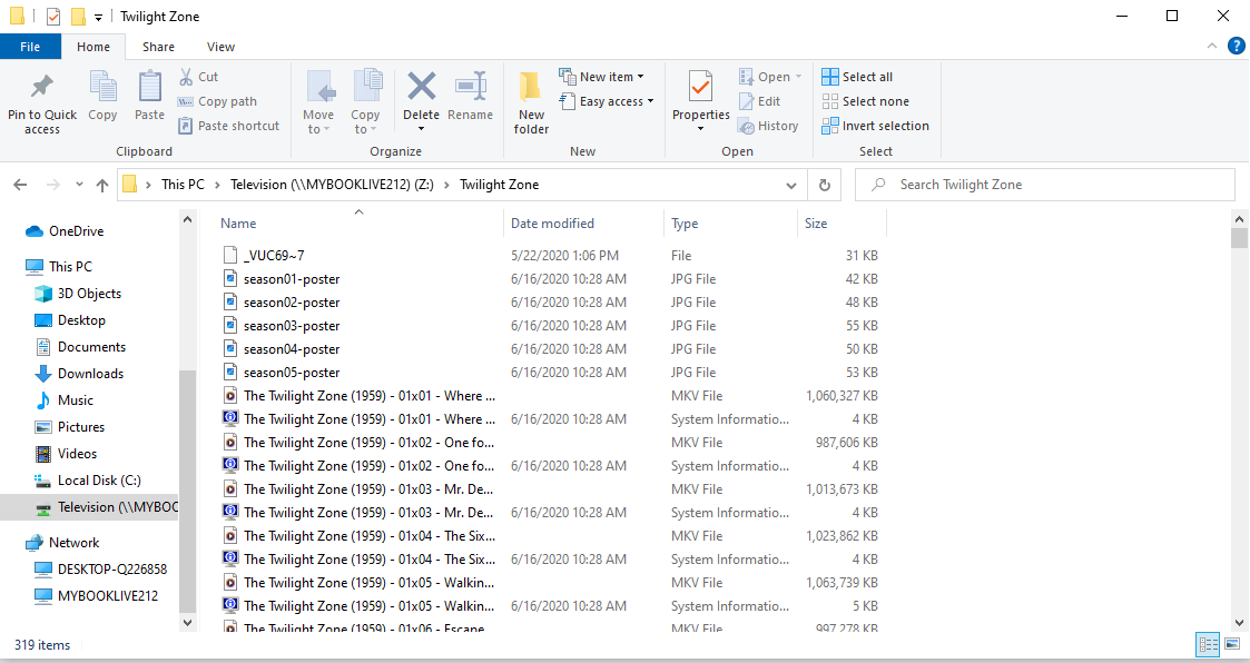

Arthur0618 0 Posted January 9, 2024 Author Posted January 9, 2024 I added libraries that have folders on my 2TB Network drive. When I create libraries for TV Shows this is the result where I can only see the episodes under episodes unlike Movies. Look I am new to this particular app while having used PLEX and KODI for a long time. I find EMBY is much better so I am looking to uses it for Roku.
seanbuff 1353 Posted January 9, 2024 Posted January 9, 2024 22 minutes ago, Arthur0618 said: I added libraries that have folders on my 2TB Network drive. Some screenshots of how your library filesystem is laid out would be helpful, as well as what you are seeing (or rather not seeing) in Emby For reference: TV Naming

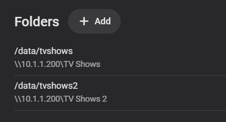

Luke 42185 Posted January 9, 2024 Posted January 9, 2024 18 hours ago, Arthur0618 said: I added libraries that have folders on my 2TB Network drive. When I create libraries for TV Shows this is the result where I can only see the episodes under episodes unlike Movies. Look I am new to this particular app while having used PLEX and KODI for a long time. I find EMBY is much better so I am looking to uses it for Roku. What folder did you add in emby library setup?
Arthur0618 0 Posted January 10, 2024 Author Posted January 10, 2024 I added a folder for each series of shows or movies.
seanbuff 1353 Posted January 10, 2024 Posted January 10, 2024 19 minutes ago, Arthur0618 said: I added a folder for each series of shows or movies. You should only add the top-level folder that contains the individual series folders: beneath the above folders are the actual series folders themselves, as per the documentation linked a few posts up: Quote \TV \Glee (2009) \Season 1 Glee S01E01.mp4 Glee S01E02.mp4 \TV \Seinfeld (1989) Seinfeld S01E01.mp4 Seinfeld S01E02.mp4 the "TV" folder is all that should be added to your library 1
