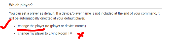

ginjaninja 605 Posted December 31, 2023 Posted December 31, 2023 On 5/7/2019 at 5:08 PM, Angelblue05 said: Yes, it will remember your choice. Change the player, select the player from the list. Then that will be the player your request will always be sent to, unless you say “to another player” at the end of your command. i cant get the device functionality to work or i have miaundestood. are the device names as per alexa device names or as per emby device names? (edit just worked out that emby device names are supported at least) i open the skill on Alexa echo dot ...alexa name bedroom "change the player" Alexa responds ..."set default device to amazon echo, Alexa.." it doesnt use the name bedroon (if its confirming the bedroom alexa echo dot device is now the current device) and it doesnt list available devices.. (edit doh....it is using emby device names, once i renamed the Alexa device in Emby it announced the bedroom device name...apologies...) can you open mbhome on an alexa ..and then issue a voice command to set the default device to fire stick bedroom? i can append 'on fire stick bedroom' to other commands but i want to issue voice play commands at alexa and for the firestick bedroom to be the target by default as the more tokens in the command the more unreliable and fiddly it is.. "change the player [to] fire stick bedroom" responds "no media found" is this telling me the command was successful but there is no current media playback session on the device or is this an error or something else...am i issuing an invalid command? ty for advice edit so making progress but still cant change the default player by a voice command..any ideas please? @ginjaninja

ginjaninja 605 Posted October 23, 2024 Author Posted October 23, 2024 Yes thanks i can set the player using the list method (not specifying a player name) Spoiler FWIW specifying the player name never works for me, dont know if it should as per wiki but i'm find with using the method above. 1
