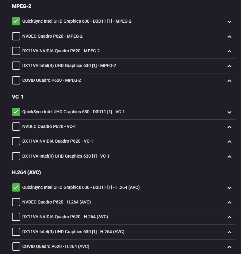

ITGuy1024 18 Posted January 12, 2024 Author Posted January 12, 2024 Testing this more I noticed that Emby initially starts to play the media with CPU transcoding. I have to start and stop the media a few times for it to start using the igpu for some reason. Only the igpu has been selected under transcoding and hdr tone mapping is set to hardware only.
