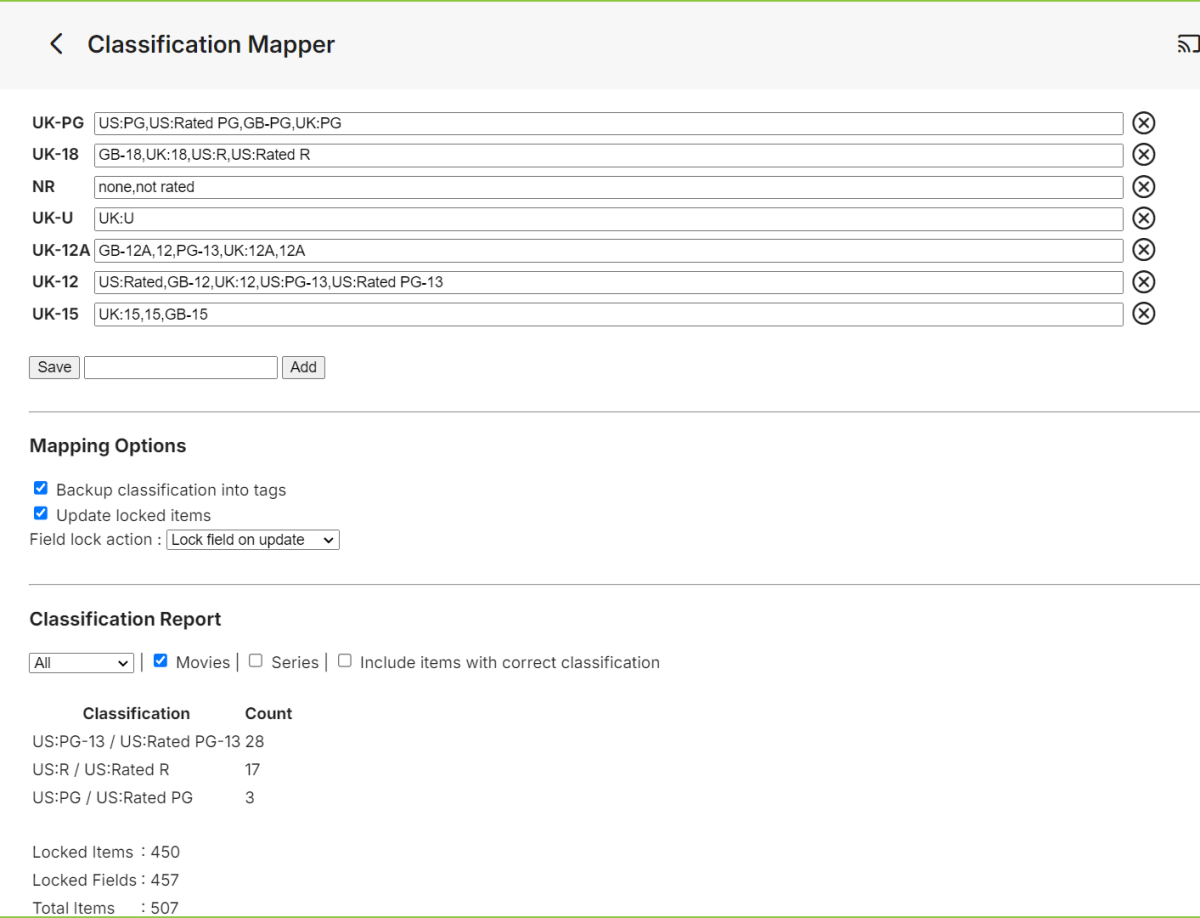

wints 23 Posted October 17, 2024 Posted October 17, 2024 Hi, thank you for creating this plugin. I believe it will be very helpful once I understand how to set it up correctly. At the moment, I'm having trouble. I'm attempting to map US classifications to UK classifications, but nothing seems to change. Does the plugin pick up the rating from the file name or the NFO file within the movie folder? I'm not very skilled at tinkering with this, but I wanted to give it a try any pointers would be greatly appreciated. Thanks

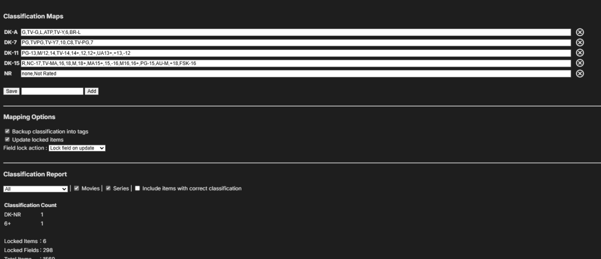

Neminem 1626 Posted October 17, 2024 Posted October 17, 2024 Here is how I set up my Danish Classes. Hope this give you some hints
wints 23 Posted October 17, 2024 Posted October 17, 2024 Thanks for your reply and hints, this is what I have tried but it can't be right because it's still not changing anything after the library update
TeamB 2440 Posted October 17, 2024 Author Posted October 17, 2024 (edited) 2 hours ago, wints said: Thanks for your reply and hints, this is what I have tried but it can't be right because it's still not changing anything after the library update did you run the scheduled task that actually does the updating? Edited October 17, 2024 by TeamB
wints 23 Posted October 18, 2024 Posted October 18, 2024 Hi yeah the one for the Mapper in scheduled tasks taking 0 seconds to complete
TeamB 2440 Posted October 18, 2024 Author Posted October 18, 2024 all the ones that are left just dont have mappings yet, add them and it should work Add mappings for the ones in the classification report that are missing
wints 23 Posted October 19, 2024 Posted October 19, 2024 Thanks for the reply TeamB and the pointers, I've got most of the ratings mapped now but no matter what I seem to do I can't get the last few to map?
Junglejim 385 Posted October 19, 2024 Posted October 19, 2024 (edited) Where does that forward slash come from "/" in your classifications? That's Fu#$edup, you will have to map as you see.... with the "/" ...... "US:PG-13 / US:Rated PG-13" Edited October 19, 2024 by Junglejim 1
TeamB 2440 Posted October 19, 2024 Author Posted October 19, 2024 yeah the / might be causing problems. Have you tried adding the full rating "US:PG-13 / US:Rated PG-13"
wints 23 Posted October 19, 2024 Posted October 19, 2024 I don't know if I've tried with the / but I'll give it a go cheers 2
Junglejim 385 Posted October 20, 2024 Posted October 20, 2024 15 hours ago, wints said: I don't know if I've tried with the / but I'll give it a go cheers I think your scraper had a bit of a senior moment and couldn't decide which classification to use.. So it said hell with it I'll use both..
wints 23 Posted October 20, 2024 Posted October 20, 2024 2 hours ago, Junglejim said: I think your scraper had a bit of a senior moment and couldn't decide which classification to use.. So it said hell with it I'll use both.. It is probably me having the senior moment rather than the scrapper but adding the / seems to have done the trick, I appreciate the help

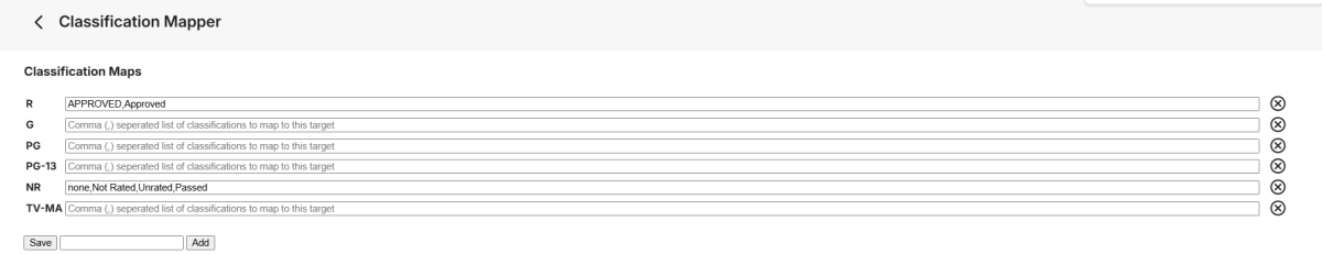

CarneAsada 12 Posted September 7, 2025 Posted September 7, 2025 Thank you for creating this plug-in; I was able to clean up an inappropriate classification for a kids profile. Emby by default groups G/PG and APPROVED; as such I needed a way to identify all ratings under APPROVED and upgrade them to R. These are the settings I used. 1
