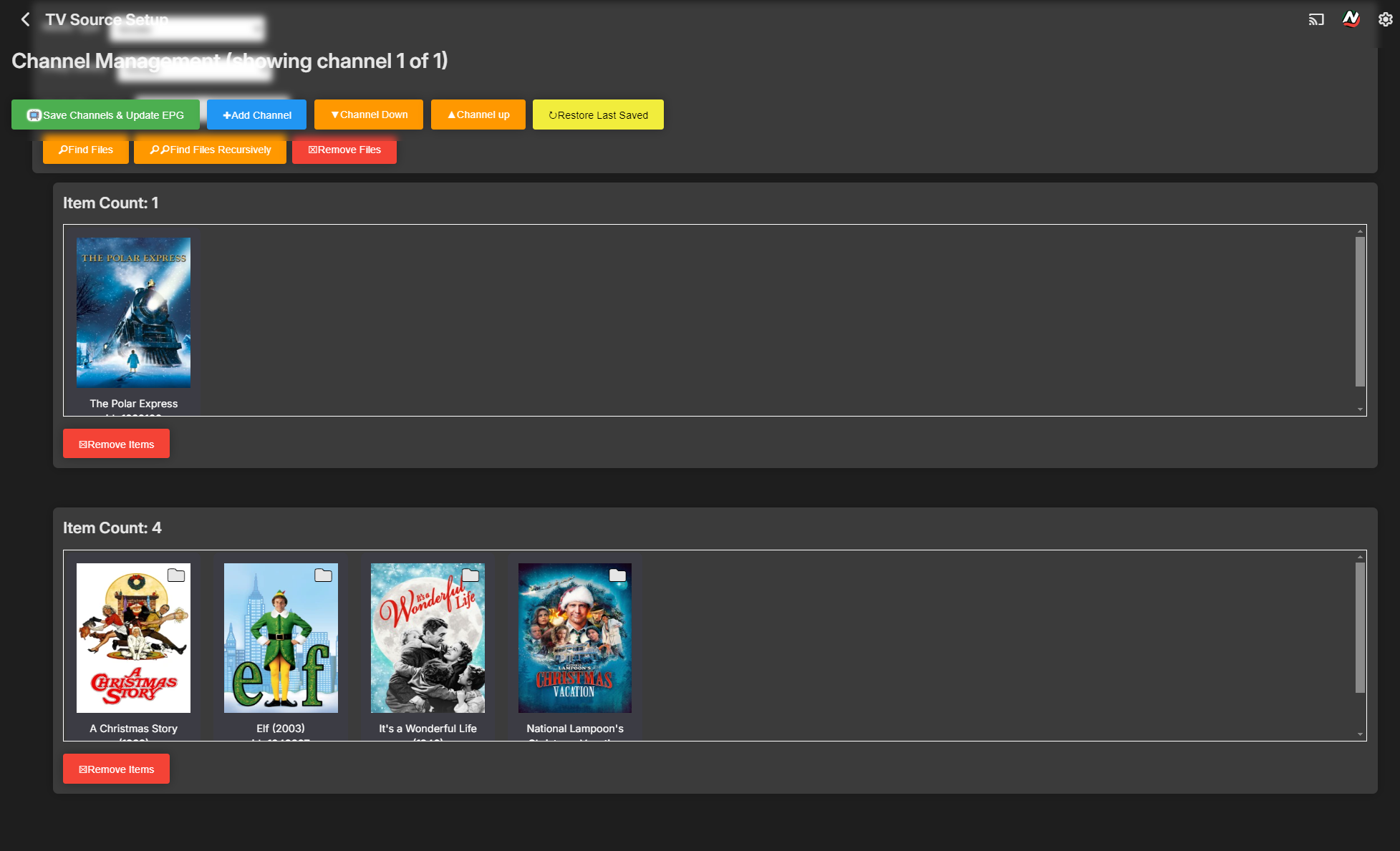

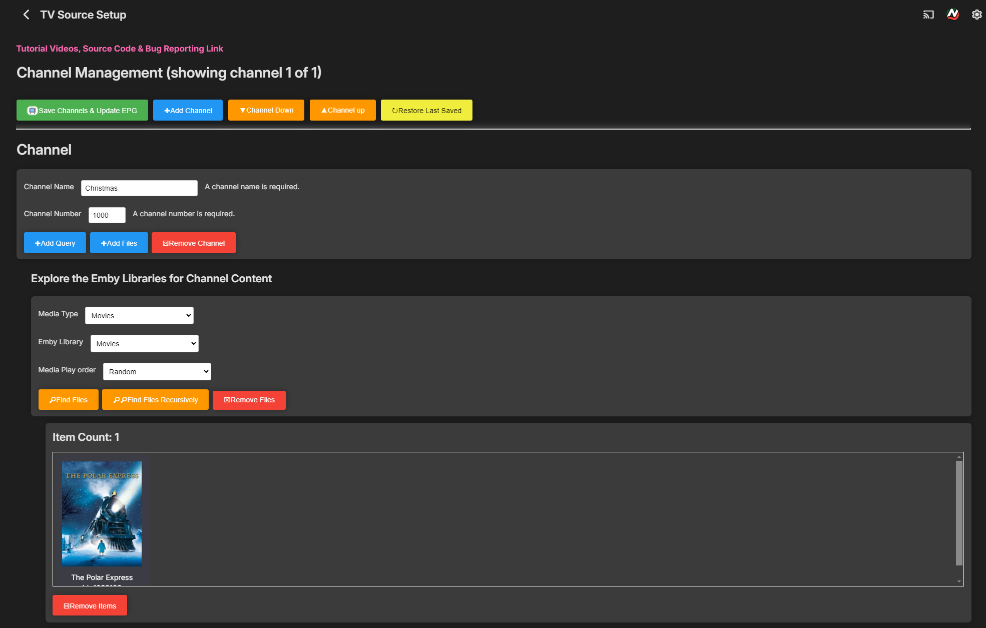

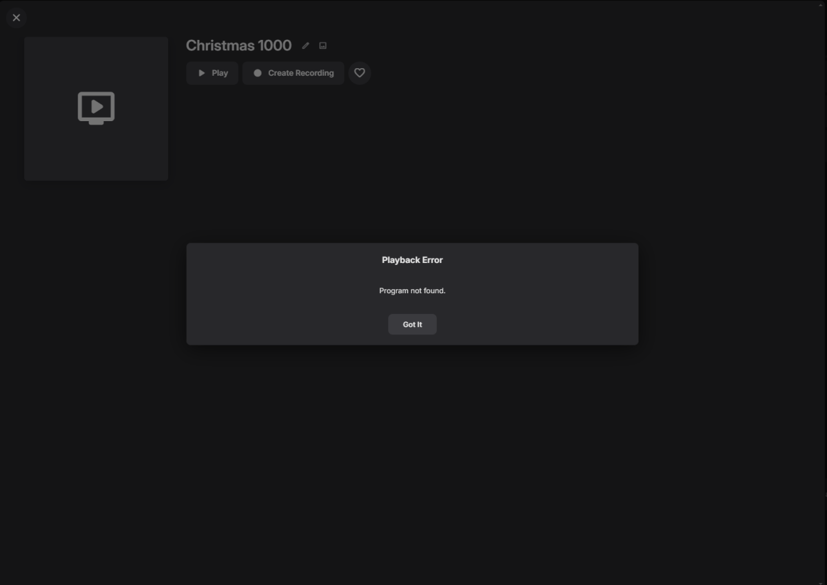

feerlessleadr 173 Posted December 19, 2024 Posted December 19, 2024 Hi @VicMooreApologies for being MIA lately, work has been crazy. I'm just getting back up to speed and downloaded the latest version of the plugin to start testing. I was trying to keep things simple and just created a Christmas movie channel from 2 emby libraries using the find files button. Once I have everything setup, I hit the save channels button, and then my guide refreshes. I already use live TV for my IPTV services, so my guide refresh takes a while (also why I am assigning channel 1000). However, when I go into my live tv after the guide refresh is complete, the new channel is blank, and if I try to play the channel, I get an error that says "Playback Error Program Not Found". Any idea what I'm doing wrong?
VicMoore 755 Posted December 19, 2024 Author Posted December 19, 2024 (edited) @feerlessleadrThis should be an easy fix. Send me your browser console. I did notice that you are using an old PseudoTV Service platform. Before resetting Emby to load the new plugin, delete the old TV-Service. I have attached the new code below, just in case that you need it. Vic PseudoTV.zip PseudoTV.dll Edited December 19, 2024 by VicMoore
feerlessleadr 173 Posted December 20, 2024 Posted December 20, 2024 Thanks - I have users watching stuff at the moment, so I will have to do this tonight. One question, how do I send you my browser console? I'm using Brave.
VicMoore 755 Posted December 20, 2024 Author Posted December 20, 2024 @feerlessleadr Brave is a Chromium based browser, so I think all you have to do is click F12 and the console should appear on the right side of the screen. If not, try using Chrome or Edge. When you build your channels in PseudoTV, diagnostic data appears on the console. Select everything and copy it into a text file and send it to me. Vic

feerlessleadr 173 Posted January 9, 2025 Posted January 9, 2025 On 12/20/2024 at 7:07 AM, VicMoore said: @feerlessleadr Brave is a Chromium based browser, so I think all you have to do is click F12 and the console should appear on the right side of the screen. If not, try using Chrome or Edge. When you build your channels in PseudoTV, diagnostic data appears on the console. Select everything and copy it into a text file and send it to me. Vic Hi @VicMooreapologies for the delay, just getting back to things after the holidays. I deleted the TV service and re-added after installing the latest plugin from the OP. Same issue persists. Here is the output of the browser console. error.txt

VicMoore 755 Posted January 9, 2025 Author Posted January 9, 2025 Hello @feerlessleadrI will look at the console data tonight. Vic 1
VicMoore 755 Posted January 10, 2025 Author Posted January 10, 2025 @feerlessleadr Try this code. It should fix your problem. Vic PseudoTV.dll
roormonger 6 Posted January 11, 2025 Posted January 11, 2025 On 1/9/2025 at 9:04 PM, VicMoore said: @feerlessleadr Try this code. It should fix your problem. Vic PseudoTV.dll 505.5 kB · 3 downloads I was having the same problem as feerlessleadr. This fixed it for me.
