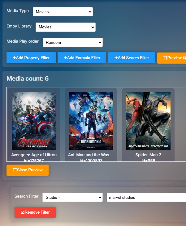

Lingardpi80 0 Posted July 8, 2024 Posted July 8, 2024 @VicMooreThank you for responding. And I really like the plugin. And Kodi media center is a front end program I use that just imports media from Emby. Kodi has a similar program called Pseudolivetv beta but doesn’t work as well as this one. Google searches lead me to your version. The only issue is that it will only play videos from the beginning in Kodi but works fine in emby. It’s probably an issue with Kodi and iptv simple. @roormongerYes I tried formula filters for studio, genre, plus tag searches. It didn’t like Marvel or DC studios or comics. I ended up just adding the tv shows manually and just didn’t do the movies.
VicMoore 755 Posted July 8, 2024 Author Posted July 8, 2024 @Lingardpi80I think the problem is in the Emby API. I need to do some more testing before asking the Emby team to look at it. You are right about the issue of always starting to play at the beginning of videos. The problem is in Emby and @Luke is working on it. Let me know if anything doesn't work. Vic
VicMoore 755 Posted July 8, 2024 Author Posted July 8, 2024 @roormonger a temporary fix for "studios" not working in the formula filter is to use the "search" filter instead. This filter also allows you to use the * wildcard char. Vic

VicMoore 755 Posted July 9, 2024 Author Posted July 9, 2024 @roormongerThe Studios search is fixed. The problem is that the values field was "comma delimited" rather than "Pipe delimited". In otherwards, it was my problem rather than Emby's. Vic PseudoTV.zip PseudoTV.dll 1

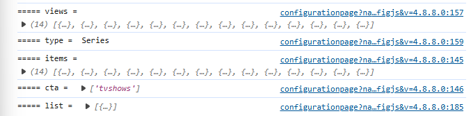

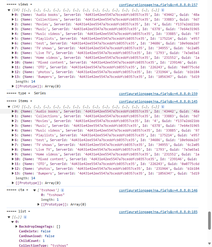

VicMoore 755 Posted July 21, 2024 Author Posted July 21, 2024 (edited) @andrewtdop and @enrique8316868I must have something wrong in my thinking. I appreciate you pointing this out. When you select "TvSeries" the selection box below it should list all of your Emby libraries that are defined for TV content. I don't understand how you could be getting "Movies, Concerts and Movies, Collections, and Movie Trailers". What is the content type for these libraries? I am not saying that you are wrong. The problem is with me. I will study this tonight. I will try to fix this ASAP. Vic Edited July 21, 2024 by VicMoore

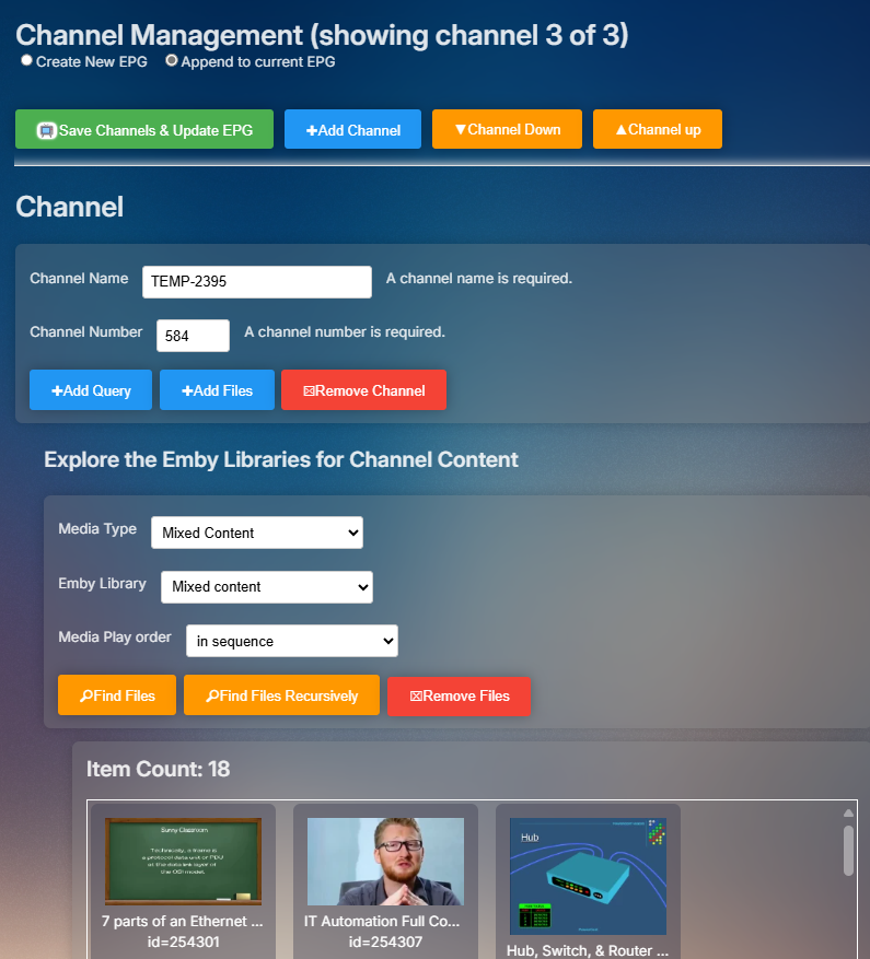

VicMoore 755 Posted July 21, 2024 Author Posted July 21, 2024 (edited) @roormongerBelow is my first try at mixed content. I created a mixed content library and I was able to build Channels OK. Let me know if it works as you expected. Again, thanks for bringing this to my attention. Once you say it works, I will post the source code. Vic PseudoTV.dll Edited July 22, 2024 by VicMoore
VicMoore 755 Posted July 22, 2024 Author Posted July 22, 2024 (edited) @andrewtdop and @enrique8316868 attached below is a special version of PseudoTV that will Shead light on your problem. Install the plugin and press F12 to display the browsers console. Next go to any channel and change the Media Type to "Tv Series". Next go to the Browser Console and page to the bottom. At the very bottom of the screen, you should see Next open the objects, as shown below and copy and paste them in a message to me. PseudoTV.dll Edited July 24, 2024 by VicMoore
VicMoore 755 Posted July 23, 2024 Author Posted July 23, 2024 (edited) I added the "MIXED" media type and many new filters. These changes will affect only newly created queries. I have done a minimum of testing. So, I will fix ASAP any bugs reported. Vic PseudoTV.dll PseudoTV.zip Edited July 24, 2024 by VicMoore 1
