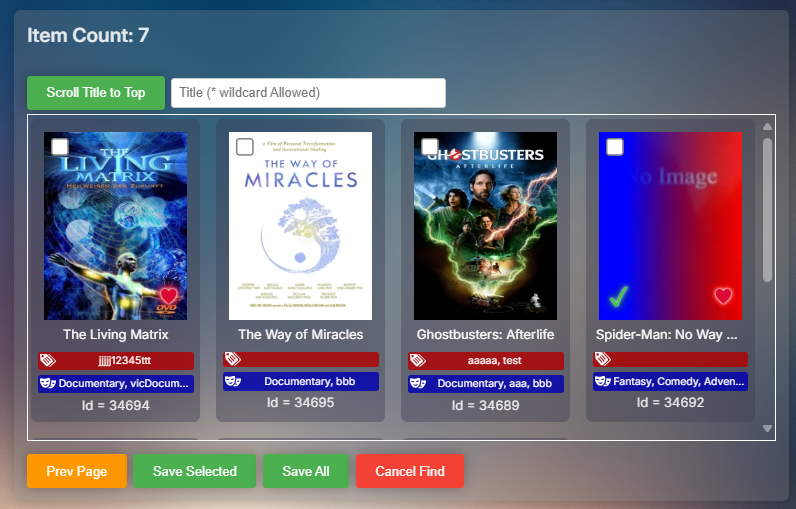

VicMoore 755 Posted June 12, 2024 Author Posted June 12, 2024 When finding files, the files were always listed alphabetically to simplify locating and selecting programs. The side effect of this choice is that the "Sort By" for programs defaulted to "alphabetical". So, I removed the code that forced alphabetical listings in favor of honoring the listing choice specified in the menu. The consequence of this choice was that finding a particular program became difficult, because you had to search through all of the files one at a time. For this reason, I added a simple find method at the top of the find file menu. With it you can scroll the title you want to the top of the menu. I also added the "loading" spinner back in. Does anyone have any concerns or bugs to be fixed? PseudoTV.zip PseudoTV.dll 2

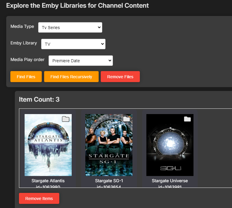

feerlessleadr 173 Posted June 14, 2024 Posted June 14, 2024 @VicMooreMaybe I'm doing something wrong, but the EPG order by premiere date for more than 1 TV show is still not working for me. It's still ordering the episodes in episodic order by alternating show, rather than absolute premiere date.
VicMoore 755 Posted June 14, 2024 Author Posted June 14, 2024 @feerlessleadrdid you set the sort order to what you want?
feerlessleadr 173 Posted June 14, 2024 Posted June 14, 2024 9 minutes ago, VicMoore said: @feerlessleadrdid you set the sort order to what you want? I believe I did - see below: EPG: All episodes of SG-1 premiered before Stargate Universe, so it's stil showing up incorrectly. One other thing, I can't figure out how to switch channels to edit. Am I missing something?
VicMoore 755 Posted June 14, 2024 Author Posted June 14, 2024 @feerlessleadrYes, you set it correctly. I will check the query sent to Emby today. It's possible that the premiere dates of the folders are not set. When you look at the EPG are the episodes within each folder in premiere date order? You switch from channel to channel by clicking the channel up and channel down buttons. The change happens so fast that you often have to look at the channel numbers to recognize that a channel change occurred. Vic
VicMoore 755 Posted June 14, 2024 Author Posted June 14, 2024 @feerlessleadrI see what the problem is. When TV series are added to a channel, the shows in those series are not played one after the other. Instead, they are interleaved. A show is taken from series 1, the next show comes from series 2, and so. Collectively the shows are played in the chosen order. I will have to brain storm a bit to figure out how to do what you want. Vic 1
