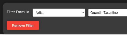

VicMoore 755 Posted May 30, 2024 Author Posted May 30, 2024 (edited) @bfir3yes you can search on people. Use the Formula filter and search on Artists. Vic Edited May 30, 2024 by VicMoore
bfir3 117 Posted May 30, 2024 Posted May 30, 2024 (edited) 12 minutes ago, VicMoore said: @bfir3yes you can search on people. Use the Formula filter and search on Artists. Vic Can you share an example? For example I'd like movies directed by Quentin Tarantino, so not items where he's a producer or writer and not a director. Actually I'm guessing since we are querying the emby API from pseudotv I should check the emby documentation about artist queries so I will do that and see if I can figure it out. edit: For example I've tried: And it seems to return every movie in my library: Edited May 30, 2024 by bfir3

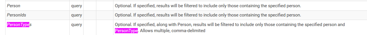

TZTZoro 26 Posted May 30, 2024 Posted May 30, 2024 (edited) @bfir3since you know how to find the console, if you check which querries are created by checking the console log or the network tab(recommened because this is 100% the sent query) in the dev tools you can see what query is being sent, then you can compare it to the swagger docs but for your case it seems like you need to use person creating such a query by using /Items?Recursive=true&Person=Morgan&IncludeItemTypes=Movie Does also return all items, i think it is a bug from Emby side not much that can be done besides adding manual filtering When i was playing around with the rest api there were more like this which did not work as expected Edited May 30, 2024 by TZTZoro

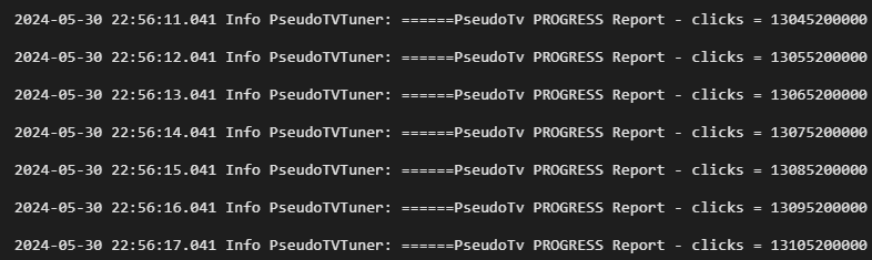

bfir3 117 Posted May 31, 2024 Posted May 31, 2024 6 hours ago, TZTZoro said: @bfir3since you know how to find the console, if you check which querries are created by checking the console log or the network tab(recommened because this is 100% the sent query) in the dev tools you can see what query is being sent, then you can compare it to the swagger docs but for your case it seems like you need to use person creating such a query by using /Items?Recursive=true&Person=Morgan&IncludeItemTypes=Movie Does also return all items, i think it is a bug from Emby side not much that can be done besides adding manual filtering When i was playing around with the rest api there were more like this which did not work as expected OK fair enough. Seems like an Emby issue for now then. By the way, I'm seeing this a lot in the emby log, is it necessary?
VicMoore 755 Posted May 31, 2024 Author Posted May 31, 2024 @bfir3Yes these messages are required by Emby when media is being played. You don't have to log them. I log them so I can see what Emby is doing. Vic
