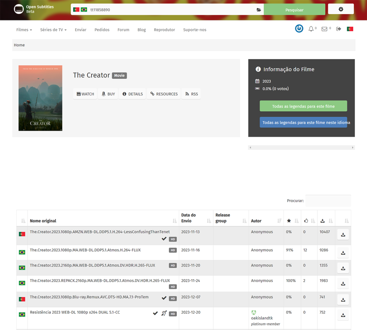

nmaia00 2 Posted January 21, 2024 Posted January 21, 2024 Hi, I'm using Emby Server 4.8.0.73 beta and Opensubtitles plugin 1.0.47.0. It's working for English and Portuguese (Brazil), and probably other languages, but I have problems with Portuguese (PT-pt). It always returns "No results..." for Portuguese but if I make a search on the opensubtitles.com website they are present and I can download them with no problem. The Creator (IMDB: tt11858890) is an example. Can you please check for this issue?
GrimReaper 4926 Posted January 21, 2024 Posted January 21, 2024 14 minutes ago, nmaia00 said: Hi, I'm using Emby Server 4.8.0.73 beta and Opensubtitles plugin 1.0.47.0. It's working for English and Portuguese (Brazil), and probably other languages, but I have problems with Portuguese (PT-pt). It always returns "No results..." for Portuguese but if I make a search on the opensubtitles.com website they are present and I can download them with no problem. The Creator (IMDB: tt11858890) is an example. Can you please check for this issue? Quote 2024-01-21 18:33:49.071 Info HttpClient: GET https://api.opensubtitles.com/api/v1/subtitles?imdb_id=11858890&languages=pt&moviehash=03e4d951c21d4072&query=The Creator (2023).mkv 2024-01-21 18:34:12.882 Info HttpClient: GET https://api.opensubtitles.com/api/v1/subtitles?imdb_id=11858890&languages=pt-br&moviehash=03e4d951c21d4072&query=The Creator (2023).mkv @Luke, maybe query should be done for "pt-PT" instead of just "pt"? Likely goes for all main languages? Quote <?xml version="1.0" encoding="UTF-8"?> <rss version="2.0" xmlns:atom="http://www.w3.org/2005/Atom"> <channel> <title>The Creator latest subttiles</title> <description>Latest subtitles for The Creator on Opensubtitles in languages: pt-PT,pt-BR</description> <link>https://www.opensubtitles.com/en/movies/2023-the-creator</link> <atom:link rel="self" type="application/rss+xml" href="https://www.opensubtitles.com/en/pt-PT,pt-BR/movies/2023-the-creator/latest_subtitles.rss"/> <item> <title>The Creator</title> <description>release: The.Creator.2023.1080p.10bit.BluRay.8CH.x265.HEVC-PSA, language: pt-BR, fps: 23.976, from_trusted: false</description> <pubDate>Mon, 08 Jan 2024 05:38:15 +0000</pubDate> <link>https://www.opensubtitles.com/en/subtitles/the-creator-2023-1080p-10bit-bluray-8ch-x265-hevc-psa</link> <guid>https://www.opensubtitles.com/en/subtitles/the-creator-2023-1080p-10bit-bluray-8ch-x265-hevc-psa</guid> </item> <item> <title>The Creator</title> <description>release: Resistência 2023 WEB-DL 1080p x264 DUAL 5.1-CC, language: pt-BR, fps: 23.976, from_trusted: true</description> <pubDate>Wed, 20 Dec 2023 22:44:36 +0000</pubDate> <link>https://www.opensubtitles.com/en/subtitles/resistencia-2023-web-dl-1080p-x264-dual-5-1-cc</link> <guid>https://www.opensubtitles.com/en/subtitles/resistencia-2023-web-dl-1080p-x264-dual-5-1-cc</guid> </item> <item> <title>The Creator</title> <description>release: Resistência 2023 WEB-DL 1080p x264 DUAL 5.1-forçada, language: pt-BR, fps: 24.0, from_trusted: true</description> <pubDate>Wed, 20 Dec 2023 22:41:53 +0000</pubDate> <link>https://www.opensubtitles.com/en/subtitles/resistencia-2023-web-dl-1080p-x264-dual-5-1-forcada</link> <guid>https://www.opensubtitles.com/en/subtitles/resistencia-2023-web-dl-1080p-x264-dual-5-1-forcada</guid> </item> <item> <title>The Creator</title> <description>release: The.Creator.2023.WEB.x264, language: pt-BR, fps: 24.0, from_trusted: true</description> <pubDate>Wed, 20 Dec 2023 20:37:31 +0000</pubDate> <link>https://www.opensubtitles.com/en/subtitles/the-creator-2023-web-x264-pt-br</link> <guid>https://www.opensubtitles.com/en/subtitles/the-creator-2023-web-x264-pt-br</guid> </item> <item> <title>The Creator</title> <description>release: The.Creator.2023.WEB.x264, language: pt-BR, fps: 24.0, from_trusted: true</description> <pubDate>Wed, 20 Dec 2023 20:36:57 +0000</pubDate> <link>https://www.opensubtitles.com/en/subtitles/the-creator-2023-web-x264</link> <guid>https://www.opensubtitles.com/en/subtitles/the-creator-2023-web-x264</guid> </item> <item> <title>The Creator</title> <description>release: The.Creator.2023.720p/.1080p.DSNP.WEB.x264, language: pt-BR, fps: 23.976, from_trusted: true</description> <pubDate>Wed, 20 Dec 2023 19:56:43 +0000</pubDate> <link>https://www.opensubtitles.com/en/subtitles/the-creator-2023-720p-1080p-dsnp-web-x264</link> <guid>https://www.opensubtitles.com/en/subtitles/the-creator-2023-720p-1080p-dsnp-web-x264</guid> </item> <item> <title>The Creator</title> <description>release: The.Creator.2023.1080p.Blu-ray.Remux.AVC.DTS-HD.MA.7.1-ProTem, language: pt-PT, fps: 23.976, from_trusted: true</description> <pubDate>Thu, 07 Dec 2023 20:07:36 +0000</pubDate> <link>https://www.opensubtitles.com/en/subtitles/the-creator-2023-1080p-blu-ray-remux-avc-dts-hd-ma-7-1-protem</link> <guid>https://www.opensubtitles.com/en/subtitles/the-creator-2023-1080p-blu-ray-remux-avc-dts-hd-ma-7-1-protem</guid> </item> <item> <title>The Creator</title> <description>release: The.Creator.2023.REPACK.2160p.MA.WEB-DL.DDP5.1.Atmos.DV.HDR.H.265-FLUX, language: pt-BR, fps: 24.0, from_trusted: false</description> <pubDate>Fri, 24 Nov 2023 20:40:36 +0000</pubDate> <link>https://www.opensubtitles.com/en/subtitles/9797688-the-creator-2023-repack-2160p-ma-web-dl-ddp5-1-atmos-dv-hdr-h-265-flux</link> <guid>https://www.opensubtitles.com/en/subtitles/9797688-the-creator-2023-repack-2160p-ma-web-dl-ddp5-1-atmos-dv-hdr-h-265-flux</guid> </item> <item> <title>The Creator</title> <description>release: The.Creator.2023.2160p.MA.WEB-DL.DDP5.1.Atmos.DV.HDR.H.265-FLUX, language: pt-BR, fps: 23.976, from_trusted: false</description> <pubDate>Mon, 20 Nov 2023 21:20:23 +0000</pubDate> <link>https://www.opensubtitles.com/en/subtitles/the-creator-2023-2160p-ma-web-dl-ddp5-1-atmos-dv-hdr-h-265-flux</link> <guid>https://www.opensubtitles.com/en/subtitles/the-creator-2023-2160p-ma-web-dl-ddp5-1-atmos-dv-hdr-h-265-flux</guid> </item> <item> <title>The Creator</title> <description>release: The.Creator.2023.1080p.MA.WEB-DL.DDP5.1.Atmos.H.264-FLUX, language: pt-BR, fps: 24.0, from_trusted: false</description> <pubDate>Thu, 16 Nov 2023 20:56:05 +0000</pubDate> <link>https://www.opensubtitles.com/en/subtitles/the-creator-2023-1080p-ma-web-dl-ddp5-1-atmos-h-264-flux</link> <guid>https://www.opensubtitles.com/en/subtitles/the-creator-2023-1080p-ma-web-dl-ddp5-1-atmos-h-264-flux</guid> </item> <item> <title>The Creator</title> <description>release: The.Creator.2023.1080p.AMZN.WEB-DL.DDP5.1.H.264-LessConfusingThanTenet, language: pt-PT, fps: 24.0, from_trusted: true</description> <pubDate>Mon, 13 Nov 2023 19:15:27 +0000</pubDate> <link>https://www.opensubtitles.com/en/subtitles/9784611-the-creator-2023-1080p-amzn-web-dl-ddp5-1-h-264-lessconfusingthantenet</link> <guid>https://www.opensubtitles.com/en/subtitles/9784611-the-creator-2023-1080p-amzn-web-dl-ddp5-1-h-264-lessconfusingthantenet</guid> </item> </channel> </rss> 1
nmaia00 2 Posted January 23, 2024 Posted January 23, 2024 On 1/21/2024 at 5:53 PM, GrimReaper said: @Luke, maybe query should be done for "pt-PT" instead of just "pt"? Likely goes for all main languages? New plugin version and the same behavior. @Lukeany word about this issue? It looks like GrimReaper pointed out where the "problem" is. A word about the report would be welcome. Thanks in advance.

Luke 42287 Posted January 26, 2024 Posted January 26, 2024 HI, yes we are looking into the pt-pt issue. Thanks. 1
nmaia00 2 Posted January 26, 2024 Posted January 26, 2024 2 minutes ago, Luke said: HI, yes we are looking into the pt-pt issue. Thanks. Thank you. 1
nmaia00 2 Posted January 29, 2024 Posted January 29, 2024 Hi all. Just want to leave feedback about the issue with pt-PT language and probably other variants. With the 4.8.0.76 Beta and OpenSubtitles plugin 1.0.51.0 all seems to work well. Thanks @Luke 1

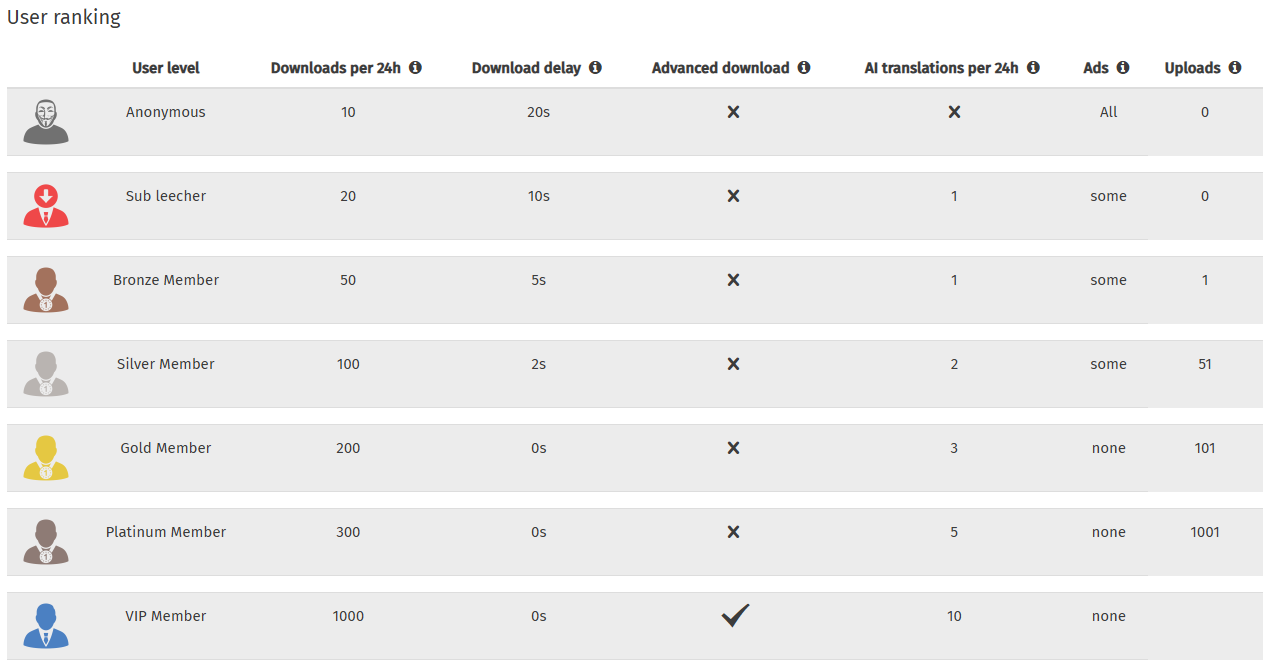

Neminem 1630 Posted November 6, 2024 Posted November 6, 2024 5 minutes ago, izzy198888 said: You have downloaded your allowed 100 subtitles for 24h.Your quota will be renewed in 13 hours and 55 minutes (2024-11-06 23:59:59 UTC) Wait 14 hours and try again or subscribe to OpenSubtitles.com

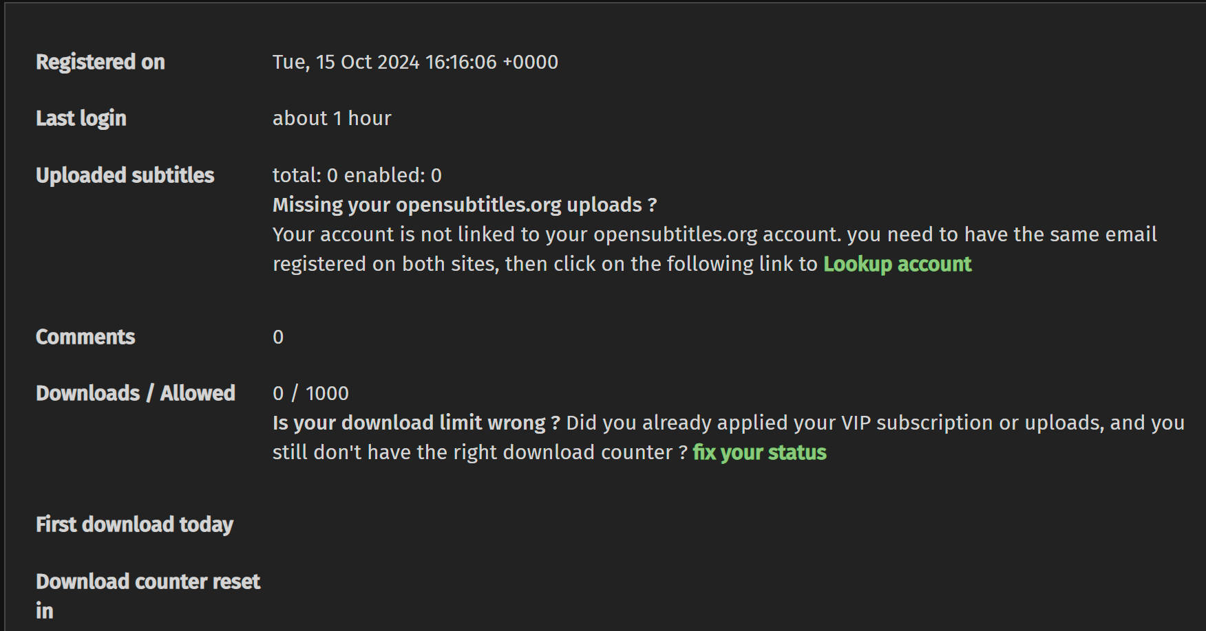

izzy198888 2 Posted November 6, 2024 Posted November 6, 2024 23 minutes ago, Neminem said: Wait 14 hours and try again or subscribe to OpenSubtitles.com Did you read my whole post? I am a subscribed VIP memeber. Why does Emby have limits on downloading subtitles. There is none on Kodi or other video players. Emby use to give me many subtitle results 2 years ago, and now I get like 5 bad options for download. But that's not the only issue. Why I'm not getting any results from other subtitle plugins? For gods sake, add titlovi.com already. Waiting 2 years for it. https://titlovi.com/clanci/1014/titlovicom-oficijelni-kodi-plugin/
Neminem 1630 Posted November 6, 2024 Posted November 6, 2024 12 minutes ago, izzy198888 said: Why does Emby have limits on downloading subtitles. Emby does not limit you download's, Opensubtitles does. Looking on opensubtitles.com if you only get 100 sub downloads, you are not VIP, only silver.

Neminem 1630 Posted November 6, 2024 Posted November 6, 2024 Ok the only errors about subtitles in those logs are about Addic7ed and Podnapisi with some errors I have not seen before. I would disable those, and try again. Here I see Opensubtitles working Log Level Time Stamp Log Level Source Message Info 2024-11-06 12:17:17 Info OpenSubtitles Login result: {"user":{"allowed_translations":10,"allowed_downloads":1000,"level":"VIP Member","user_id":xxxxxxx,"ext_installed":false,"vip":true},"token":"REPLACED","status":200,"base_url":"vip-api.opensubtitles.com"} Info 2024-11-06 12:17:17 Info OpenSubtitles Got Token: REPLACED Info 2024-11-06 12:17:17 Info OpenSubtitles Login response says base url is https://vip-api.opensubtitles.com/api/v1 Info 2024-11-06 12:17:17 Info HttpClient GET https://vip-api.opensubtitles.com/api/v1/infos/languages Info 2024-11-06 12:17:17 Info OpenSubtitles Languages: {"data":[{"language_code":"zh-ca","language_name":"Chinese (Cantonese)"},{"language_code":"az-az","language_name":"Azerbaijani"},{"language_code":"af","language_name":"Afrikaans"},{"language_code":"be","language_name":"Belarusian"},{"language_code":"my","language_name":"Burmese"},{"language_code":"ab","language_name":"Abkhazian"},{"language_code":"ar","language_name":"Arabic"},{"language_code":"hy","language_name":"Armenian"},{"language_code":"as","language_name":"Assamese"},{"language_code":"at","language_name":"Asturian"},{"language_code":"eu","language_name":"Basque"},{"language_code":"bn","language_name":"Bengali"},{"language_code":"br","language_name":"Breton"},{"language_code":"bg","language_name":"Bulgarian"},{"language_code":"ca","language_name":"Catalan"},{"language_code":"zh-cn","language_name":"Chinese (simplified)"},{"language_code":"az-zb","language_name":"South Azerbaijani"},{"language_code":"fr","language_name":"French"},{"language_code":"ka","language_name":"Georgian"},{"language_code":"de","language_name":"German"},{"language_code":"gd","language_name":"Gaelic"},{"language_code":"ga","language_name":"Irish"},{"language_code":"gl","language_name":"Galician"},{"language_code":"el","language_name":"Greek"},{"language_code":"he","language_name":"Hebrew"},{"language_code":"hi","language_name":"Hindi"},{"language_code":"hr","language_name":"Croatian"},{"language_code":"hu","language_name":"Hungarian"},{"language_code":"ig","language_name":"Igbo"},{"language_code":"is","language_name":"Icelandic"},{"language_code":"ia","language_name":"Interlingua"},{"language_code":"kk","language_name":"Kazakh"},{"language_code":"lv","language_name":"Latvian"},{"language_code":"lt","language_name":"Lithuanian"},{"language_code":"ml","language_name":"Malayalam"},{"language_code":"it","language_name":"Italian"},{"language_code":"ja","language_name":"Japanese"},{"language_code":"km","language_name":"Khmer"},{"language_code":"ko","language_name":"Korean"},{"language_code":"ku","language_name":"Kurdish"},{"language_code":"mk","language_name":"Macedonian"},{"language_code":"mr","language_name":"Marathi"},{"language_code":"nv","language_name":"Navajo"},{"language_code":"no","language_name":"Norwegian"},{"language_code":"oc","language_name":"Occitan"},{"language_code":"fa","language_name":"Persian"},{"language_code":"pl","language_name":"Polish"},{"language_code":"pt-pt","language_name":"Portuguese"},{"language_code":"ps","language_name":"Pushto"},{"language_code":"ru","language_name":"Russian"},{"language_code":"sr","language_name":"Serbian"},{"language_code":"sk","language_name":"Slovak"},{"language_code":"sl","language_name":"Slovenian"},{"language_code":"tm-td","language_name":"Tetum"},{"language_code":"sy","language_name":"Syriac"},{"language_code":"ta","language_name":"Tamil"},{"language_code":"me","language_name":"Montenegrin"},{"language_code":"ze","language_name":"Chinese bilingual"},{"language_code":"sd","language_name":"Sindhi"},{"language_code":"es","language_name":"Spanish"},{"language_code":"sw","language_name":"Swahili"},{"language_code":"sv","language_name":"Swedish"},{"language_code":"tt","language_name":"Tatar"},{"language_code":"te","language_name":"Telugu"},{"language_code":"th","language_name":"Thai"},{"language_code":"tk","language_name":"Turkmen"},{"language_code":"tr","language_name":"Turkish"},{"language_code":"uk","language_name":"Ukrainian"},{"language_code":"uz","language_name":"Uzbek"},{"language_code":"vi","language_name":"Vietnamese"},{"language_code":"cy","language_name":"Welsh"},{"language_code":"ro","language_name":"Romanian"},{"language_code":"pt-br","language_name":"Portuguese (BR)"},{"language_code":"zh-tw","language_name":"Chinese (traditional)"},{"language_code":"am","language_name":"Amharic"},{"language_code":"sq","language_name":"Albanian"},{"language_code":"an","language_name":"Aragonese"},{"language_code":"bs","language_name":"Bosnian"},{"language_code":"cs","language_name":"Czech"},{"language_code":"da","language_name":"Danish"},{"language_code":"nl","language_name":"Dutch"},{"language_code":"en","language_name":"English"},{"language_code":"eo","language_name":"Esperanto"},{"language_code":"et","language_name":"Estonian"},{"language_code":"fi","language_name":"Finnish"},{"language_code":"id","language_name":"Indonesian"},{"language_code":"kn","language_name":"Kannada"},{"language_code":"lb","language_name":"Luxembourgish"},{"language_code":"ms","language_name":"Malay"},{"language_code":"ma","language_name":"Manipuri"},{"language_code":"mn","language_name":"Mongolian"},{"language_code":"ne","language_name":"Nepali"},{"language_code":"or","language_name":"Odia"},{"language_code":"si","language_name":"Sinhalese"},{"language_code":"se","language_name":"Northern Sami"},{"language_code":"so","language_name":"Somali"},{"language_code":"tl","language_name":"Tagalog"},{"language_code":"ur","language_name":"Urdu"},{"language_code":"pm","language_name":"Portuguese (MZ)"},{"language_code":"ea","language_name":"Spanish (LA)"},{"language_code":"ex","language_name":"Extremaduran"},{"language_code":"pr","language_name":"Dari"},{"language_code":"sp","language_name":"Spanish (EU)"},{"language_code":"sx","language_name":"Santali"},{"language_code":"tp","language_name":"Toki Pona"}]} Info 2024-11-06 12:17:17 Info HttpClient GET https://vip-api.opensubtitles.com/api/v1/subtitles?episode_number=1&imdb_id=88559&languages=bs&moviehash=5eaa1b2e4086cc6e&query=MacGyver.S01E01.PROPER.1080p.BluRay.x265-KONTRAST.mp4&season_number=1 Info 2024-11-06 12:17:18 Info HttpClient GET https://vip-api.opensubtitles.com/api/v1/subtitles?episode_number=1&imdb_id=88559&languages=bs&moviehash=5eaa1b2e4086cc6e&season_number=1 Is this the 1985 MacGyver show MacGyver S1 E#1 - 11 Available subtitles - english | opensubtitles.com What language are you looking to download ? Extra Note, your log is littered with plugin errors. Movie Theme Songs and something called "ImageEnhancer" Which makes it really hard to look through your log.
