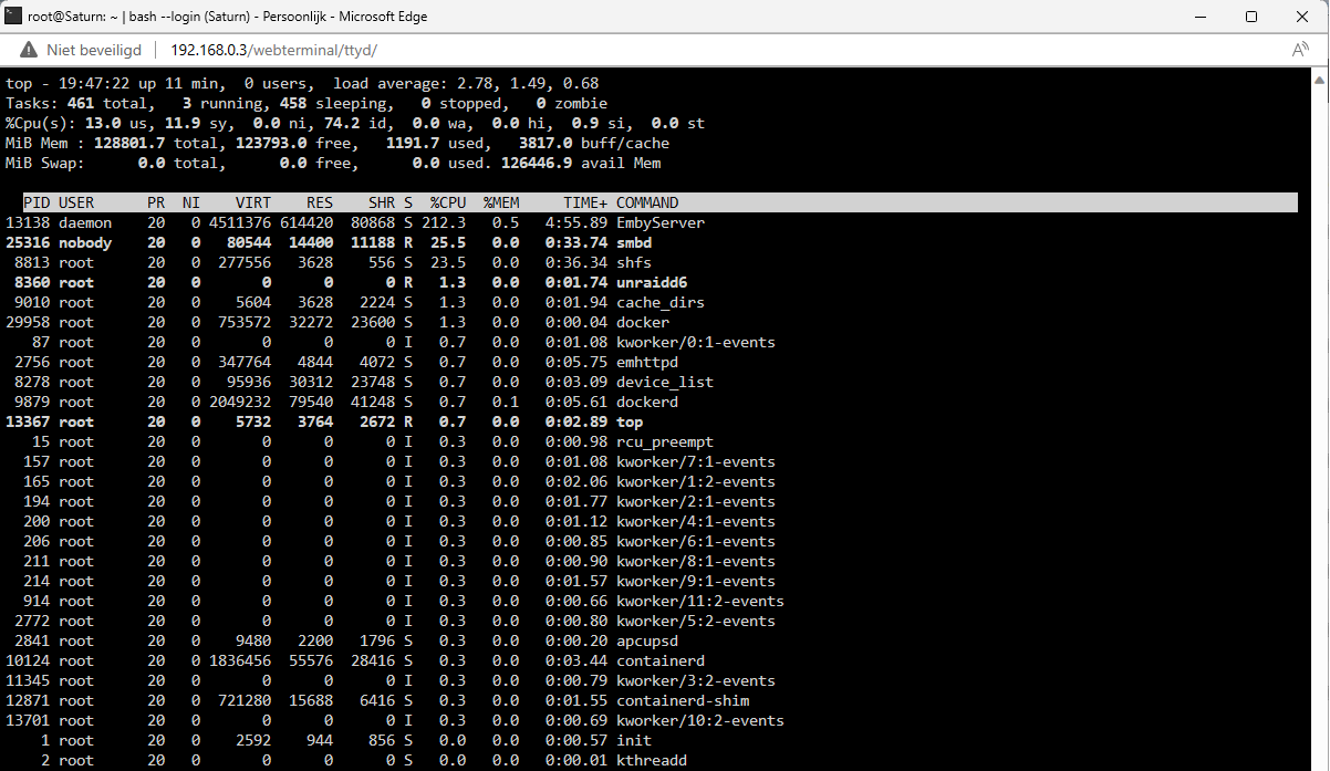

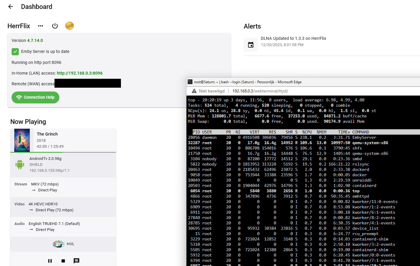

Q-Droid 1002 Posted January 4, 2024 Posted January 4, 2024 Cool, more info. Thx. I'll start by stating that with a 12-thread CPU numbers in top will look inflated unless you turn off Irix mode (shift-i) but that's okay. In this case Emby is still tying up 2+ threads for direct play and that's too much. Now, your box seems to have a lot of overhead and that could be affecting things all around. I see what I think are at least 2(?) VMs (qemu-system-x86) that are somewhat busy. Are these associated with Emby in any way? Then there is rslsync and smbd doing something, not terribly busy. But the shfs process looks busier than you might expect. All of these are tied to I/O operations/services. Is this a steady state? My limited understanding of shfs is that it's FUSE based and for user shares and file caching but I have no idea if it can be tuned or how. If Emby is reading/writing to the same areas and having to go through these services I wonder if that also skews the stats. Concurrency and contention can make things worse. What jumps out the most is seeing that CPU usage overall (total) for system operations is over 28% while user operations are 24%, a bit lopsided. I would follow the advice from @rbjtech and try to isolate Emby and go back to basics. See if you can play media from a storage device/volume/location that is not managed or used by smbd, rslsync and shfs. Maybe stop the VMs temporarily. Bring things back in one-by-one and hopefully that will help identify what makes the load shoot up. On a bare metal box and even in Docker direct playback should use very little resources. But you have a few layers and side things possibly contributing to the load and maybe amplifying it. 1
G4n0nD0rf 6 Posted January 5, 2024 Author Posted January 5, 2024 I was able to improve performance of the qemu-system-x86 and shfs processes, but it doesn't seem to make any difference. I've also tested Emby playing the same movie without any other docker or VM running. Results stay the same though. System is completely idle when no movie is running with processes only using a few % of cpu time max. With the movie playing, EmbyServer goes over 200% and smbd and shfs also come up to about 25%, which seems normal considering the file is actually hosted by the Unraid server. Playback still hangs very often. Again with allowing EmbyServer to use only one thread it's %cpu stays under 100% and playback is way better, but not perfect. Very strange. Smbd and shfs stays the same.
