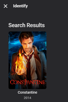

Redbeard 1 Posted March 8, 2024 Posted March 8, 2024 I'm having almost the same problem, the difference being that none of my TV shows identify. My folder structure is the same as show in the link Chillout posted: "\TV\Constantine (2014)\Season 01\S01xE01 - Non Est Asylum.mkv", the media type is TV Shows. Nothing auto identifies and if I try to do it manually, for example entering the imdb id, it ALWAYS comes up "No items matching your search criteria were found.". Any idea why? Side note, I have no trouble identifying Movies.

Redbeard 1 Posted March 8, 2024 Posted March 8, 2024 4 minutes ago, Luke said: Hi, try identifying with the tvdb id instead. Thanks, I checked tvdb and the Constantine Series id is 273690. I entered that into the TheTVDB Id: box in the Identify dialog and I'm still getting "No items matching your search criteria were found.". Also, that response is instantaneous, like it's not actually checking the internet at all.
Happy2Play 9799 Posted March 8, 2024 Posted March 8, 2024 1 hour ago, Redbeard said: Thanks, I checked tvdb and the Constantine Series id is 273690. I entered that into the TheTVDB Id: box in the Identify dialog and I'm still getting "No items matching your search criteria were found.". Also, that response is instantaneous, like it's not actually checking the internet at all. Can you post the server log but sounds like your setup is not communicating with provider sites. 2024-03-08 14:40:25.853 Info Server: http/1.1 POST http://localhost:8091/emby/Items/RemoteSearch/Series?X-Emby-Client=Emby Web&X-Emby-Device-Name=Microsoft Edge Windows&X-Emby-Device-Id=6a55307b-98a2-4ac6-a237-45040bf17530&X-Emby-Client-Version=4.8.3.0&X-Emby-Token=a9c7517b3abd4f3a8cafd04a7f09a666&X-Emby-Language=en-us&reqformat=json. UserAgent: Mozilla/5.0 (Windows NT 10.0; Win64; x64) AppleWebKit/537.36 (KHTML, like Gecko) Chrome/123.0.0.0 Safari/537.36 Edg/123.0.0.0 2024-03-08 14:40:25.872 Info HttpClient: POST https://api4.thetvdb.com/v4/login 2024-03-08 14:40:26.023 Info HttpClient: GET https://api4.thetvdb.com/v4/series/273690/extended?meta=translations 2024-03-08 14:40:26.330 Info HttpClient: GET https://api.themoviedb.org/3/find/273690?api_key=apikey&external_source=tvdb_id
