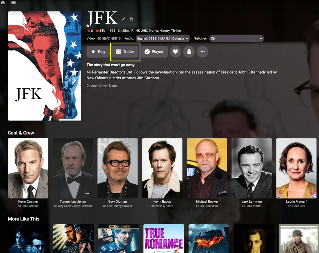

Tremas 205 Posted January 3, 2024 Posted January 3, 2024 @daniel.bmyerThere may be a misunderstanding in what you are expecting to happen. As @crusher11says, trailers are treated differently than other extras. When a trailer is "picked up" by emby, it is not shown under "extras." Instead, there is a "Trailer" button that appears directly next to the play/resume button on the media info screen. Clicking this button plays the local trailer file. If there is more than one trailer file, it will play each in order.
daniel.bmyer 11 Posted January 3, 2024 Author Posted January 3, 2024 I tried that but even though I clicked the Trailer icon, when the video plays, it has a Youtube label across it on the bottom of the screen. When I play the video from my hard drive, it doesn't have a YouTube label. I assume this means it's not playing the local file...or is it? Let me see if they are even the the same file
Tremas 205 Posted January 3, 2024 Posted January 3, 2024 If you have an NFO file that includes a link to an online trailer, some clients will attempt to play that. Roku, for example, is only able to play local trailers. I'm not sure how it works for android, but the NFO link is most likely what is happening. I would try deleting any "<trailer></trailer>" tags in the NFO and see if that works.
daniel.bmyer 11 Posted January 3, 2024 Author Posted January 3, 2024 Ok that seems to be working. Just one is not and I think it's an issue with that specific file. Thanks for the assist 1
